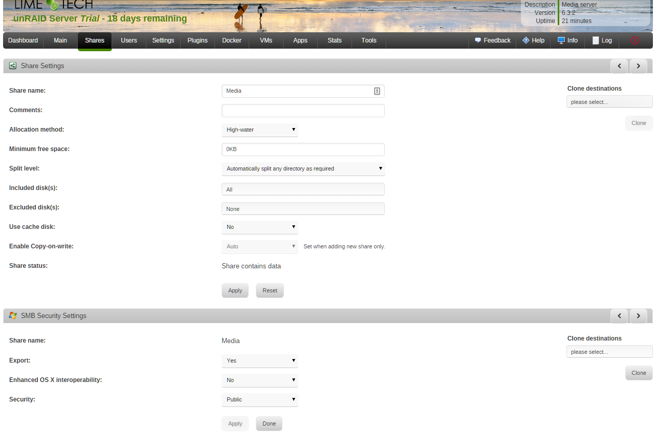

I just got my UnRAID box going and starting copying some files. After about 500GB it said "Not Enough Free Space" on Windows. I have 5.48TB Free! I have included a screenshot of my share if that helps.

I look at your minimum free space of "0" with some suspicion. Often running out of space with a copy is because a of your share settings. But with high water mark it should be ok. But for troubleshooting, I'd likely try raising the minimum free to something more reasonable based on your file sizes and see if the problem goes away.
I raised it to 2GB and same issue.
