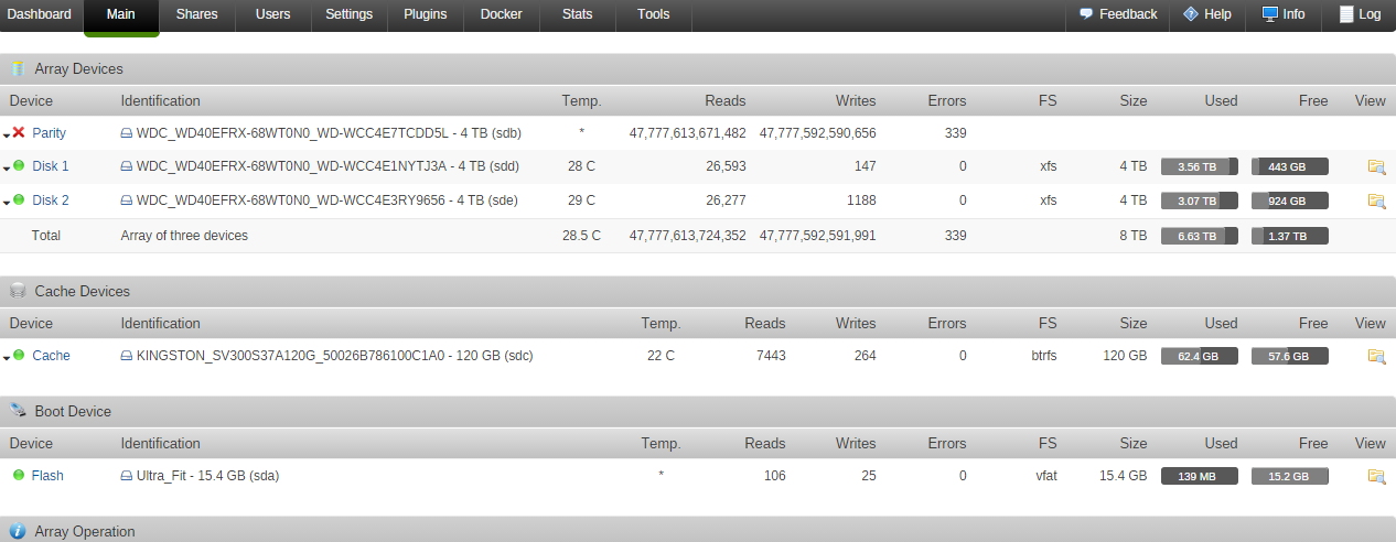

Parity Disk write errors
SMART look good, always post the complete diagnostics.
Looks more like a cable problem, check/replace cables, you can also use a different SATA port if you want and try the parity sync again, if it still fails run an extended SMART test on that disk.
Thank you,
I tried the extended SMART test after i posted and it stops and the disk is not visible anymore in Unraid.
I wil try recplacing cables.
I put the disk in 5 different slots, It was either not visible on startup or not visible after a SMART short self-test.
I used disk 1 one with the same cables and no problems.
Any more ideas?
Get a new disk?
