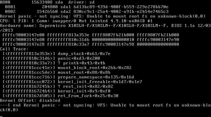

Hi I have installed a APC UPS and set the parameters etc, I have had this issue prior to the install of the UPS. So if I shut down my UnRaid server stopping everything correctly and then hitting stop and then power off I get this when I power it back on, See screen shot. I have to use the ipmi and soft reset it again to get it to load correctly and sometimes 1-2 times.
Any ideas

Ok so I am still having this Issue but it only happens when I try boot into UnRaid with the GUI, if I let it self select UnRaid its all ok but if I have to select the GUI if fails and I get the above on the Screen

Just a quick look at the diagnostics, but nothing stood out as a problem.  The one thing I can recommend is to check for an upgrade of your motherboard BIOS (from 2013), sometimes helps.
