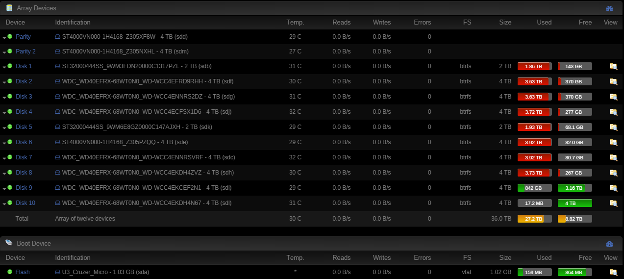

In the GUI I see all my drives.  In the CLI, df is missing disk 3.  Screenshots and a new diagnostic attached.  Would it be easier for me to start converting to and migrating the data to xfs in a rolling fashion starting with Disk 10?
GUI:
CLI (Missing /dev/md2 aka /mnt/disk3):

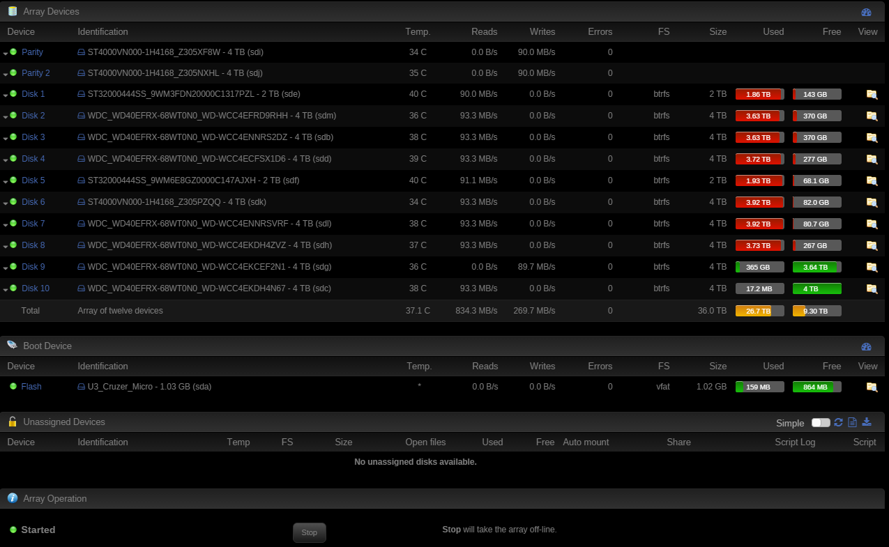

I moved a 12G file as you requested from another disk to disk2, and in the GUI, Drive 2 and Drive 3 are showing the same information, and free space has gone down by 10GB.
After running the test you mentioned, I thought earlier I had accessed files on Disk3.  They are really on Disk2.  When I do a find in the cli, it's the same files.
An example, a file from my synology backup share:

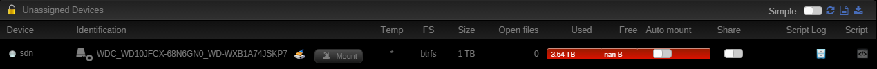

more oddity...  lsblk shows the disk at 4TB however btrfs thinks it's 931GB
lsblk output for disk 3:
sdg      8:96   0   3.7T  0 disk
└─sdg1   8:97   0   3.7T  0 part
btrfs fi show for /dev/sdg1:
 btrfs fi show /dev/sdg1
Label: none  uuid: 25d79d48-80f9-4b90-8091-515048193568
        Total devices 1 FS bytes used 384.00KiB
        devid    1 size 931.51GiB used 1.02GiB path /dev/sdg1
And unassigned devices shows:
It's really jacked up...
Edited by ajeffco
