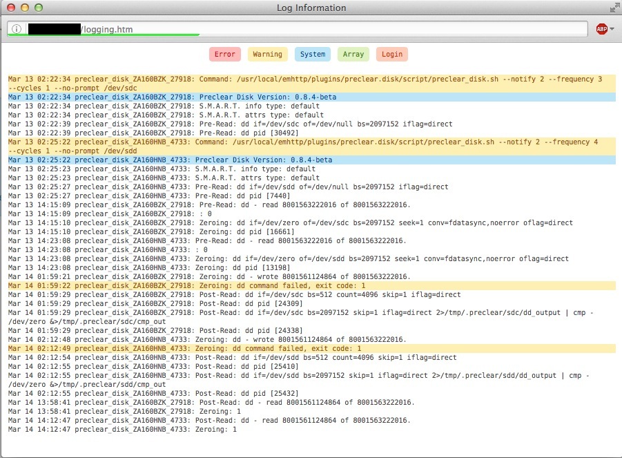

However, the actual log has the warning
   "Zeroing: dd command failed, exit code: 1"
on  the dd command in the zeroing phase, from both  drives at the exact same location before the location where the pre-read ended. The post-read pass also stopped at the same location.
   Searching the forum, I've seen a couple of threads with the same error message, but it doesn't seem to be the same behavior: In those cases, the pre-clear stopped on the error, which it didn't in my case, or it was a HW issue (cable / bad SATA port) -- the fact that in my case  the error happened at the exact same disk location for both disks seems to rule that out.
Anything to worry about here? I'd rather not redoing the whole pre-clear unless really necessary.
The commands look completely correct, and the numbers look correct too.  Except for the first block, the entire drive was zeroed then post-read.  I see no reason for an error.  The only thing I can think of is that the zeroing command does not have an end, it just says keep zeroing until you can't, and that may mean it keeps zeroing blocks until it can't, which results in an error, which therefore is expected and can be ignored.
I think you can safely ignore that line in the log, as it did complete all of the zeroing and re-reading.

RobJ, what concerns me is that the pre- and post-read passes cover a different number of blocks.
Even if dd doesn't have an end specified when zeroing, I'd expect the pre-read pass to behave the same, and to have stopped at the same location.
No, they are exactly correct, if you look closely at the commands.  In the pre-read, he reads the entire disk, including the first block.  In the zeroing and post-read, he skips the first block, then zeroes and tests the rest.  He's using a block size of 2MB (bs=2097152), and what is zeroed and post-read is exactly the entire disk minus one block.  You can subtract the 2 numbers and see.  To skip the first block, he uses skip=1 on the read and seek=1 on the write.  He must be handling the zeroing and signature writing in that first 2MB in another code section that isn't logged above.
I don't know why, but apparently the read to the end stops without reporting an error, whereas the write does report an error, when it cannot write any more.
