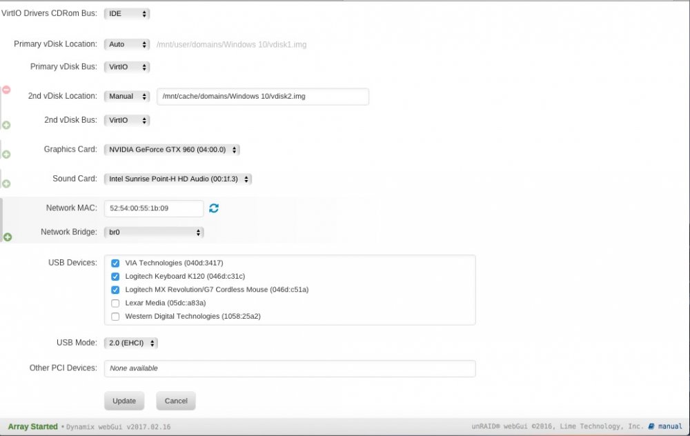

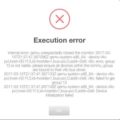

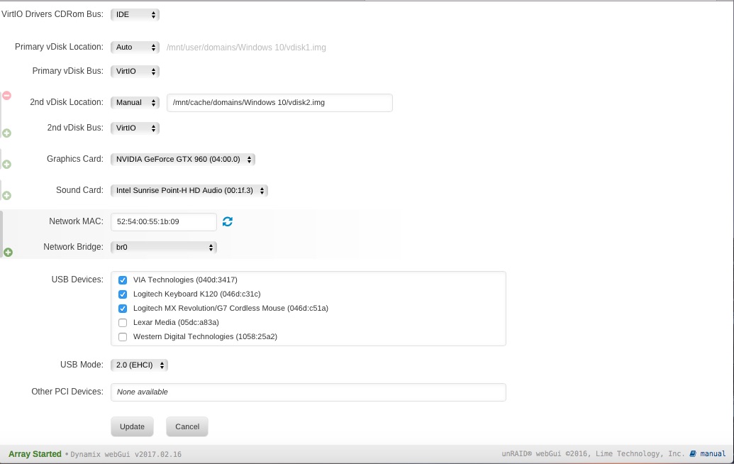

March 15, 20179 yr Author I believe I have explained well my problem: my VM passes the USB also, mouse, keyboard and external hard drive work fine! In fact it also works the USB audio device Astro A40, however, he feels distorted and noisy .. I also have another question: given that use passthrough GPU, I can not use the sound card integrated into the motherboard .. How can I do? Turns out this error (see screenshot) Edited March 15, 20179 yr by steppi
March 15, 20179 yr Passing through a pcie USB card or a USB controller (which I linked you the guide to) will solve your audio problems with your headset. You could try to set USB mode to 3.0 and see if the audio gets better. The reason why you can't pass through the onboard audio is that there are other devices in the iommu group.
