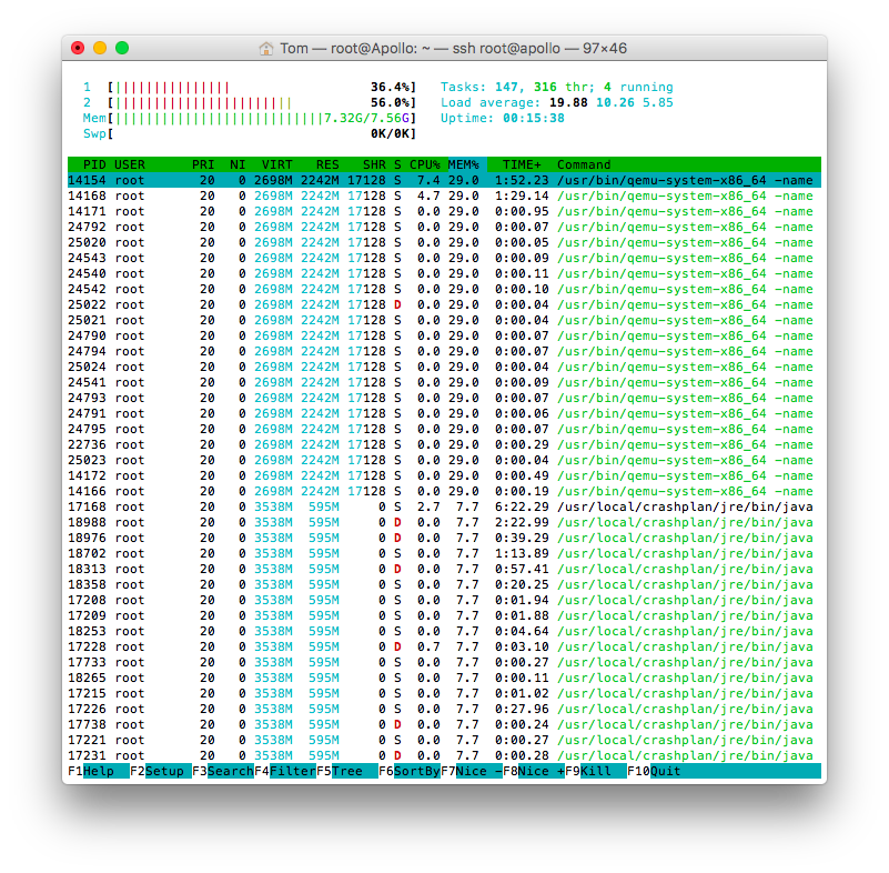

  • I noticed last night before I went to bed that RAM usage was 88 %, but in the diagnostics its not that high.

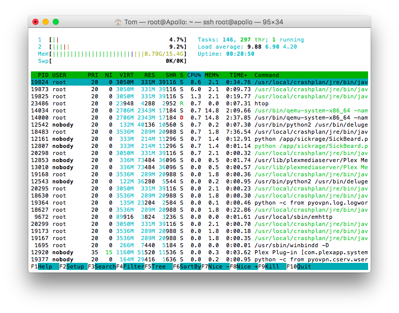

Ok, so I can get this to happen at will now. Basically just run the dockers above and run rsync. So I set up all my logs and let rip!
I took the screenshot of htop 28 seconds before it crashed. The memory usage was creeping up at a rate of about 0.01 GB per 10 seconds however it didn't actually get to 100 %.
The syslog tail captured everything in it's gory detail. I have absolutely no idea what it is saying, but it doesn't look good. Some sort of kernel panic I assume? Everything was running fine until Mar 24 08:43:29.
