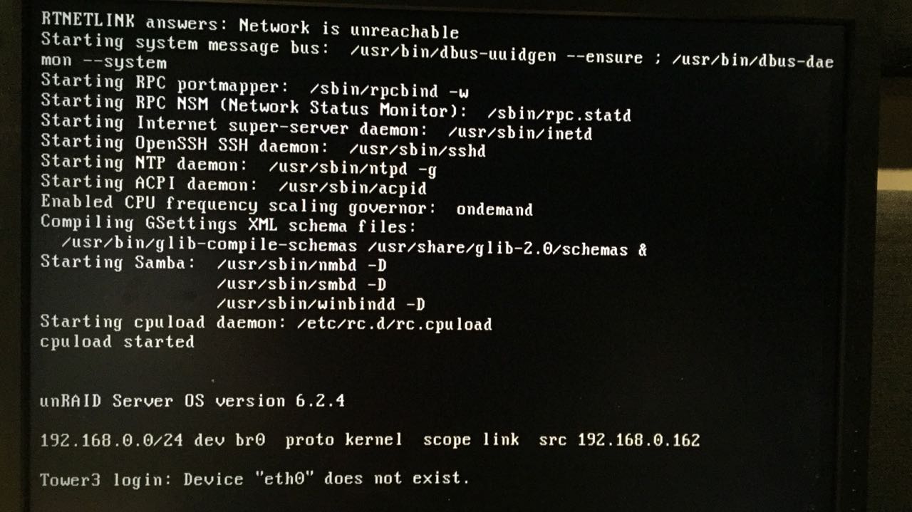

Hello All,
            I am setting up my 6th unraid server and for the first time I am running into a problems seeing the server on the network. All of my previous servers have been with Supermicro servers, this last one I decided to go with and Asus Maximus IX Formula board. I connected a monitor to the server to see what was going on and the last message I can see is  Device "eth0" does not exist. I am assuming this is referring to the nic on the board. I proceeded to pop in an SSD drive and install windows 10 to see if I could access the internet through the OS just to confirm the NIC was working fine, everything works perfectly. I take the SSD Drive out, boot from the USB and I keep getting the same message, I have attached a couple of screen shots, I hope one of the more experienced people on this forum might be able to shed some light as to what is happening.
Thanks in advance.
Please see Need help? Read me first!, and attach the diagnostics zip.
I suspect it might be an unsupported networking chipset.  We can see if that's true in the diagnostics.
