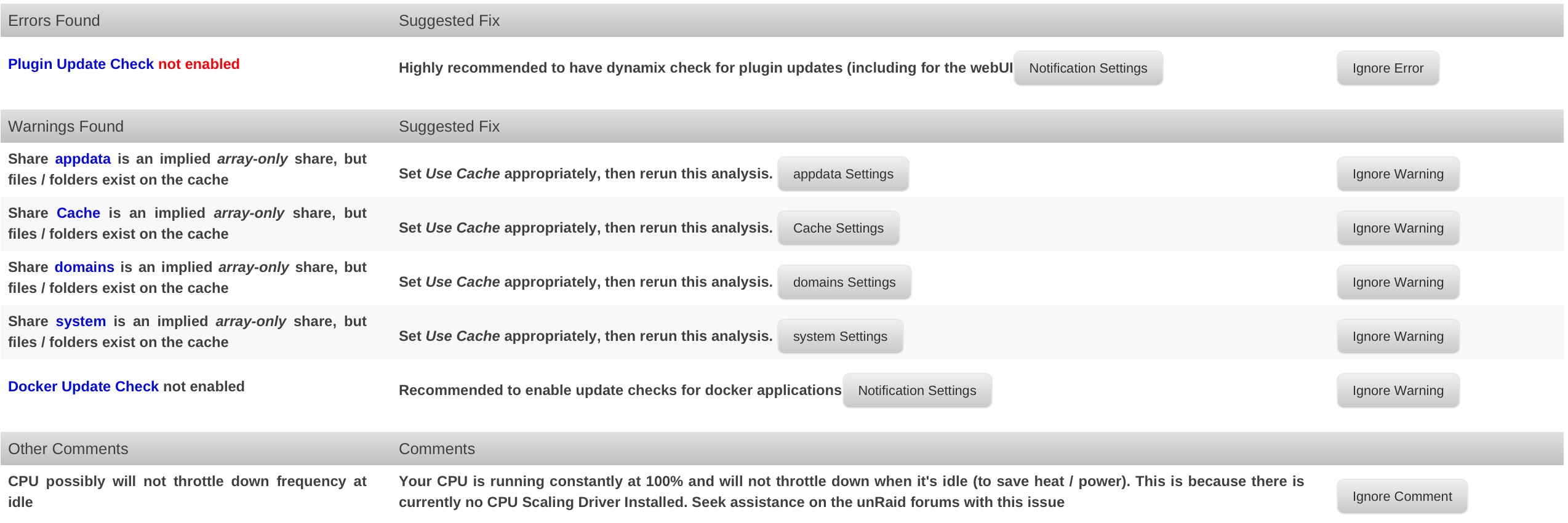

Hi Squid- have done as you recommended - Fix Common Problems has found a few errors?! Any suggestions - they all seem to be the same error mainly!
Those are all nothing related to your situation.
