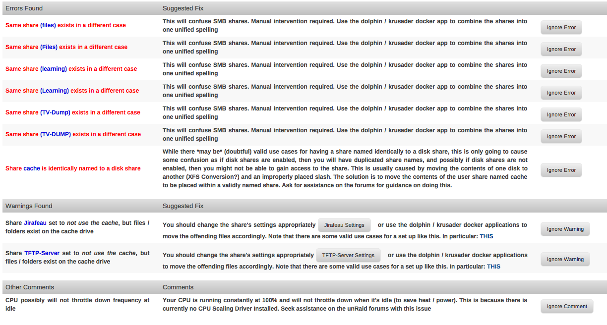

So it looks like these may be the problems. To bad the interface doesn't disallow or alert the user when trying to create a share with the same spelling but different case. I am not sure how some of those happened.
I'll work on these and see what happens.
Many ways to create folders.  The GUI is only one of them.  FWIW, the way that most users get into this situation is via misconfigured applications creating them themselves.  (And if that is the case then its going to happen again -> Check all of your host mappings for your docker apps)
The GUI will prevent you creating a share named "cache".  This is going to be caused by a host mapping of something like /mnt/user/cache/appdata/... instead of /mnt/cache/appdata....
@trurl will recommend using midnight commander (mc).  As you can tell from the warnings, I recommend dolphin / krusader.  Dolphin is the easier one to use as the template within CA is good to go with no modifications needed (except maybe changing the port number if it conflicts).  You are completely unable to do this over the network via SMB (Windows)
None of these problems however should cause the system to stop responding....  But it does confuse the hell out of SMB so who knows.
This is Linux, those are completely allowable.  It's only a problem when you interface to Windows stations, where it's not allowable.
Actually, I personally think it's a problem everywhere, a huge source of confusion!  But Linux allows it.
Edited by RobJ
add note
You are right. I was just thinking for users that may have this same issue unRAID can warn you have the same things created but in different case.
