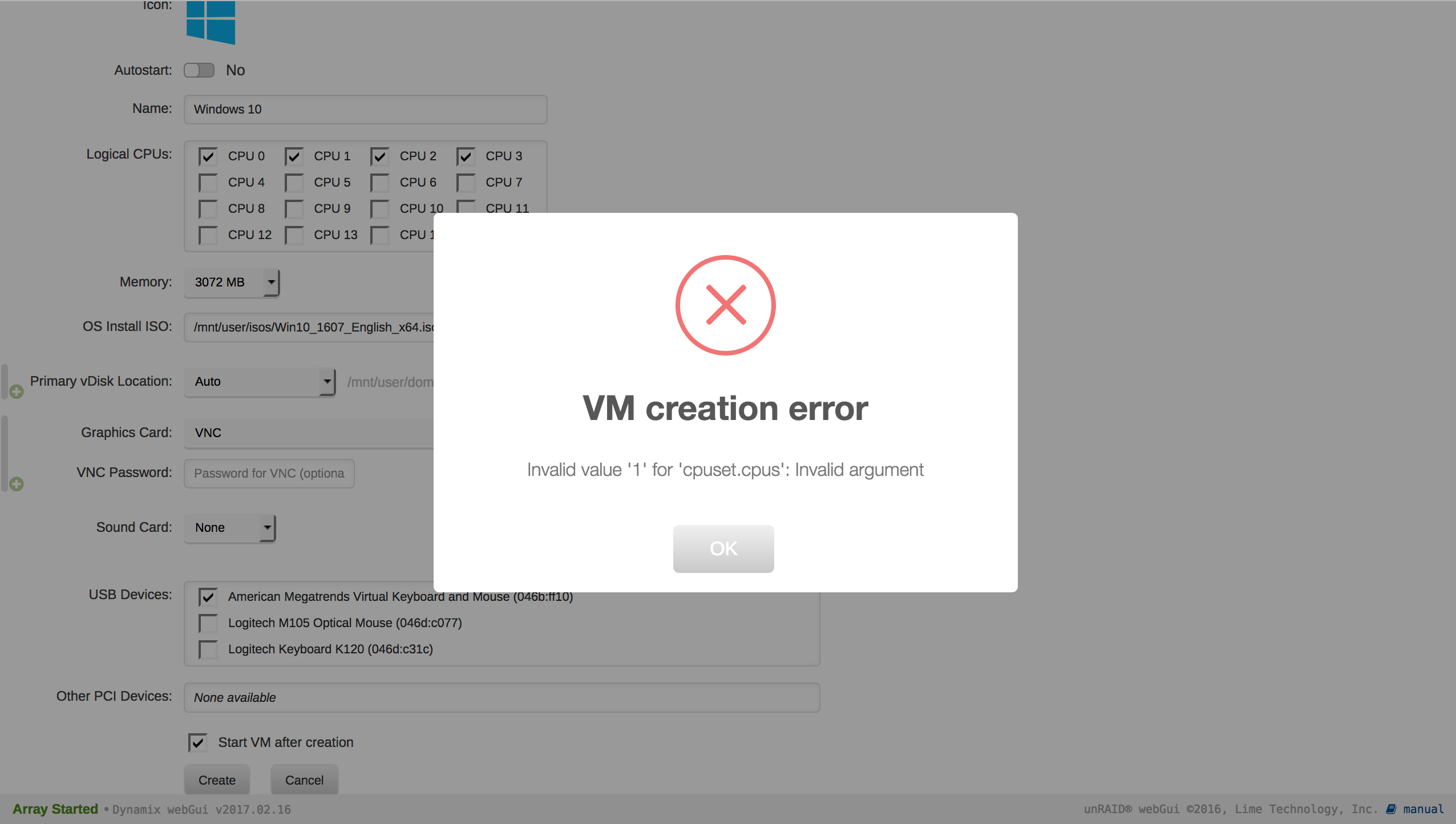

VM creation error Invalid value '1' for 'cpuset.cpus': Invalid argument
I'm trying to create Windows 10 VM on Unraid 6 but when I select any other cpu then "cpu 0" or any other cpu with" cpu 0" I get "VM creation error Invalid value '1' for 'cpuset.cpus': Invalid argument"
I tried creating other OS but I'm see same problem.
I can run VM on one "cpu0" but it's extremely slow.
I'm using xion

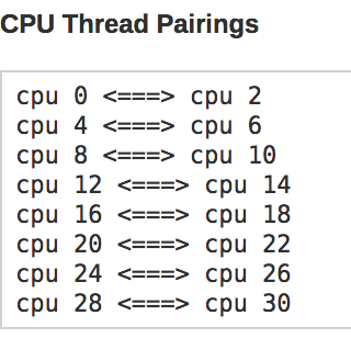

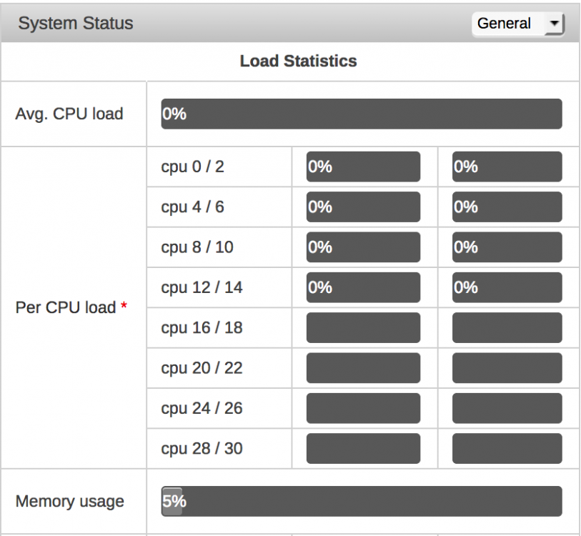

Having the same exact issue. Anyone have any idea? My system is a Proliant ML350 G6 with two E5530 cpus.
I might be missing something here as I don't use a Intel platform at the moment. But shouldn't the CPU cores be listed from 0 onwards and not skipping numbers out like 1,3,5 etc.
Have you tried assigning only CPU 0 and 2 to a VM and see it it starts?
I would expect the Unraid UI and the VM Manager UI to match in terms of CPU cores numbers.
Selecting 0 and 2 works wonders. However, it's pretty weird that 1, 3 and so on are listed but unusable. Tried google without any luck.
I think this is bug or an issue from the underlying OS rather than Unraid itself.
I've seen some other threads on cpu assignments or pairings been messed up, maybe this is related. But I believe your issue is that OS is presenting your 16 cores incorrectly to Unraid and causing a mismatch when you attempt to use the VM Manager UI.
In other words, the numbers on the dashboard have to match the numbers on the VM Manager UI.
You do not have a CPU core 1,3,5,7 etc etc available to assign. In the current state you could only assign 0,2 - 4,6 - 8,10 - 12,14 to a VM.
