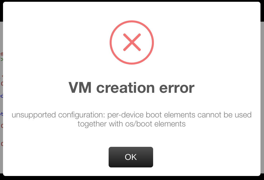

@gridrunner
Hello have attempted your method to pass-through the NVME drive but get the following error when I attempt to update the XML file.
New VM never been booted.
It seems that the VM template does not like the reference to "<boot dev='hd'/>"
This is on UNRAID 6.3.2
Any ideas?

2 hours ago, Enver said:
@gridrunner
Any ideas?
2
 Yes you will have more than one boot in your xml thats why you are getting that error.
 You will have something like
<os>
    <type arch='x86_64' machine='pc-i440fx-2.7'>hvm</type>
    <nvram>/etc/libvirt/qemu/nvram/0a0c0f94-12fc-d6f4-f5ad-3f141f92f861_VARS-pure-efi.fd</nvram>
    <boot dev='hd'/>
  </os>
But you will also have a boot order in the xml somewhere else.
<boot order='1'/>
You can only use one or the other so you will need to remove one from the xml
Any ideas?
just remove this part:
<boot dev='hd'/>
I tend to just set the boot device order in the actual VM in the OVMF bios (press F2 on boot i think?). There you can re-order boot devices as you would on a normal full fat PC BIOS.
As far as im aware, you cant set the boot order in the XML when one of your boot devices is a passed through PCIe device, like you can when you use VIRTIO disks.
EDIT: post your VMs XML
Edited by billington.mark
