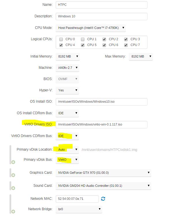

Settings look fine except that the VirtIO drivers you are using might be a little out of date.  You can download new drivers directly from the webGui under the Settings > VM Manager tab.  Simply select the newest version from the drop down and then click the download button.  You will then need to edit your VM to specify the use of that new VirtIO ISO and then once booted into Windows, go to each of the existing VirtIO devices in device manager, right click, then check for updates.  Then specific the VirtIO ISO path (typically d:\ or e:\) as the path and let it auto-find the drivers.  This may improve things a bit.
Thanks John
I went ahead and rebuilt the vm with lastest stable   virtio-win-0.1.126-2.iso. I also downloaded the latest win10.iso form MS. Everything is working perfect now. dident need to select only core 0 for the updates to work. runs fast and stable. here are the settings i used hopefully they are okay.
