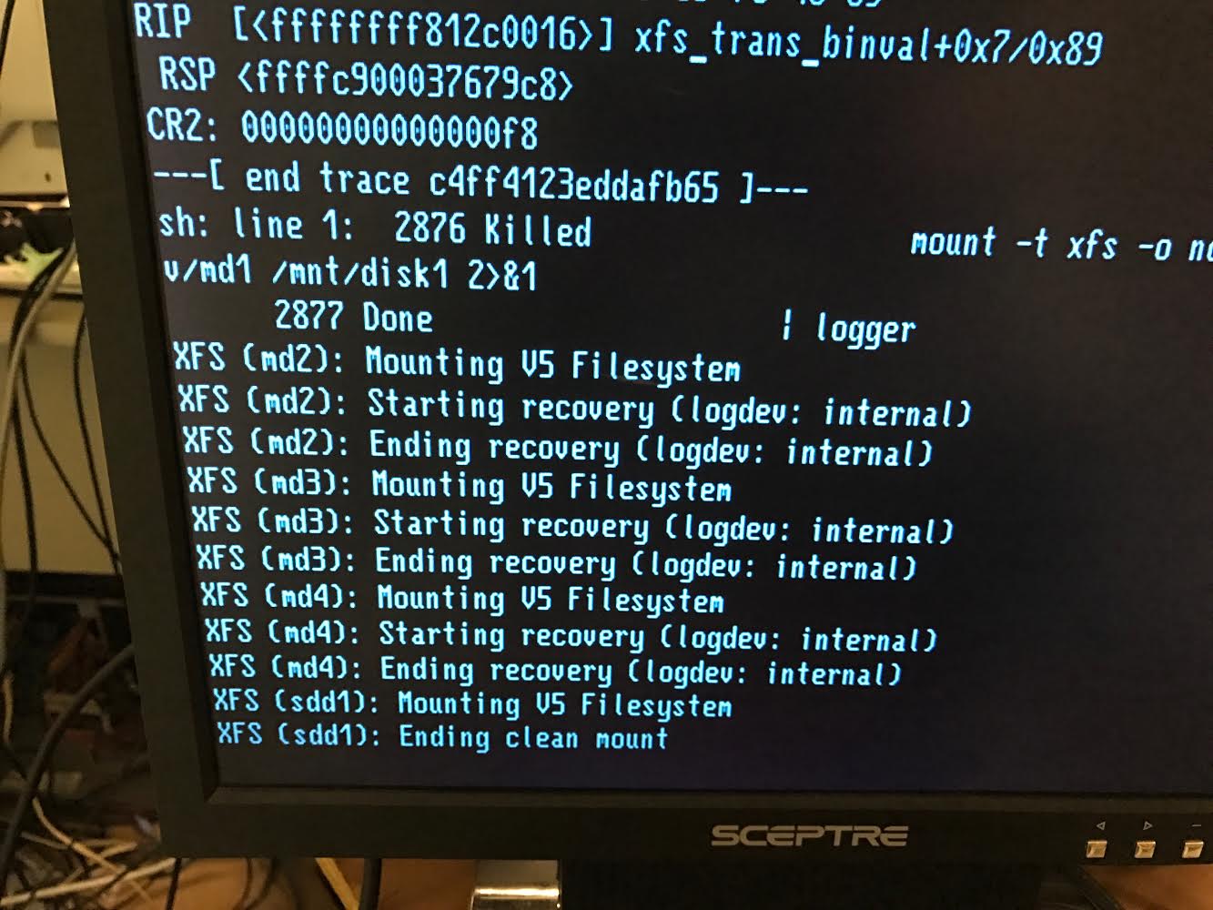

Yesterday, I noticed that 3 of my 4 data drives were overheating due to constant a constant read from a program running across the network. I stopped the program causing the reads. Shortly after I did the unraid became unresponsive, the WebGUI wouldn't load and I could ping the tower but that's it. I was offsite so I couldn't physically check the console or restart the machine.
This morning I come in and forced it to restart, now it's not mounting any of the drives except for what seems to be the parity. Starting the array causes the WebGUI to freeze, and I attached a picture of the what the console says shortly after.
This would imply poor cooling, no disk went above 53C, so a little on the high side but far from critical.
Is the server having unclean shutdowns due to power cuts or crashing? That's the number one reason for filesystem corruption, if it's not there could be a hardware issue, like bad RAM.
No unclean shutdowns that I know of, if it has to be shutdown I normally initiate it through the webgui. But I will check the ram as I didn't know that it could cause filesystem corruption.

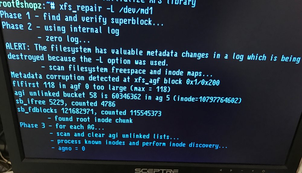

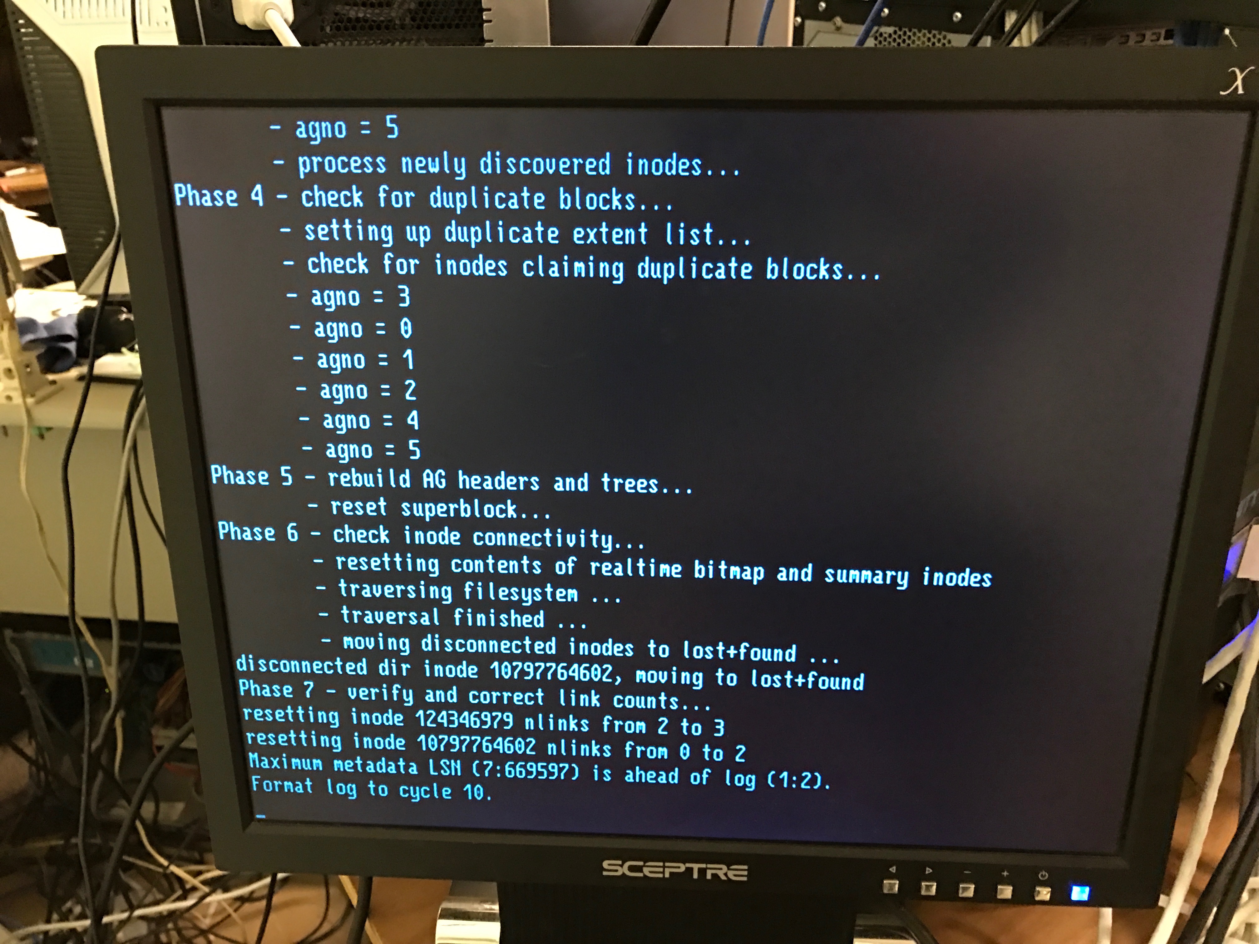

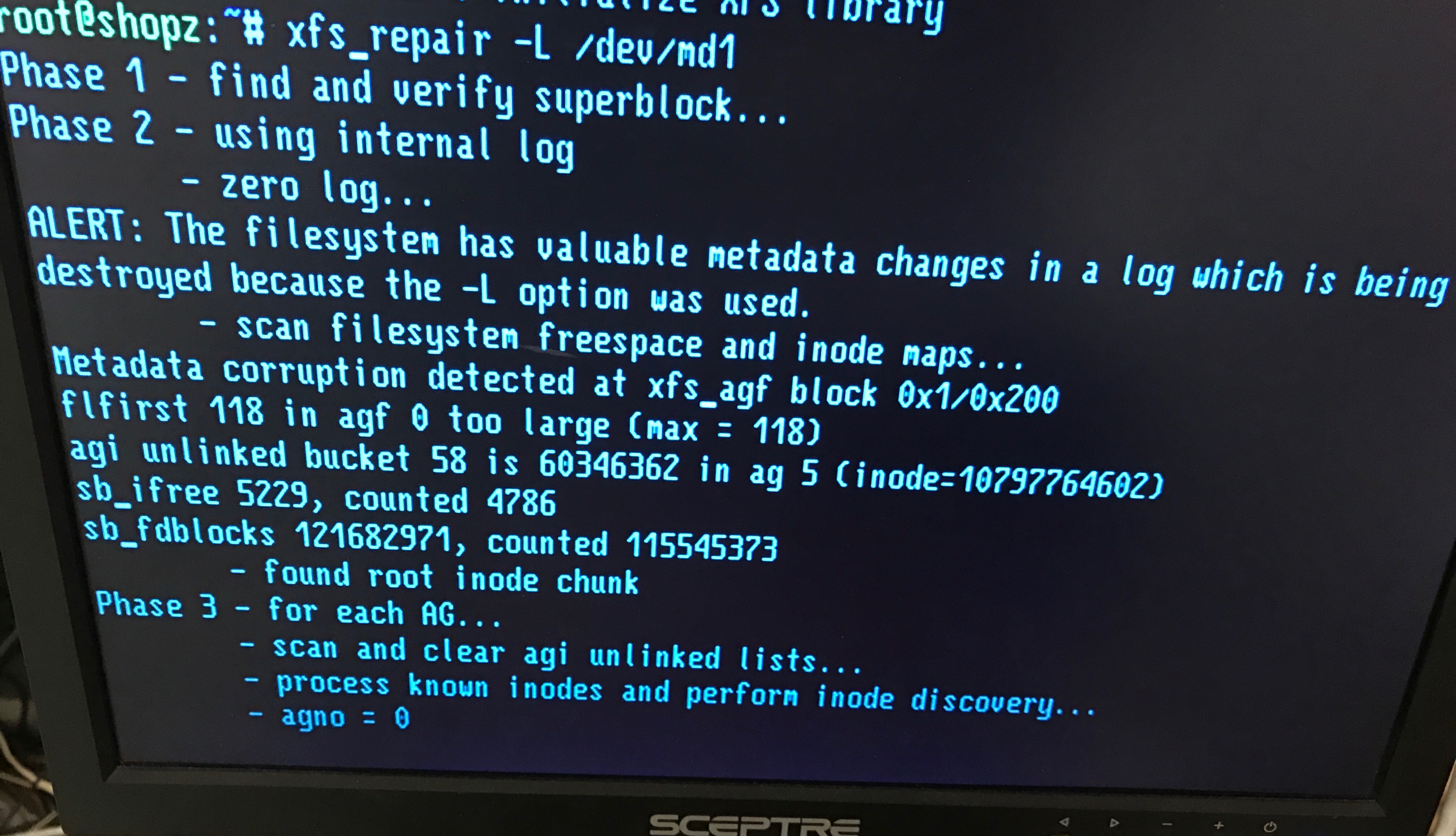

End result of the xfs_repair.
I stopped the array, rebooted the tower, and successfully started the array!
Thank you for helping me to resolve the problem!
Obviously bad RAM can corrupt anything and everything, since all data goes through it.
Also wasn't this an unclean shutdown?
It came backup like it was a clean one. I went through the console and used the poweroff command.
If a parity check didn't start it was a clean shutdown, in that case I would run a few Memtest passes.
