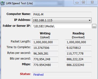

One more thing.  You might want to try LAN Speed Test (google for it) by Totusoft.  It has the advantage that eliminating any overhead introduced by a file manager on the PC end.  After you are sure it works, be sure to use file transfers in the 5GB or larger to eliminate the RAM buffering on the unRAID side.  It also waits for the file to close on the unRAID end before it calculated the transfer speed.  (A lot of file managers use just the time required to finish the transfer to the network without considering any buffering occurring on the other end.)
My write speeds to my Test Server was 67.882,048 MBps (directly to the array using 'reconstruct write') and from the server was 114.819,459 MBps.

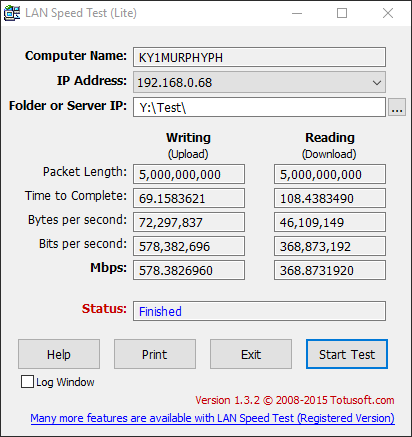

Thanks for the tip... wasn't aware of this program.  The results are writing at 72.25 MB/s and reading at 46 MB/s.
Have you tried another computer for the same tests?  Have you check to see that you have the latest NIC drivers for your laptop?
The reason that I am saying this is there are not many complaints about reading speeds on the forum and I know that I had an issue that I struggled with for a month that I finally determined was caused by the RealTek NIC drivers on THREE computers.  (I am one of those who doesn't update drivers unless I have a problem!)
I also noted that you are using a mapped drive, you might want to check the speed by going directly to the server.  Just use the browse dropdown button on the end of the 'Folder or server IP' line and navigate down the Network icon.  It would be interesting to see if the speed is different.
I did run the tests on three computers with similar results. The interesting thing is that NOT using the mapped drive actually slowed things down a bit, but not by much. I'll keep poking around, but not sure I can figure this one out.
