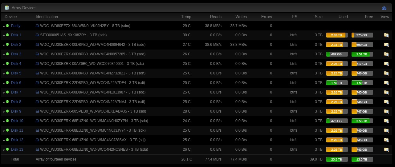

I'm new to unRaid and having moved over from DrivePool, I'm running version 6.3.2, and now my data is on the drives I notice three drives are not been used, SMART says the drives are fine but when I try to move data to any of the three drives via windows 10 it states the drives are full.
Please see the attached picture, Whats wrong and how do I fix it.

Post your diagnostics:
Hmmm ... your smart report looks fine. But did you read down to line 6 in the link that Johnnie posted?
If you read there you will see how to pull the diagnostics file.

There's something wrong in the diags that I didn't check before, df output:
Filesystem      Size  Used Avail Use% Mounted on
rootfs          7.5G  390M  7.1G   6% /
tmpfs           7.5G  300K  7.5G   1% /run
devtmpfs        7.5G     0  7.5G   0% /dev
cgroup_root     7.5G     0  7.5G   0% /sys/fs/cgroup
tmpfs           128M  2.5M  126M   2% /var/log
/dev/sda1        30G  289M   30G   1% /boot
/dev/md1        2.8T  2.4T  349G  88% /mnt/disk1
/dev/md2        2.8T  2.4T  347G  88% /mnt/disk2
/dev/md3        2.8T  454G     0 100% /mnt/disk3
/dev/md4        2.8T  2.2T  625G  78% /mnt/disk4
/dev/md5        2.8T  2.1T  695G  76% /mnt/disk5
/dev/md6        2.8T  1.4T     0 100% /mnt/disk6
/dev/md7        2.8T  2.1T  694G  76% /mnt/disk7
/dev/md8        2.8T  2.1T  695G  76% /mnt/disk8
/dev/md9        2.8T  2.1T  695G  76% /mnt/disk9
/dev/md10       2.8T  443G     0 100% /mnt/disk10
/dev/md11       2.8T  2.1T  689G  76% /mnt/disk11
/dev/md12       2.8T  2.1T  693G  76% /mnt/disk12
/dev/md13       2.8T  2.1T  691G  76% /mnt/disk13
/dev/sdn1       932G   22G  910G   3% /mnt/cache
shfs             36T   24T  6.1T  80% /mnt/user0
shfs             37T   24T  7.0T  78% /mnt/user
/dev/loop0       20G   20M   18G   1% /var/lib/docker
/dev/loop1      1.0G   17M  905M   2% /etc/libvirt
As you can see df is reporting the 3 problem disks with 0 free space, no idea why but will try to find out.

Didn't have much time but did some searching and didn't found any solutions, also it's not a common problem, unlike the reverse, i.e., btrfs file system reports free space but you can't write anymore due to the deice being fully allocated, in fact only found one person running Mageia with the same issue, but for him it was mostly a cosmetic issue, since the system functions normally despite df reporting the disk full.
With unRAID looks like the webGUI uses btrfs fi show and correctly reports the free space, but when doing a copy using a user share it looks at df for the available space and since it's not correctly reported it errors out.
To fix it you'll probably need to reformat the disk, you can try to resize it first, doubt it will work but it's easy to try, so if you to try it, with the array started type on the console:
