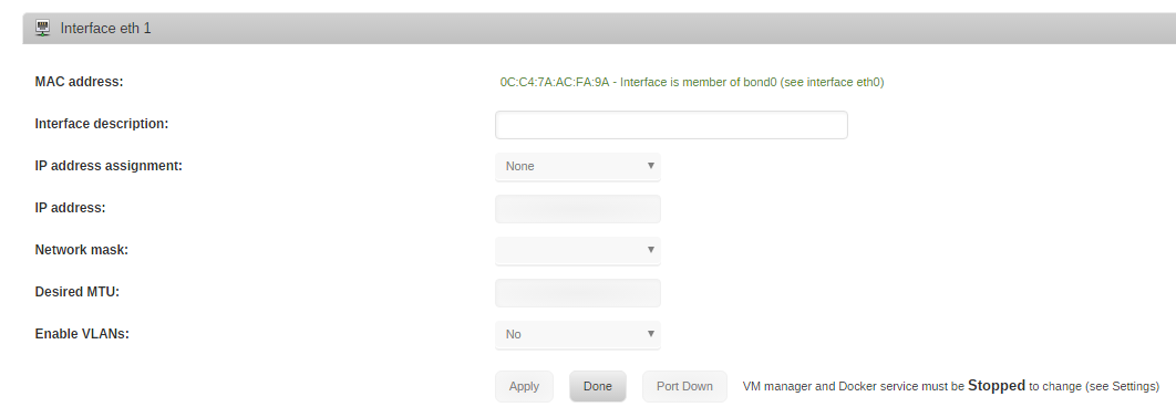

Strange thing is, they both show as Up and that they are a member of the bond, here's eth1 for exampleeth1.thumb.png.f2e29580b22030d37e97cd4823c7435b.png

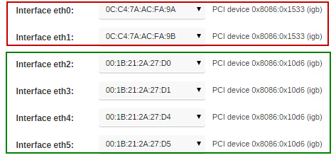

Deleted and rebooted, still same issue. Looks like part of the problem is eth0/eth1 are assigned to the Ethernet ports on my motherboard, which are not connected. Is there a way to disable those and only use PCIe card?
You can select which NIC is eth0 by changing the MAC assignments, use eth0 to eth3 for the Quad NIC, you'll need to reboot to take effect.

Now we're cooking! Looks like that was the issue. I'm guessing this is what was causing my LAG to fail as well. Thanks for the help!
