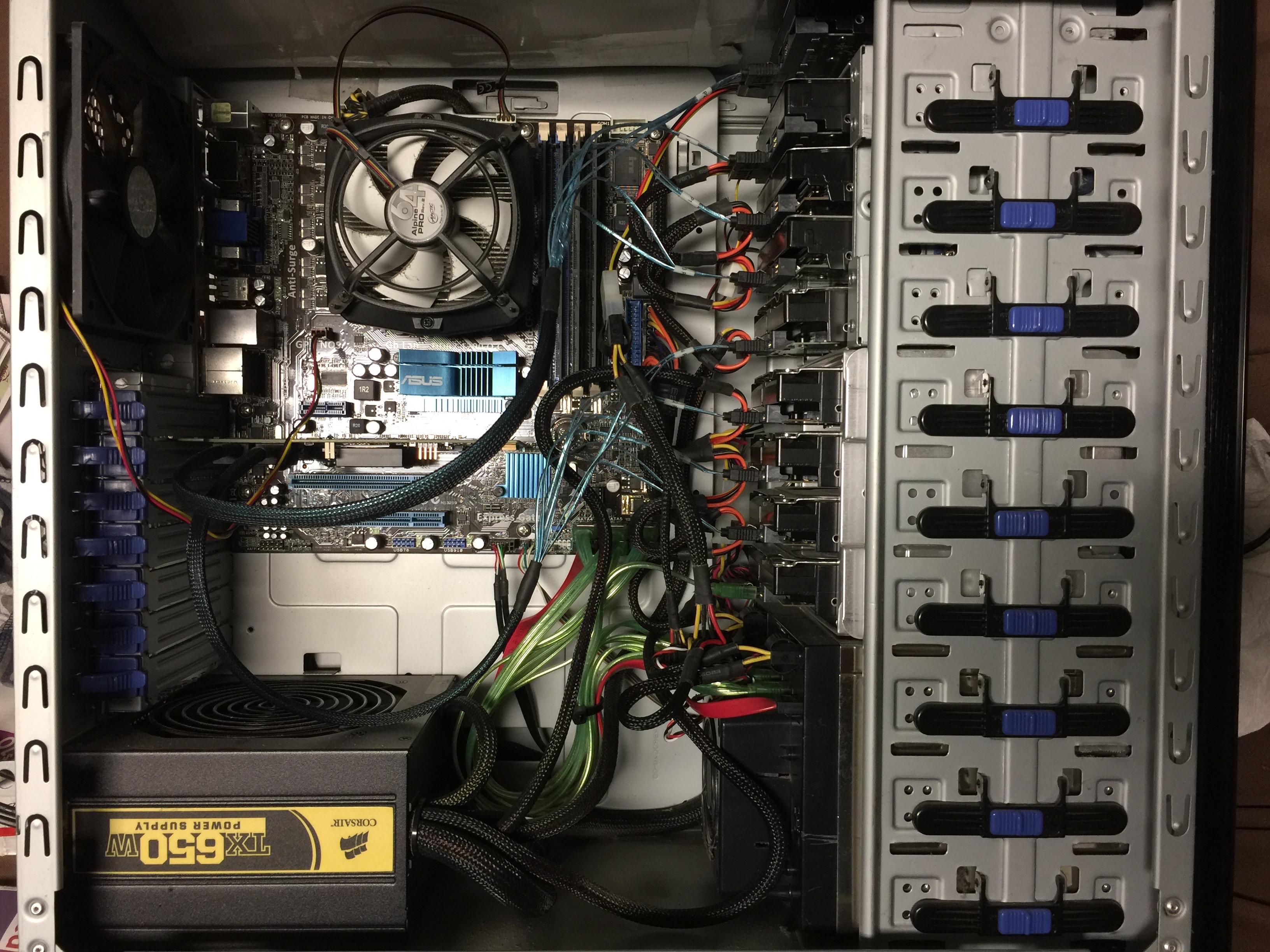

Well thank you guys for all your help. I've upgraded my hard drives 5 or 6 times over the years and have never run into any problems like these. Next time I upgrade a drive I will be a little more careful about my data. Uploaded a pic so you guys can see my setup. Parity is the drive at the very top.
