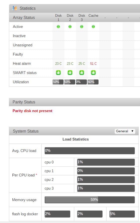

to add some further details i cannot load nextcloud either now, but plex is loading OK. getting gateway timed out of nextcloud, vm has a black screen and SSD is showing heat alarm 50c (cache drive with VM installed on) cpu loads all 0-1% so nothing is going on. getting the impression this is maybe an unraid issue not a VM issue
Quick Edit, the SSD is stone cold just opened the server and its very cool, cooler than the HDD's that are showing 28c
even more edit, the SSD is filling up, was at 20% full an hour ago, 51%full 10 mins ago and now 59% full yet nothing is going in or out the server. and temp is climbing too 51c now yet stone cold to touch

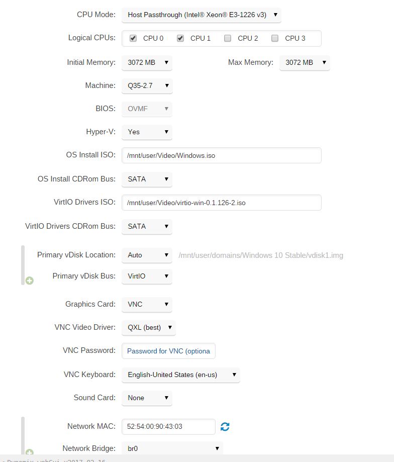

first, try changing the vm machine type to Q35-2.7 (or whatever highest you have)

You should consider reading the cpu pinning thread at the top of this sub forum and look at isolating cores 3,4 from unRaid and try assigning those to the vm only as a place to start. It could improve lag/latency. That combine with changing machine type would be my first next steps.

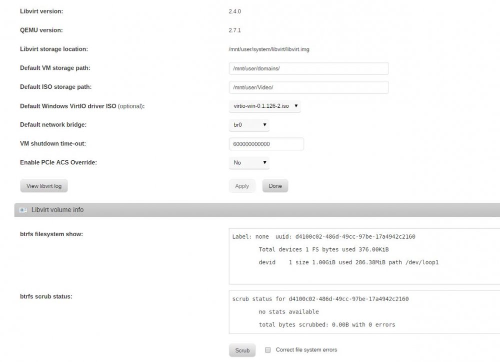

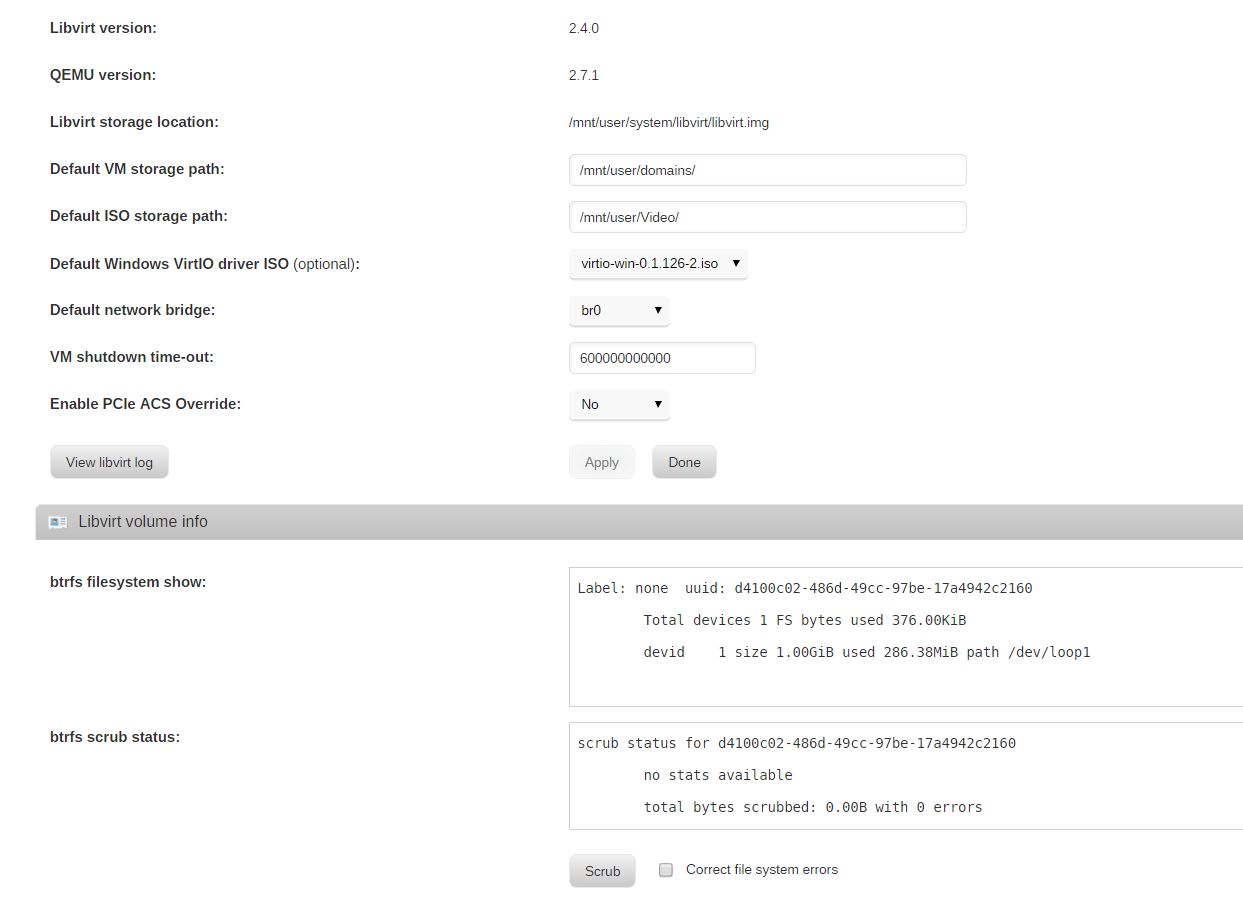

the VM is running on the SSD i will take some screen shots as im a little confused about the " because your domains share is set to "prefer" and the .img file(s) are larger than the available space on the cache drive. Since I can't see the file(s) or their sizes, I can't tell you which exactly. For my domains share, I run it as "only."
am i correct in thinking that primary v disk location should be set to manual and cache selected ?
yes, and change the domain share to only and not prefer.
also, change the vm to cores 2,3 since unRaid likes to use core 0
