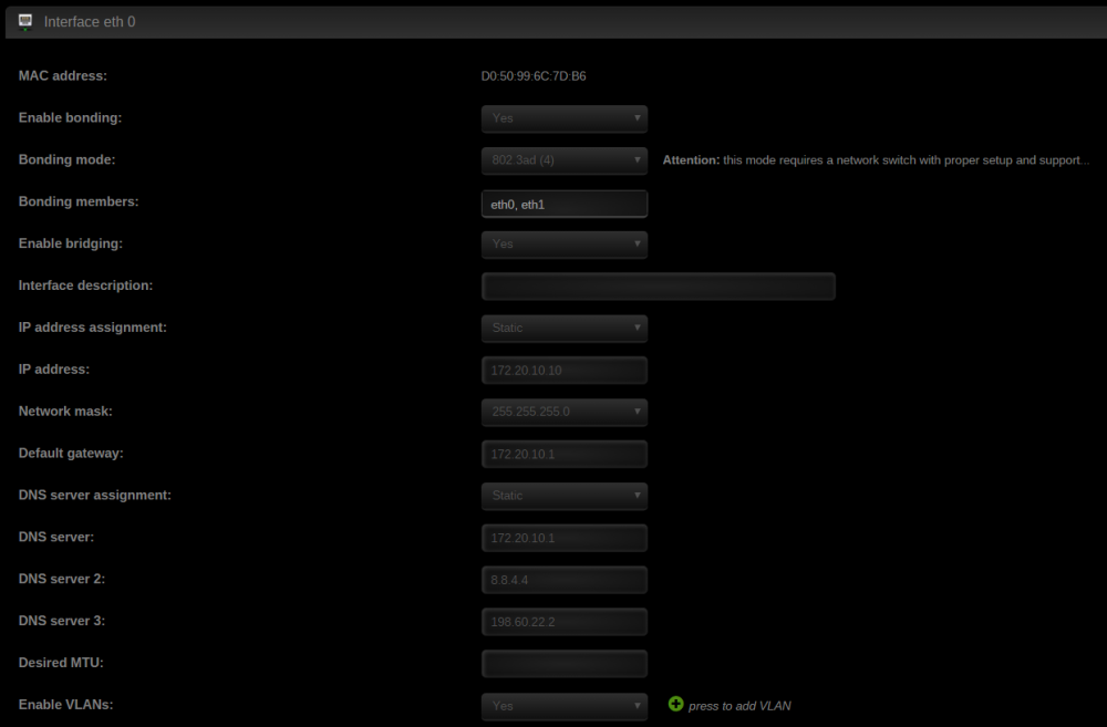

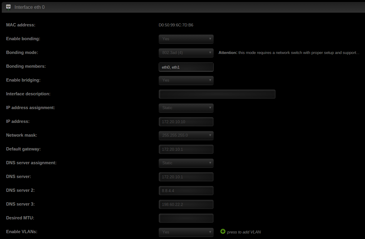

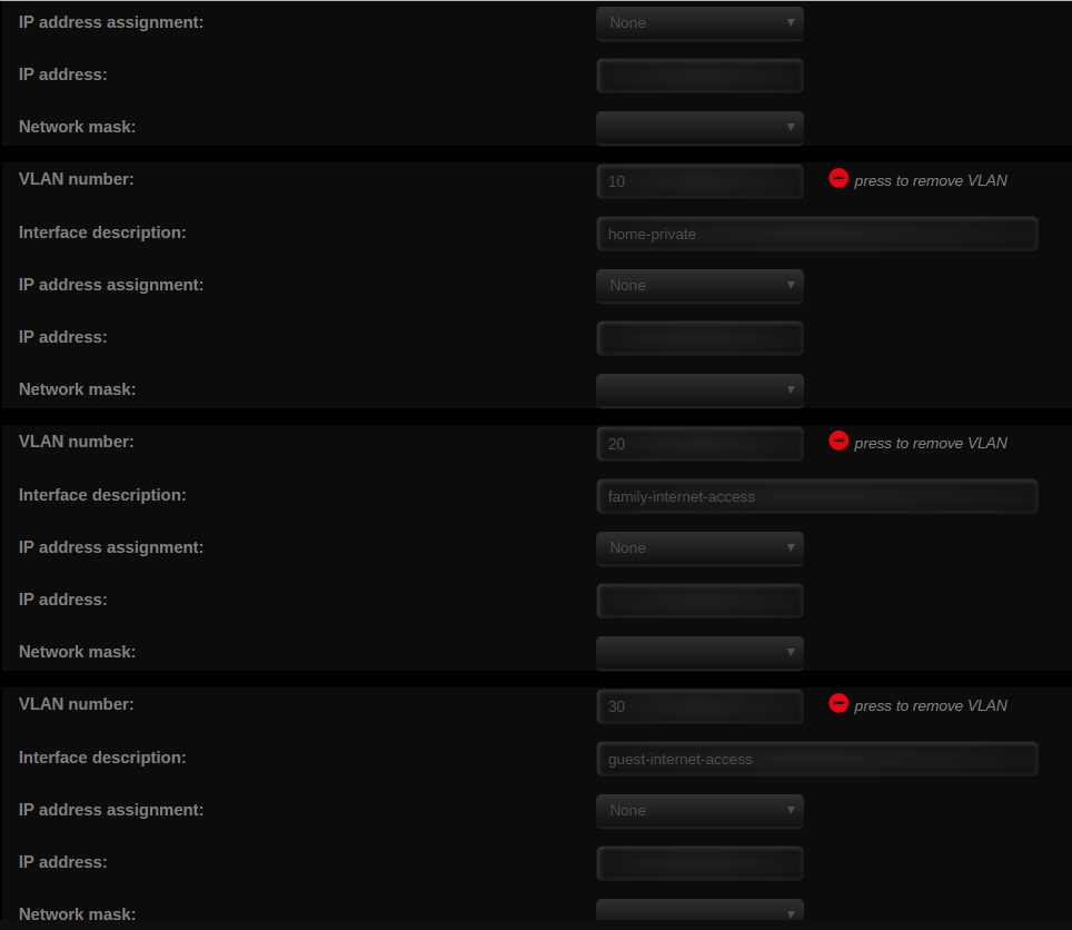

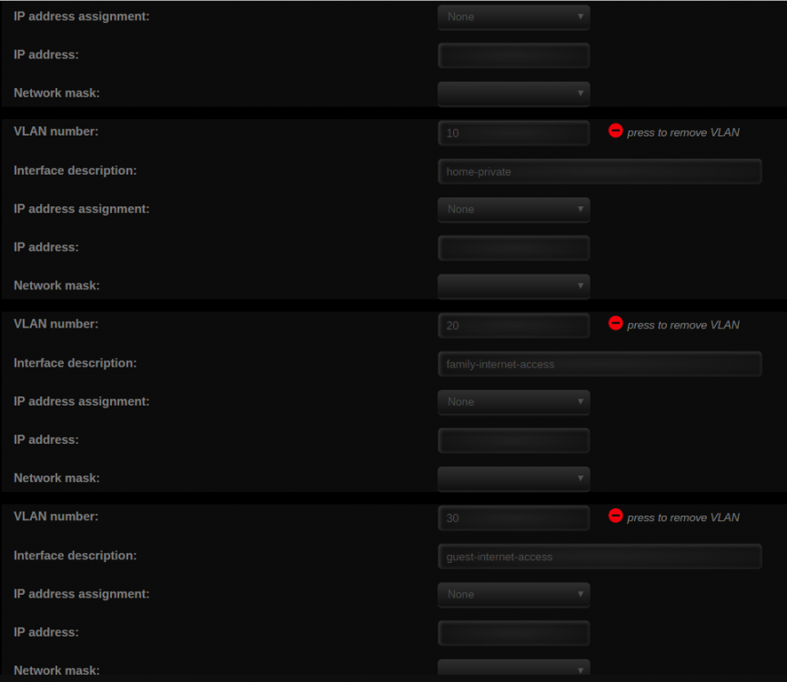

I have recently created several VLAN interfaces in the GUI in order to deploy a new virtual firewall. I have been fighting with it for hours and have not been able to get anything to talk to or from the firewall. I decided to simplify my troubleshooting and install a simple CentOS host to test with. Any VM using br0, works just fine. If I assign any of the VLAN interfaces to a VM, in my case, br0.10, br0.20, br0.30 or br0.5, no traffic will pass anywhere.
Attached are screenshots of the config from the GUI, network-1.png and network-2.png.

VLANs are as follows:
untagged VLAN - same as tagged VLAN 10 and is my primary private network. My switch is able to be configured this way. What happens is all untagged packets get dropped onto VLAN 10, all tagged packets are handled according to the tag.
tagged VLAN 20 - extended family access network, same SSID and key at everyones homes provides easy access.
tagged VLAN 30 - guest network
tagged VLAN 100 - going to be removed, was intended to be the internet facing VLAN, but due to my configuration requirements, limitations within unRAID and my firewall of choice, I ended up passing through a couple of physical NICs instead.
tagged VLAN 5 is my management network
