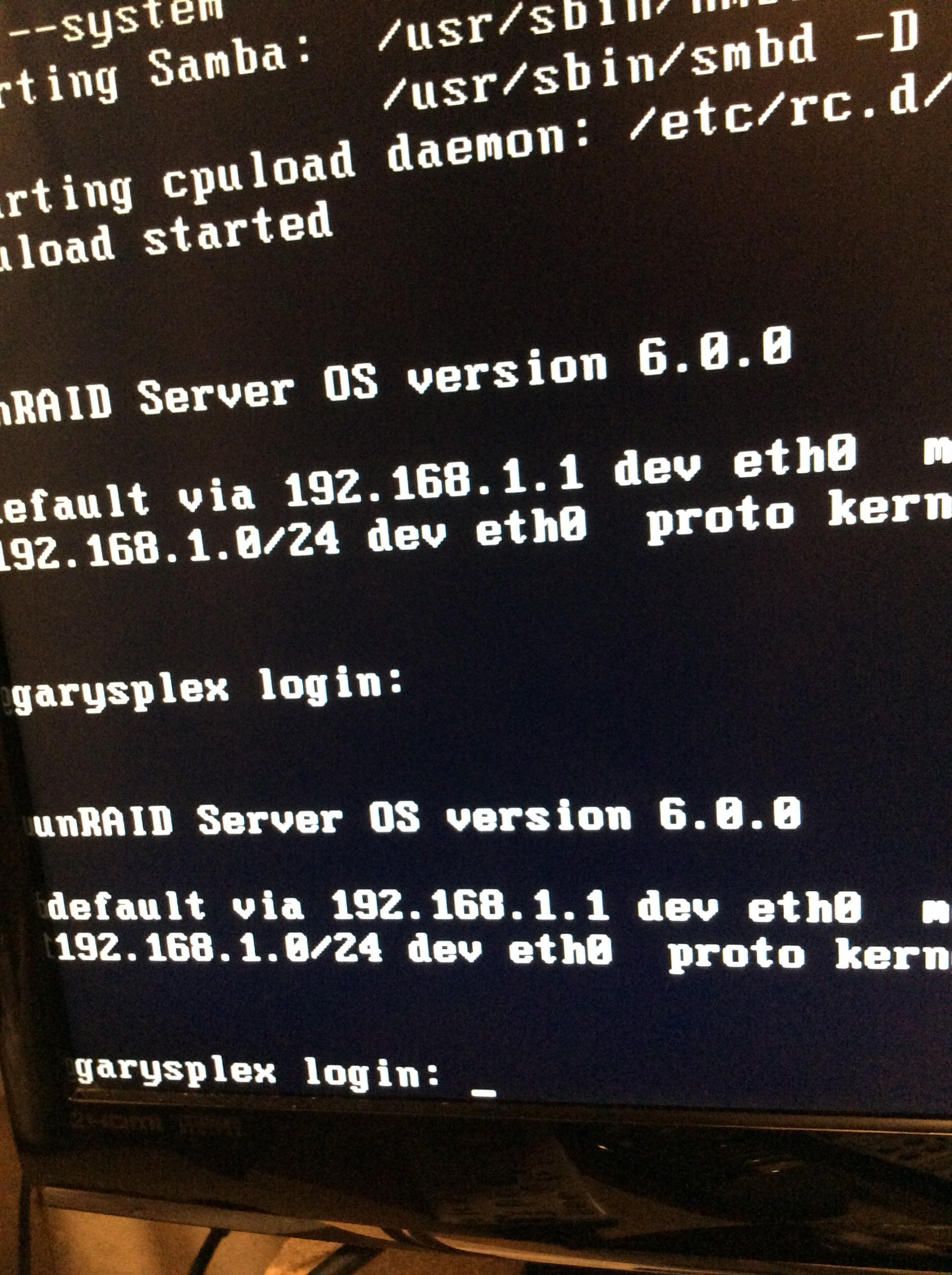

Right now after a power outage i went to turn on the plex server and it starts to boot up and stops at  GARYSPLEX Login and just sits there. I have even tried my password for plex and nothing happens. Hope someone can give me some help.

Can you post a picture of what you're seeing?  I may be missing something here
Perfectly normal for unRaid when booting.  Not normal for when it boots in GUI mode though via the boot menu
From a browser can you browse to http://garysplex  ?
That got me to the dashboard!!
THANK YOU VERY MUCH!!!!!!!
