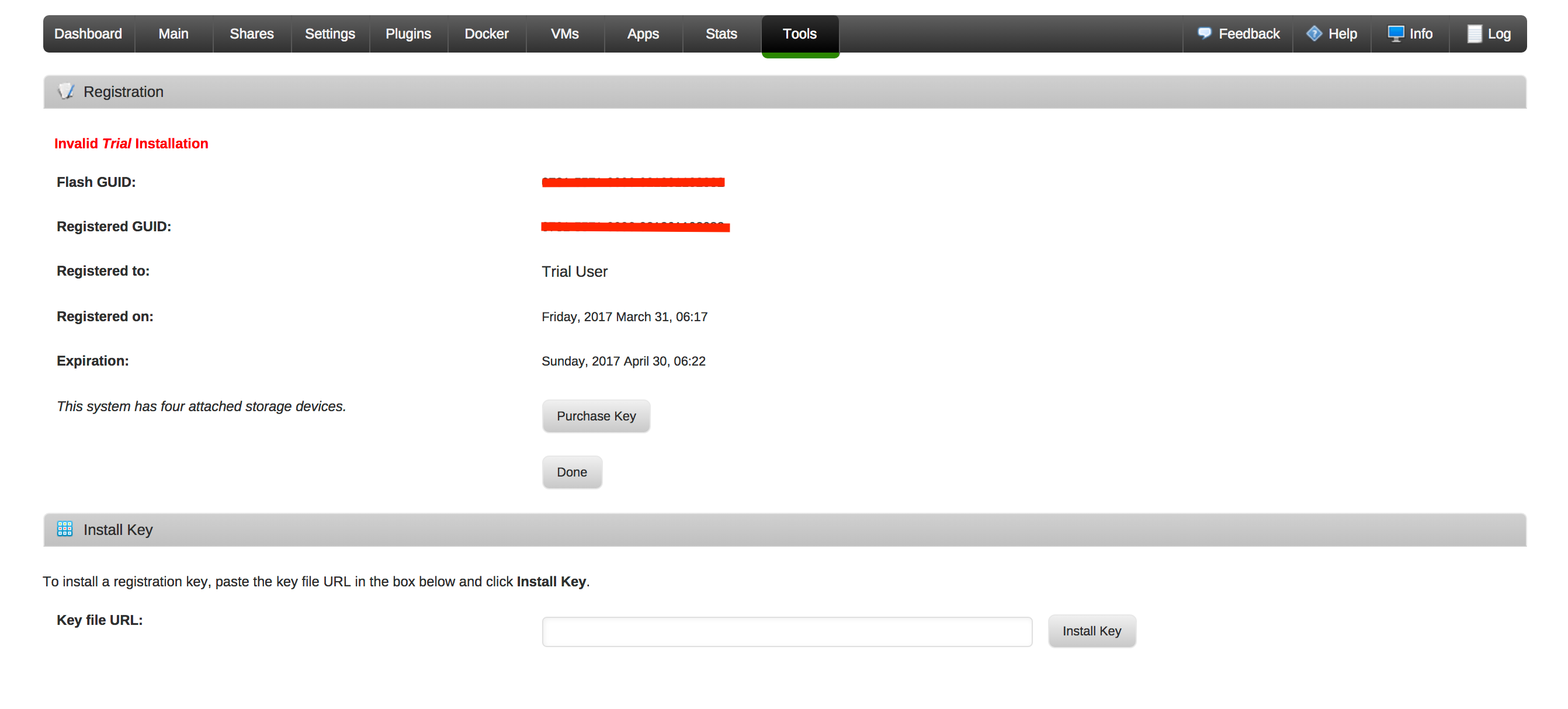

Ok, but I do not have that option as I can see, or am I looking in the wrong place?

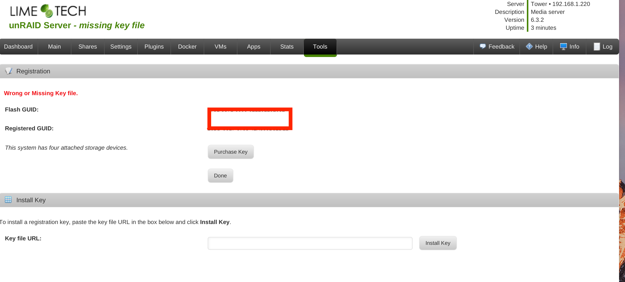

Ok tried and reinstall unraid on my USB memory but get the same thing without a key file.

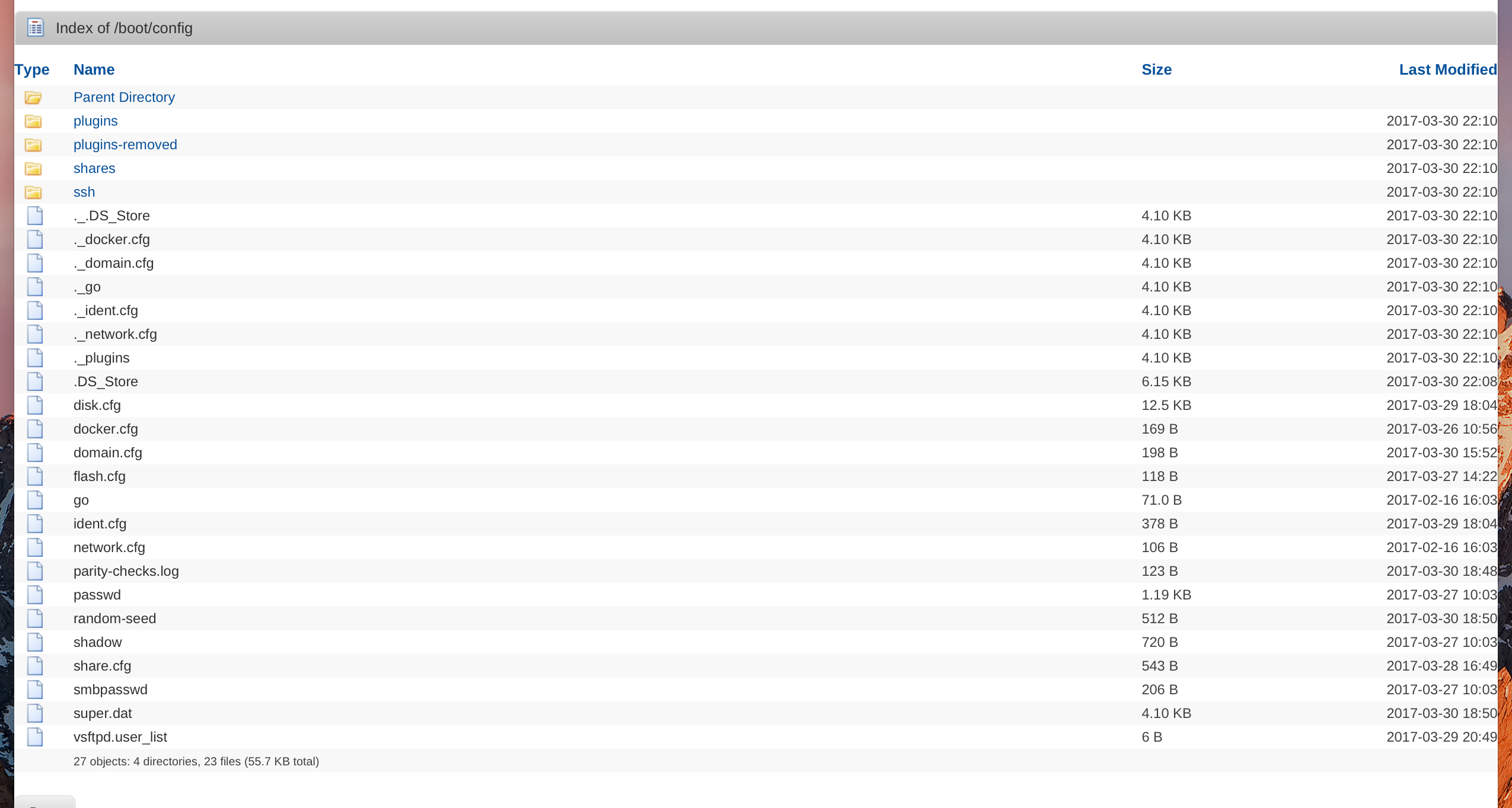

Yes removed usb and reinstalled new unraid to usb then copied config folder without key file
Don't know why it's not working, maybe trial request only appears on a new install, redo the new flash, don't copy the config folder, boot and you should be able to get a trial key, only then copy the config folder and reboot.

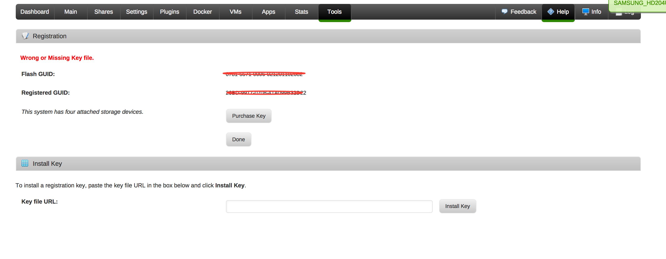

Did as you said and it worked  so I can ask for a new key. But when I copied over config folder, I get a new problem see attached picture. I think soon gives up, it should be right as ** difficult to change the USB memory.

It's very simple and painless to replace a registered key, like I said before you can't replace a trial key, IIRC you're the first to ask for that, and while I though it would work just coping the config folder to a new trial key it looks like LT made this not possible, and after thinking about it it makes sense, it's not uncommon for a any one person to have a half dozen flash drives, if you kept transferring the trial key you would be using unRAID for free for a year, so keep using the original trial flash drive and if you decide to buy a license do it with the new flash drive and you won't have any issues transferring the old config folder.
