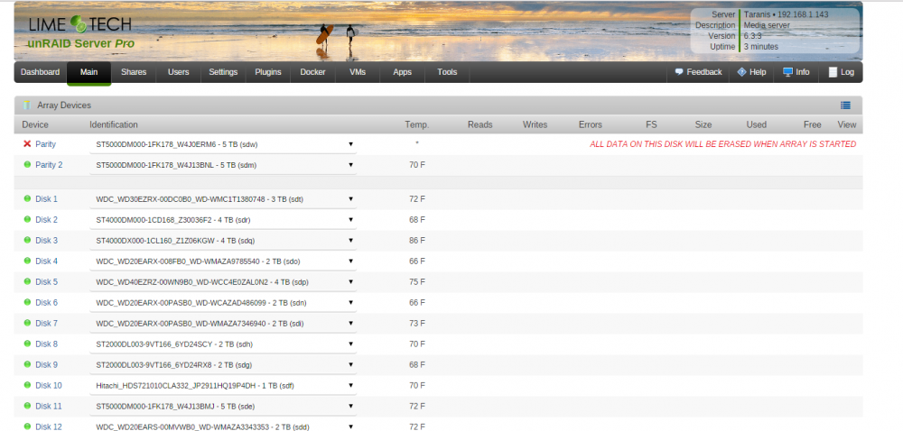

I rebooted and it is telling me it will delete all the data on the parity drive. Is this normal?
Should I start the array?
It is saying your parity is disabled. Was it disabled before you rebooted?
Post diagnostics.
As trurl noted above, it's showing that your Parity #1 drive is disabled.    If you Start the array it's going to attempt to rebuild that parity drive.
Note that the message is a bit deceiving => there is NOT any data on a parity drive other than the parity information, so you won't lose anything.
You DO, however, apparently have a problem with that drive.   Check the SMART data for it; and perhaps reseat your SATA cable to that drive before you Start the array.
The nice thing about a dual parity system is you still have parity protection for your array while you resolve this :D
Or go to Tools - Diagnostics and post complete diagnostic zip and maybe we can tell you more about what the problem is. I will probably split this part of the thread soon since it is unlikely to have anything to do with the release.
