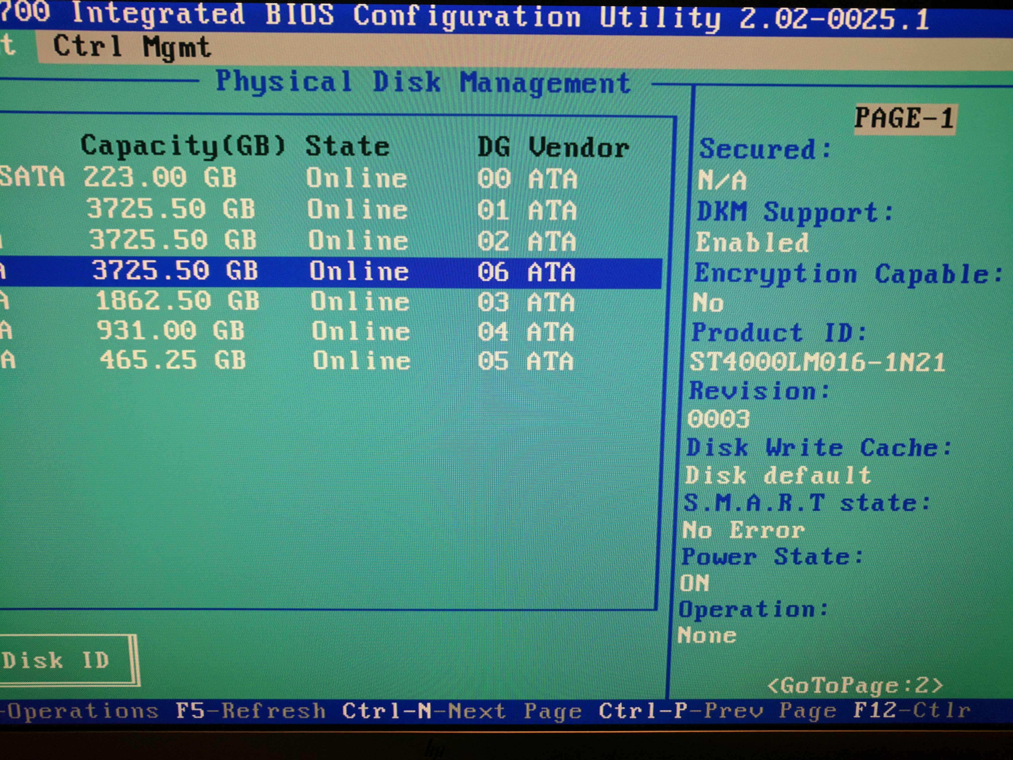

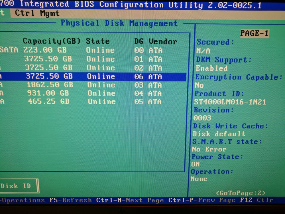

Sorry, I'm not too sure how to get a smart report on the HDD that seems to be failing, when I go to the raid controller it shows that the drive has no errors? What else can I do?

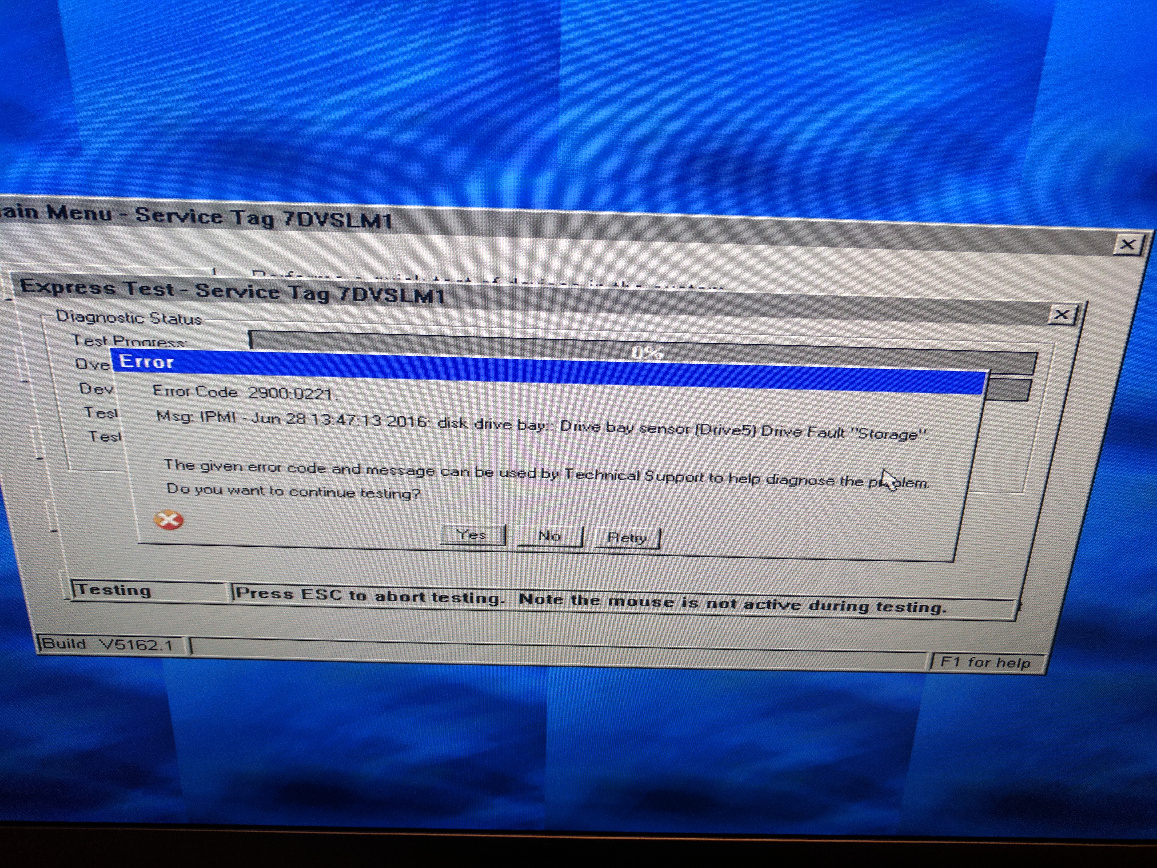

Found another test I could run and it showed this, IMG_20170331_173642.thumb.jpg.d0fd193d33e138131215306134ef75a2.jpg
That appears to indicate a disk problem.
Is that one of the disks with read errors (parity or disk2)?
