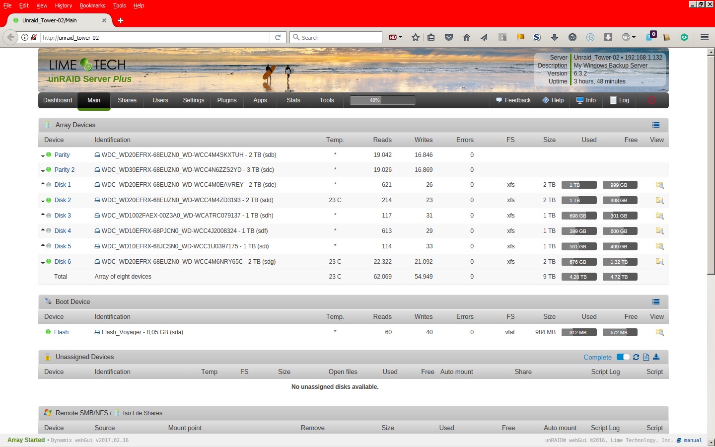

Parity 2TB
Parity2 3TB
disk 1: 2TB
disk 2: 2TB
disk 3: 1TB
disk 4: 1TB
disk 5: 1 TB
disk 6: 2TB
"Picture is a thousand words"
I want to replace 'disk 4: 1TB' with a larger 3TB drive.

In the 'Array Operation' box I get this:-  Stopped. Disk in parity slot is not biggest.   If this is a new array, move the largest disk into the parity slot.
                                                                                                                                 If you are adding a new disk or replacing a disabled disk, try Parity-Swap.
When I do the 'Parity-Swap' procedure it does the same.....
Is the problem caused with one of the 'parity discs' being 2TB
Or
Do I have to replace the 2TB parity with the 3TB disc ....... So I Have 2 x 3TB Parity Discs
stumped again
Thank for reading ...
