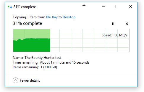

Ok.  As I thought, it isn't the PC.  And yes I have checked for drivers.  Here is me transferring from the desktop upstairs, to a laptop plugged in to the same switch the tower is plugged into down in the basement.  So what within Unraid or the hardware other than the PCI NIC can cause this?

Ok I think I got my PC NIC issue resolved which was caused by the testing.  Don't know what screwed it up, but uninstalling it in Device Manager and rebooting seems to have fixed the problem.  I am back to being able to transfer 110 MB/s to a windows PC on the same switch as the Tower.  For fun I unplugged the network cable from the Tower and Laptop and switched them.  No Change.  Still 110MB/s to the Windows PC, and 40-50 MB/s to the UnRaid box.  I am using the same test file.

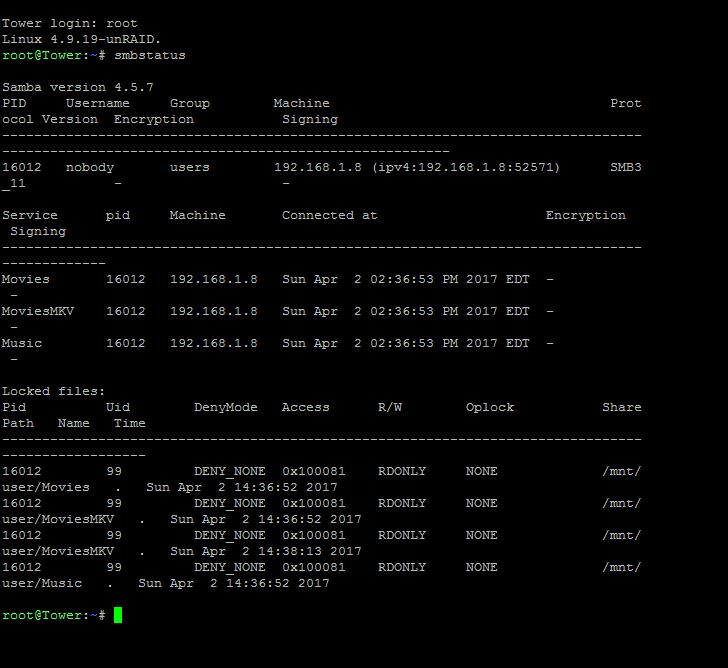

What SMB version are you using?
Sorry to ask such a newb question but how do you tell?  I ran smbstatus via telnet and I get Samba version 4.5.7  is that it?
Edit: Unter the user nobody and my IP of my desktop I am showing SMB3
Edited by allischalmersman

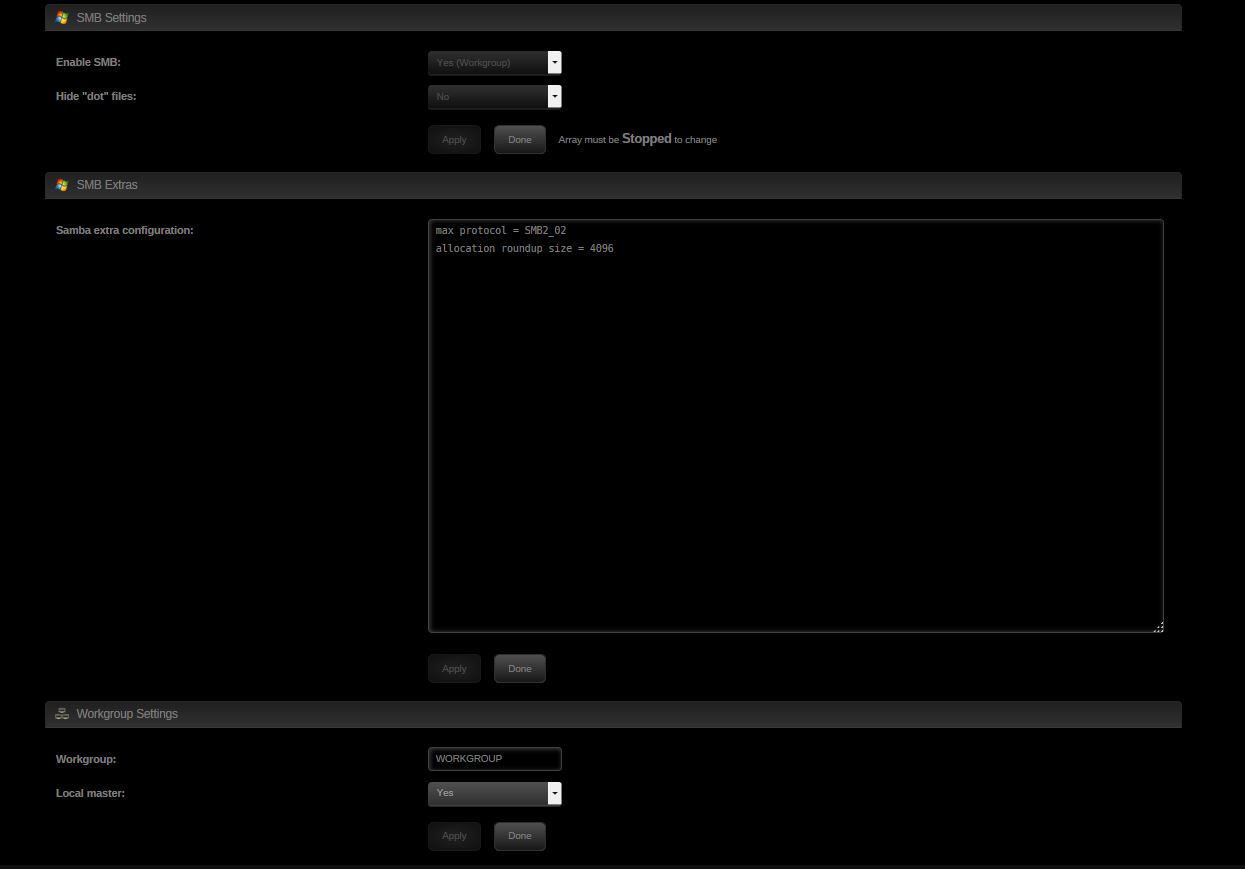

Try adding these lines to the "extra configuration" section for SMB (on the Settings page)
max protocol = SMB2_02
allocation roundup size = 4096
... Not sure, but I think you have to reboot the server for that change to take effect.

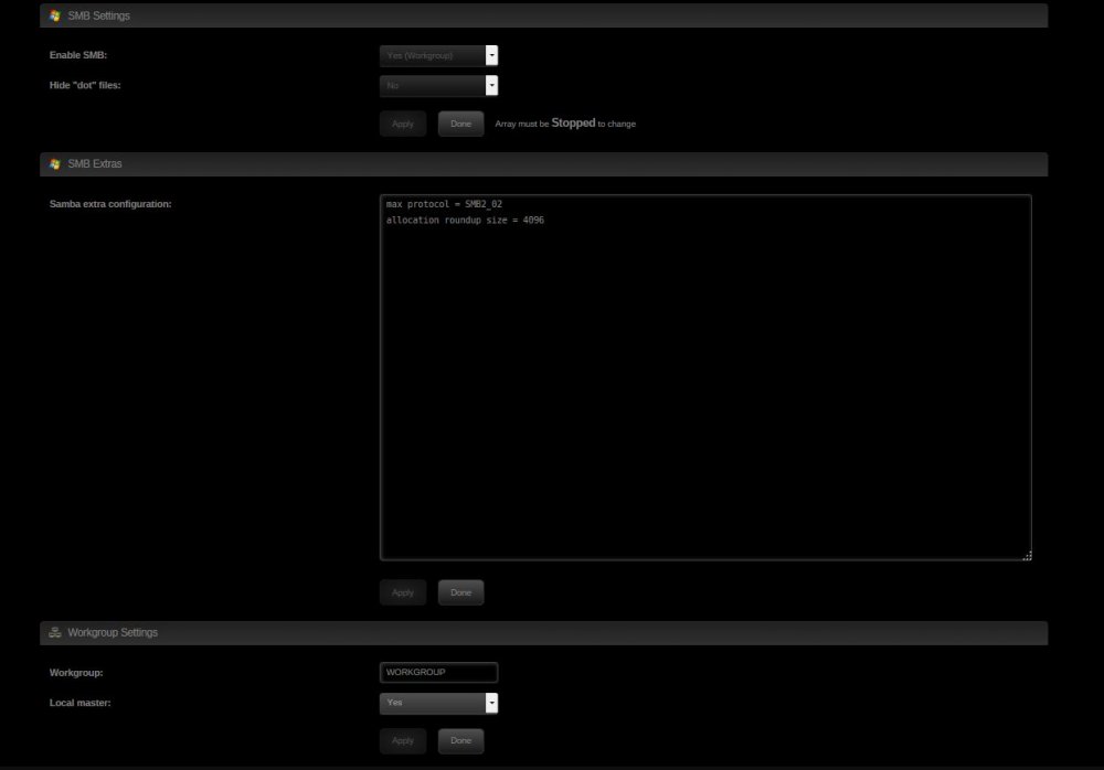

Didn't have any effect even though the setting appears to have "stuck".  I will try a reboot after the parity check is complete (1.5TB left).  This is all I had to do correct?
I believe that's correct.    I don't think the protocol actually changes until a reboot -- but as I noted above I'm not certain of that.   But I do know that some folks have experienced slower transfers when using SMB v3 (I think this is primarily with Windows 10 clients).
I'd reboot after your parity check and see if anything changes.
