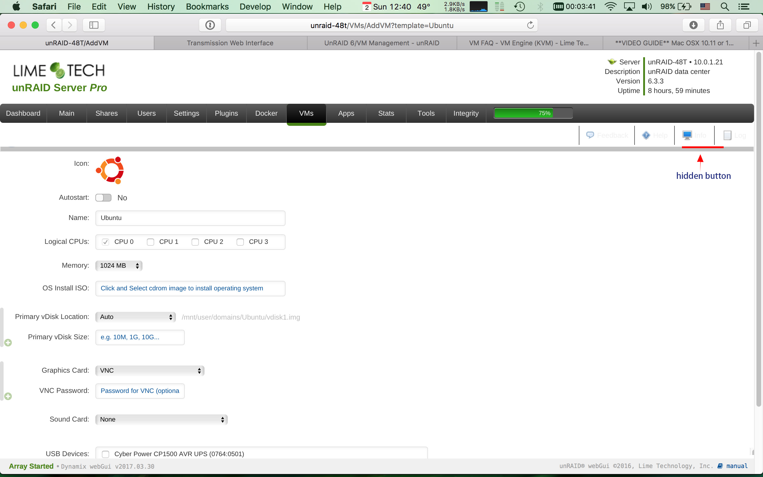

I've read many posts claiming you need to change SeaBIOS when installing some VMs, but seems like I'm too dumb to locate the place to change it. Wiki says:
If you wish to toggle other advanced settings for the VM, you can toggle from Basic to Advanced View (switch located on the Template Settingssection bar from the Add VM page).

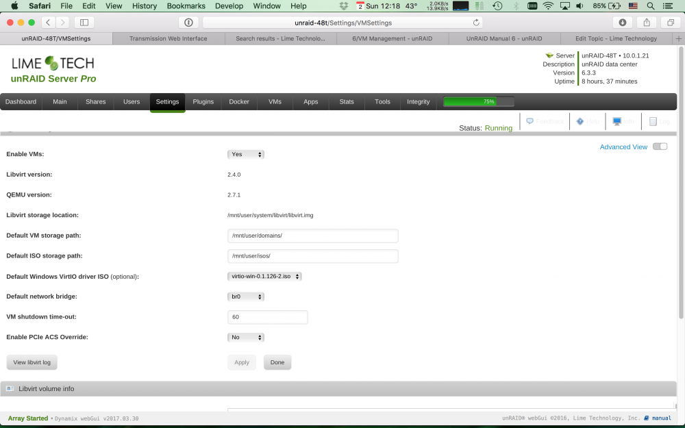

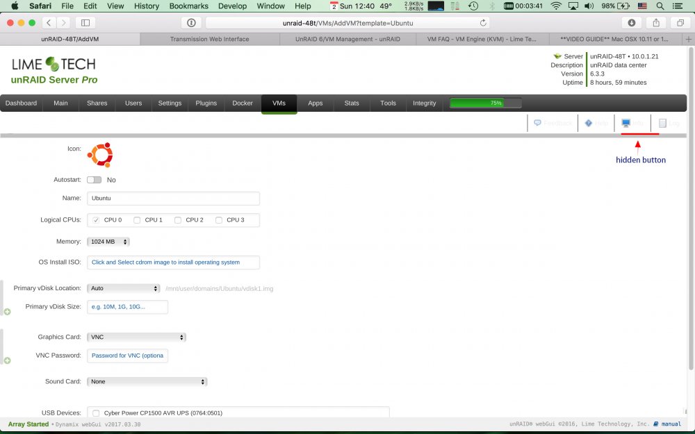

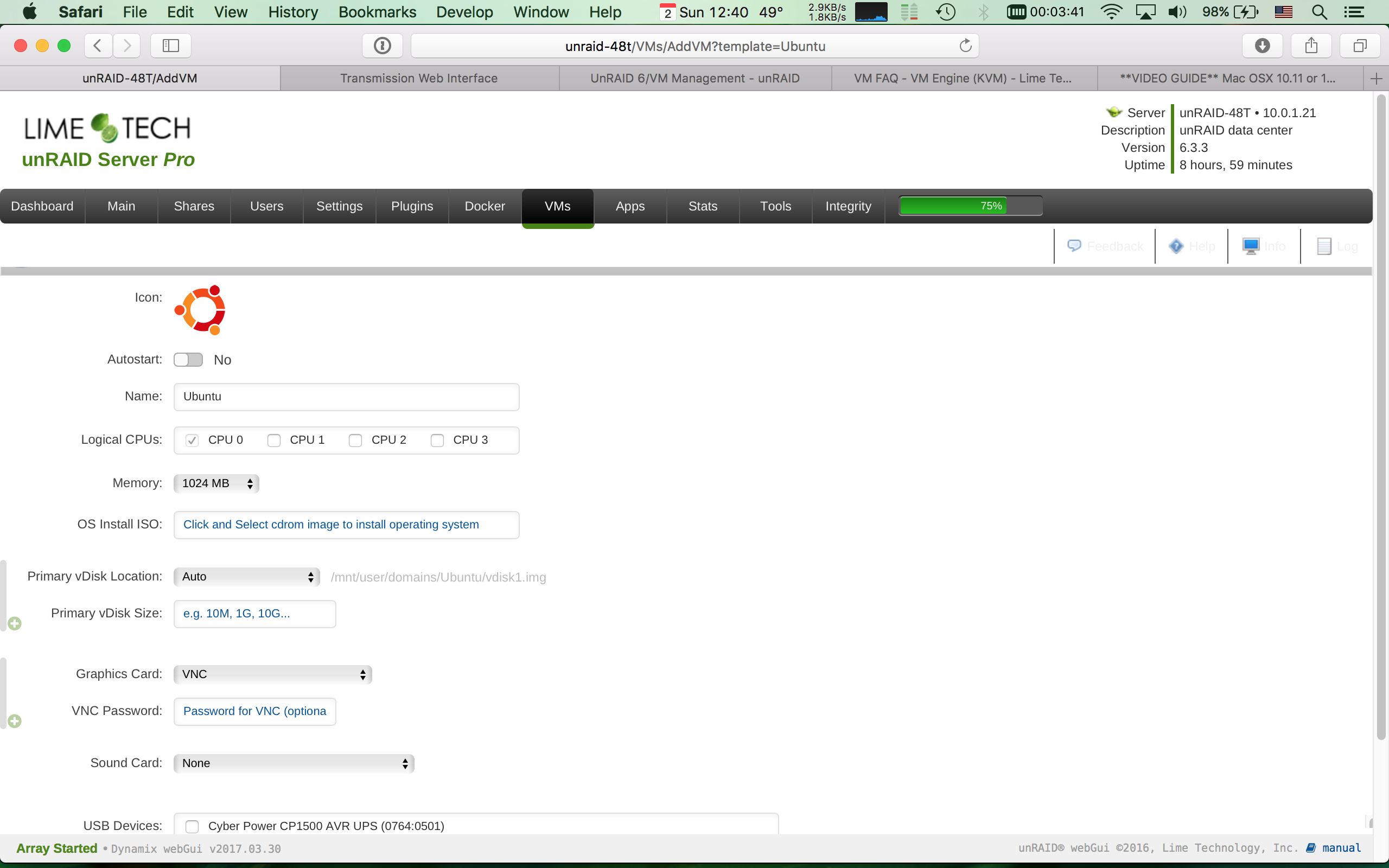

I switched to Advanced View in Settings, but I still can't see any BIOS related settings in Add VM page. Page snapshots attached. Someone please enlighten me.

Ah, sorted it out finally! The Advanced button is hidden for some reason, if I move the mouse slowly into the red area in the last snapshot, a thumb appears and I can click it to enable the advanced view.
Is this a bug ? Or maybe some kind of conflict with other plugins ?58e084ae52b43_ScreenShot2017-04-02at12_40_19PM.thumb.jpg.240f3ec5eee72c9552797ca9a913966b.jpg
I checked around the page source, the offset at top of button is not working, by adding 'margin-top:50px' to $('.switch-button-label.off') and $('.switch-button-label.on') makes the button appearing correctly.
You have too many header menus, go to Settings -> Display Settings and change "Placement of Users menu:" to Settings menu.

Thanks for the tips, I tried moving them into Settings menu, the button is still invisible, it's kind of weird.

I did, the header only has the default menus, but the button is still invisible :(
After uninstalling plugins and Safari extensions one by one, I've finally located the problem. It's caused by a Safari extension named Xunlei for Mac (a downloader). The Advanced View button returns immediately after I removed the Xunlei extension.
