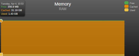

Disk isn't the problem, you're constantly getting out of memory errors.

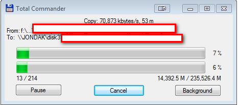

I started again a test copy to the same disk. For now it works pretty good. I will wait and see if it completes the whole 235 gb or test copy.
I have 32 gb ram. Last night i tried to enable the File Integrity automatically protect new files while running a preclear on another drive. I since disabled that setting and checking like this.
LE; Still copying strong at 50 mb/s which is ok considering SMR. Seems the File integrity plugin ate all my memory and gave me a scare.
After 70 gb or files copying i started a preclear to see if his the culprit. For not it seems ok.

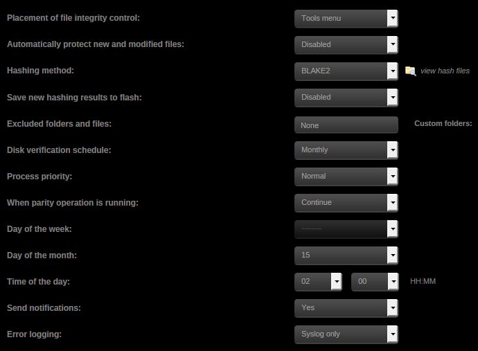

Seems i found the culprit in my case.
After i restarted to get the webui back and disabled the Dynamix File Integrity Automatically protect new and modified files i had 2 days of transfers without problems. I even used File Integrity build without problems. This morning i activated Automatically protect new and modified files and the server crashed again with the out of memory error taking with it the samba service but i could restarted it from the CLI. My settings are after i disabled the the Automatically protect new and modified files again.
