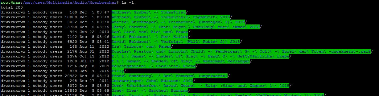

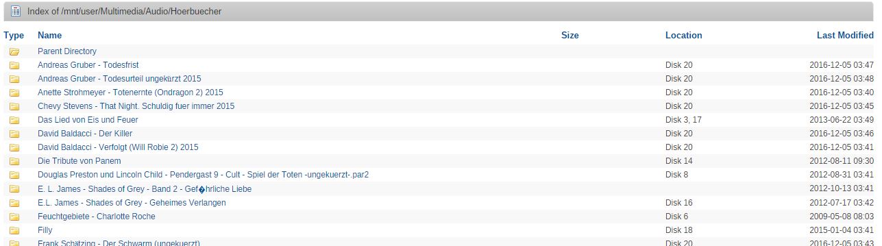

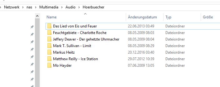

I have a strange issue with my 6.3.0-rc6. I don't see all the files in one of my subfolders via SAMBA but i saw them direct on the server or with the Web Interface
root@nas:/mnt/user/Multimedia/Audio/Hoerbuecher# testparm

In folder "Hoerbuecher" i have 200 Folders and i pretty sure that no docker has written anything in this folder

a) Check if there is a difference in the paths to the files on Disk 6 vs Disk 20 (/mnt/disk6/Multimedia/Audio vs /mnt/disk20/Multimedia/Audio)?
b) See if there is some other common connection on the files that are visible (in the partial screenshot, it looks like the folders on Drive 3 and 6 are visible, but not 8, 16, 18, and 20. Does this hold true for the rest of the files?)

i have updated the Server and all Plugins/Docker....now i see all my folder. Very strange.
Thanks for all the suggestions.
