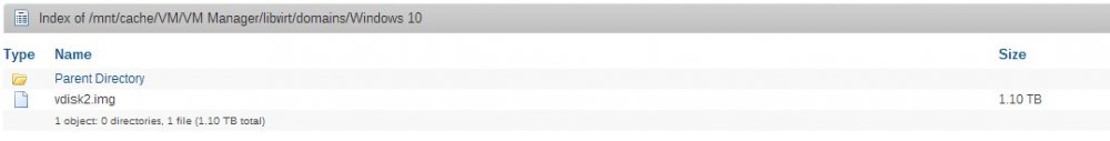

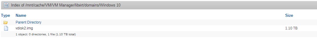

OK, " When the mover finishes check that your cache is empty "
a .img files (from VM manager) remains on the cache drive.It doesn't switch to the array.
How can I move it?
Thanks
Either it was in use or it's in the root of your cache and not part of any share.

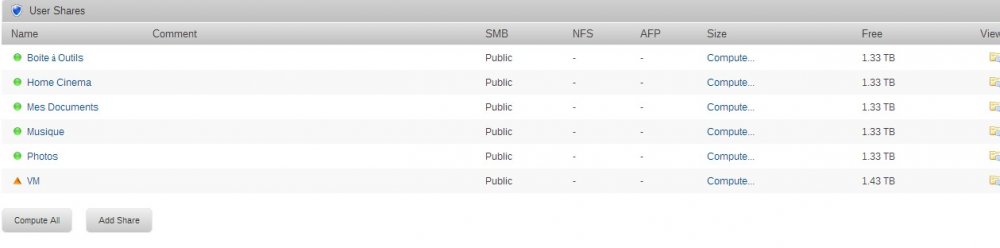

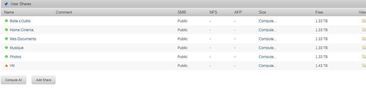

Actually, the file is not in use, and is a part of share.
My objective is to move it in the array.
I join 2 screen capture.
Thanks

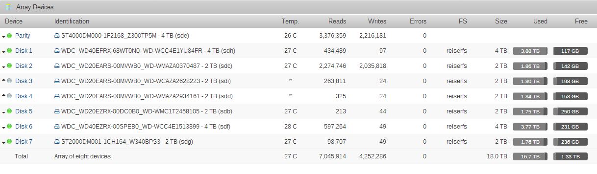

Either VM was on or not enough space on the array (may be due to how the min free space is configured for that share).
Run the mover and post the diagnostics after.
You're right, maybe not eough space.
I'm going to add a new hard drive.
Thanks
The vdisk is 1.1TB, since unRAID can't stripe data you need to have that space available in a single disk, you'll also need to configure that share to include only the new disk or set a minimum free space above 1.1TB, or else it will try to copy it to the disks above.
