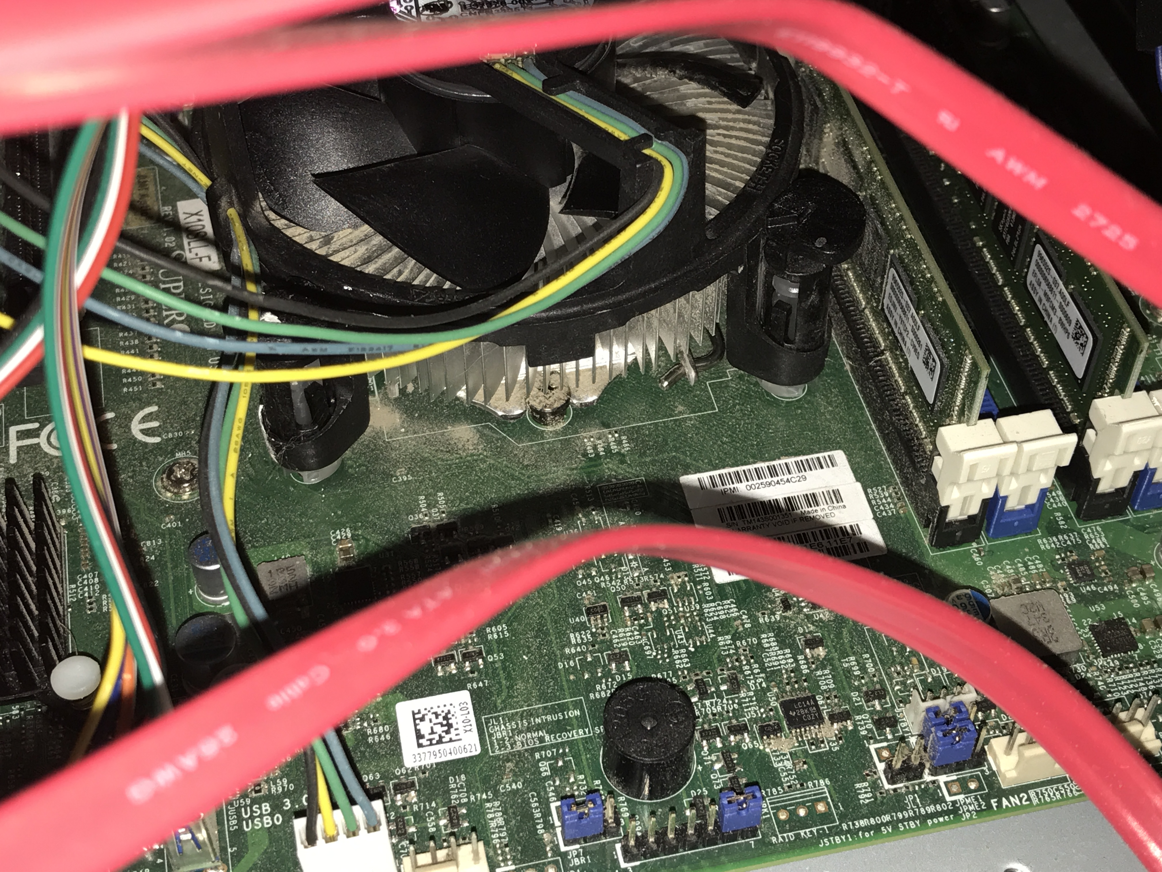

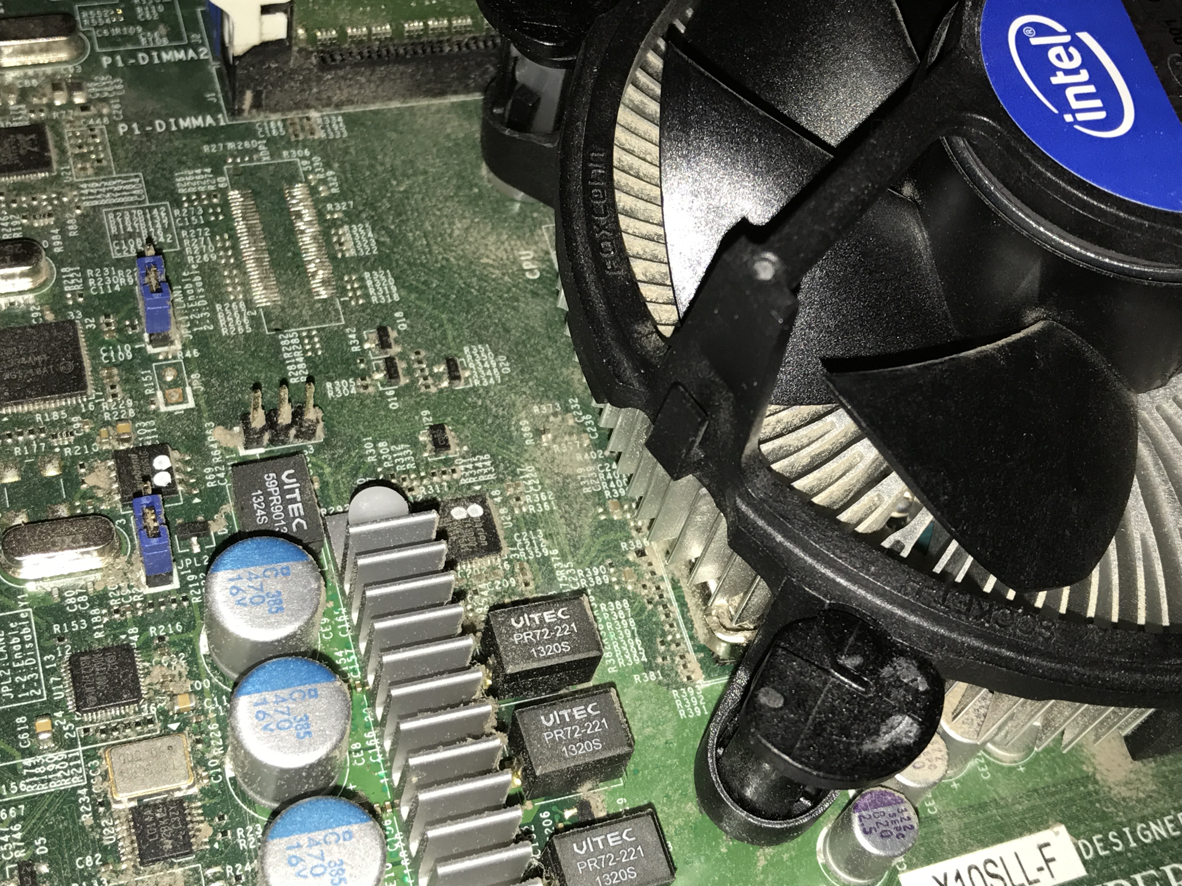

These pics aren't great, but the best I could get without removing the motherboard.
Those hold downs are problematic on reuse sometimes. Are you sure that the clearish plastic part that pokes through the motherboard holes are fully seated on all 4 posts? The way they grip means that pushing them back through a second time sometimes catches one of the "petals" on the top side of the board instead of going through the hole. The only way to know for sure whether that is the issue without taking it back off is to look at the back side of the motherboard, if you can see it.
I'm fairly sure the posts are fully inserted. If I get a chance I may pull the motherboard but honestly I'm not sure the cpu is good. Can cooling problems effect cpu load? The fact that the load on it is so much higher than it is with the old 1230 that it replaced makes me doubt that I'd ever trust it now. I may just go ahead and return it for a refund and shell out the money for a new 1241.
Any Intel retail cooler will cool a 1241 no problems.  I'm of the mind that it's not seated correctly too.
On the last picture it looks like the right-hand little black catch hasn't caught on the ratchet thing on the clear part of the clip.  You need to push those black clips down HARD until you hear the sharp click.  They should be approx 2mm further down.
When you twisted the black bit to release the clips, did you twist the clip back?  It looks like you haven't on one of those pictures.

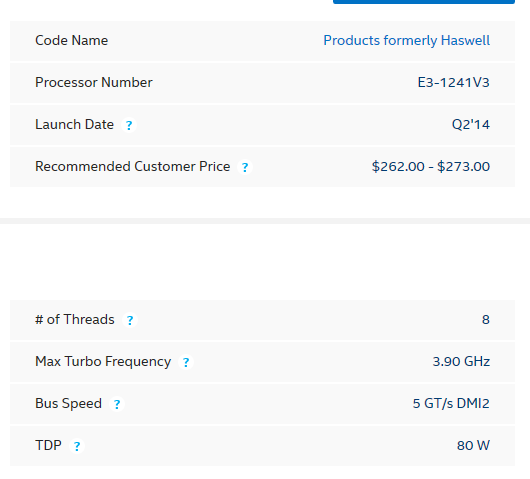

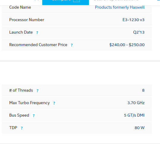

Ahhhhh! That makes sense (Though why it would affect the 1230 and not the 1241 is beyond me. They appear to be almost identical. Only difference I could see is the 1230 supports DMI and the 1241 DMI2). For those that, like me, who had no idea what DMI was: :)
DMI: direct media interface (DMI), which is a point-to-point interconnection between an Intel integrated memory controller and an Intel I/O controller hub on the computer’s motherboard
When does the new CPU arrive?
Edited by DoeBoye
DMI is the same for both, it's just referenced different in the ARK site, DMI=2.5GT/s, DMI2=5GT/s, in fact it's the same for all CPUs that use the same socket.
The xxx1-v3 models are Haswell refresh, usually 100MHz faster than the equivalent xxx0-v3 model.
Then there's a typo on their site, as the 1230 says DMI, while the 1241 says DMI2.
Like I said it's not a typo, it's just referenced differently, 5GT/s DMI= DMI2

In case it's helpful, the correct orientation of the latch for the Intel cooler is rotated fully clockwise before locking.  Looking at the photo, I have to agree with others' comments - they appear unlatched.  Even if they are going through the PCB, they will not be pressing the heatsink down onto the CPU with enough pressure to ensure good thermal contact.  The slot in the retainer should point to the center of the fan when in the lock position.
Details here from Intel...  http://www.intel.co.uk/content/www/uk/en/support/processors/000005852.html
Absolutely correct, didn't notice that, and at least in the second photo it's clearly visible it's in the unlocked position.

I'm going to have to respectfully disagree. It's a typo. Not that it really matters, but for the record, every other chip of that generation states "5GT/s DMI2", while the 1230 states "5 GT/s DMI". Please refer to the screenshots below :).
