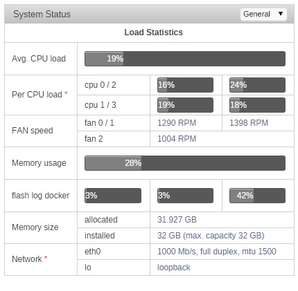

[6.3.3] Dashboard CPU Utilization Percentage
Description: Dashboard CPU percentage values remain static.
How to reproduce: Normal boot and start of services, start docker instances, start VM instances.
Expected results: Individual and aggregate total CPU percentage use values are representative of load and vary as CPU load changes.
Actual results: Shortly after all services and instances startup and systems stabilize at running state and load, the values for CPU aggregate and individual CPU cores do not change.  Potentially the memory values are affected as well. The fan RPM values do change.
Other information: Using Netdata plugin, can monitor core and aggregate CPU utilization.  Results here indicate expected representation of load fluctuating as expected.
In screenshot for example the aggregate CPU load will remain at 19% with no change.  Same with cores, the represented values after some period of startup, don't change.
unraid-diagnostics-20170408-1248.zip
Edited by joedotmac

If no on else has a solution, I would suggest using the 'Tweaks' Tab of the 'Tips and Tweaks' plugin to set  " Disk Cache 'vm.dirty_background_ratio' (%): " to 2%  and "Disk Cache 'vm.dirty_ratio (%):"  to 4%.  The percentages are a default of Linux and geared to systems with a minimal amount of memory.   You have 32GB and these two parameters are utilizing a huge chuck of it.   (As I understand it, these parameters allocate memory so that disk writes can be queued so that disk access functions are efficient and user responsiveness effects of disk IO are minimized.)
Thanks Frank.  Will this effectively make greater use of available RAM, lessening IO impact with the drives?
I made the suggested change.  Reloaded unraid for a fresh boot and initialization of all processes, docker, and VM's.
Would anything here be indicative of the unraid USB flash drive integrity being questionable?
Yes
I was looking more at your memory allocation failures in your post when I made my suggestion.  But with you reboot apparently without issue-- for example, no parity check on restart, I would assume that your Flash Drive is OK.    You could look at your syslog   (  'Tools'  >>> 'System Log'  ) and then uncheck the "Text" box (gets rid of 90+% of the log entries)  at the top and look for errors that might be related to your Flash Drive.
Thanks Frank.  I made the suggested change to the syslog view to narrow down any indication of flash drive issues.  I'm not seeing any thing that would indicate flash drive problem.
Haven't had much of any change in mitigating of issues.  VM's and plugins stop randomly, CPU percentages on dashboard still hang after 30 minutes or so of system up-time.
Current snapshot of errors and warnings over the last 24 hours.  I keep researching looking for a release note or some glimmer of hope to find any even small success that may lead to something more considerable.
syslog050417-errors.txt
Another interested error find is this.  Seems whichever plugin is associated with Dynamix plugin "monitor" when it fails it seems to try and call out google page to possibly post event details to a developer support page?  The creds per the error message connection attempt aren't valid so it barfs even on that.
Apr 30 05:05:01 unraid kernel: monitor[17472]: segfault at 0 ip 00000000005f42ad sp 00007fff178379e0 error 4 in php[400000+724000]
Apr 30 05:05:16 unraid crond[1737]: exit status 139 from user root /usr/local/emhttp/plugins/dynamix/scripts/monitor &> /dev/null
Apr 30 05:05:16 unraid sSMTP[17495]: Creating SSL connection to host
Apr 30 05:05:16 unraid sSMTP[17495]: SSL connection using ECDHE-RSA-AES128-GCM-SHA256
Apr 30 05:05:16 unraid sSMTP[17495]: Authorization failed (535 5.7.8  https://support.google.com/mail/?p=BadCredentials l46sm5351894ota.0 - gsmtp)
Apr 30 05:06:01 unraid crond[1737]: exit status 139 from user root /usr/local/emhttp/plugins/dynamix/scripts/monitor &> /dev/null
Apr 30 05:06:01 unraid sSMTP[17560]: Creating SSL connection to host
Apr 30 05:06:01 unraid sSMTP[17560]: SSL connection using ECDHE-RSA-AES128-GCM-SHA256
Apr 30 05:06:01 unraid sSMTP[17560]: Authorization failed (535 5.7.8  https://support.google.com/mail/?p=BadCredentials w6sm5454754ota.19 - gsmtp)
Apr 30 05:06:16 unraid crond[1737]: exit status 127 from user root /usr/local/emhttp/plugins/dynamix.system.stats/scripts/sa1 1 1 &>/dev/null
It would be trying to email yourself with the credentials you've set up in notification settings, but your password is incorrect.  Do you receive any notifications?  What happens when you test the notification settings?
I had never setup the email notification settings.  The default email notification settings appear to select gmail, but there was no address, creds of any type configured.  The settings for notification only were selected for browser notification, email wasn't checked to engage on any of the message levels.  Regardless I updated the settings to pop my email domain.  Have to see if anything changes, didn't see a test button or the like.  Thanks for the insight.  Will be looking to see if there are any changes.
Edited by joedotmac
Downside of the "cron" system.  Abnormal exits from a job (in this case, monitor) linux always attempts to email to let the system administrator (you) know.  Overrides any setting in the GUI.
Also, syslog snippets are very rarely useful, if only because there is no context to them without seeing anything else.  Always post the full diagnostics.
  • 3 months later...
Problem is now solved.  Not certain what actually solved it.  Removing, reinstalling all the dockers, upgrading to 6.3.5 are possiblities
