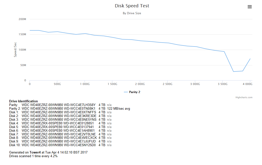

This disk was parity2 on one of my servers and last week I noticed writes were a lot slower than usual, eventually even got a few read errors, but the disk wasn't disabled and SMART looked fine, still I suspected a disk problem so I ran diskspeed and it confirmed there was a noticeable performance dip in the end, so I took the disk out and ran MHDD, my favorite tool to test a disk.
I made a little video for anyone interested, for those unfamiliar with it, important info to look at is in the right side, ACT (Current disk read speed), below that are individual sector delays (it's normal to have a few >50ms sectors, but many like that or >150ms is not normal) and finally look at the percentage below that for the current disk position.
Video starts at the beginning of the disk, speed is normal at ~150MB/s, I then skip to 50%, again speed is normal for that position, about 125MB, finally I skip to 90% and here the problem is clearly visible, many slow sectors with read speed dropping to <1MB/s in between zones with normal speed for that position.
So I preemptively replaced an apparently healthy disk with very few power on hours that it's certainly going to die soon.

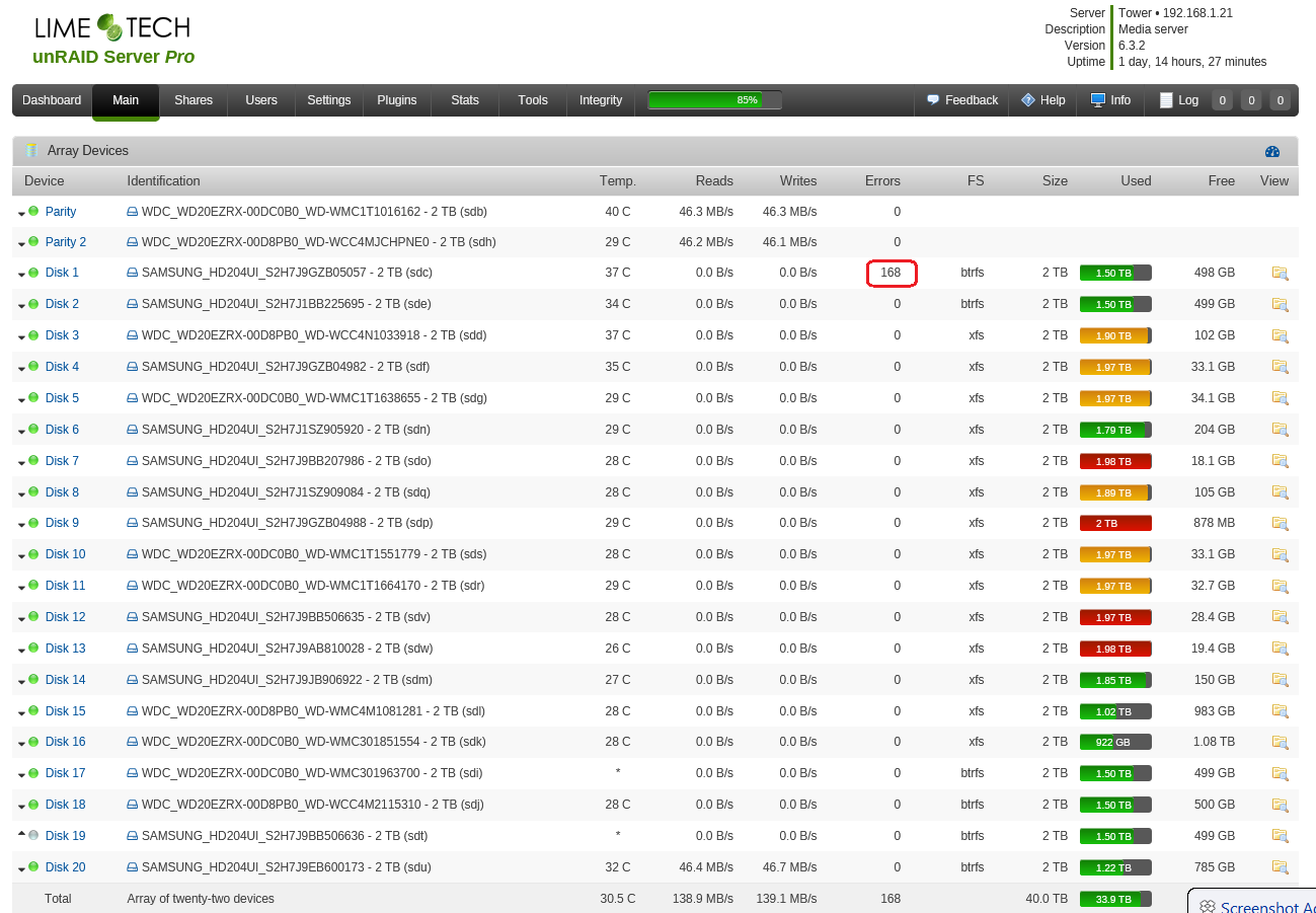

This topic is fascinating. I still plan on working on the disk scanning/mapping tool but been working on another project not related to UNRAID.
Finally got around to replacing disk1 on the server from the screenshot above, had to replace disk12 at the same time because it redballed last week with a pending sector (yay for dual parity!), disk1 gave me read errors twice, and like I suspect it's full of slow sectors.

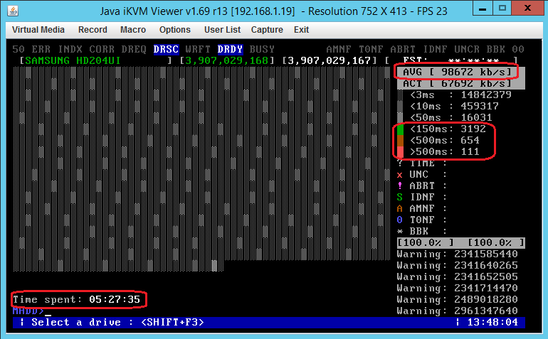

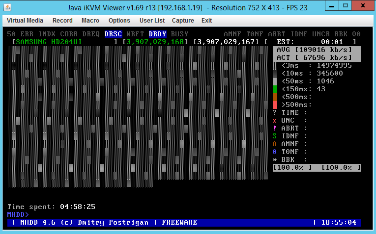

But compare a full MHDD scan with a still healthy disk from the same model, notice the differences in the average speed, time for scan and mostly the quantity of sectors with delays >50ms, these are a bad sign, especially those with a delay >500ms, just a question of time for some to turn into bad sectors.
These slow sectors were enough to give read errors and bad performance on the worst affected areas, but ATM there are no bad sectors and the disk would pass an extended SMART test.
Unless you have changed something, 500msec should not be a read error. It is slow, but the timeout is measured in seconds and defaults to 30 seconds. This is the reason for TLER, the 30 seconds is wasted time when the array can rebuild from other drives far faster.

I didn't change anything, and notice that it's >500ms, that means that those sectors took more than half a second to read, not half a second exactly, so while I'm not certain if there was a read timeout or if at that time there really was a read error but unRAID successfully wrote that sector back so the disk wasn't disabled, I'm as certain as I can be that those read errors were caused by the disk, and it's not the first time this happens with a disk in similar conditions.
Yes, I did notice it said <500ms and >500ms, and 30,000ms is a long way from 500ms. TLER is 7,000ms.

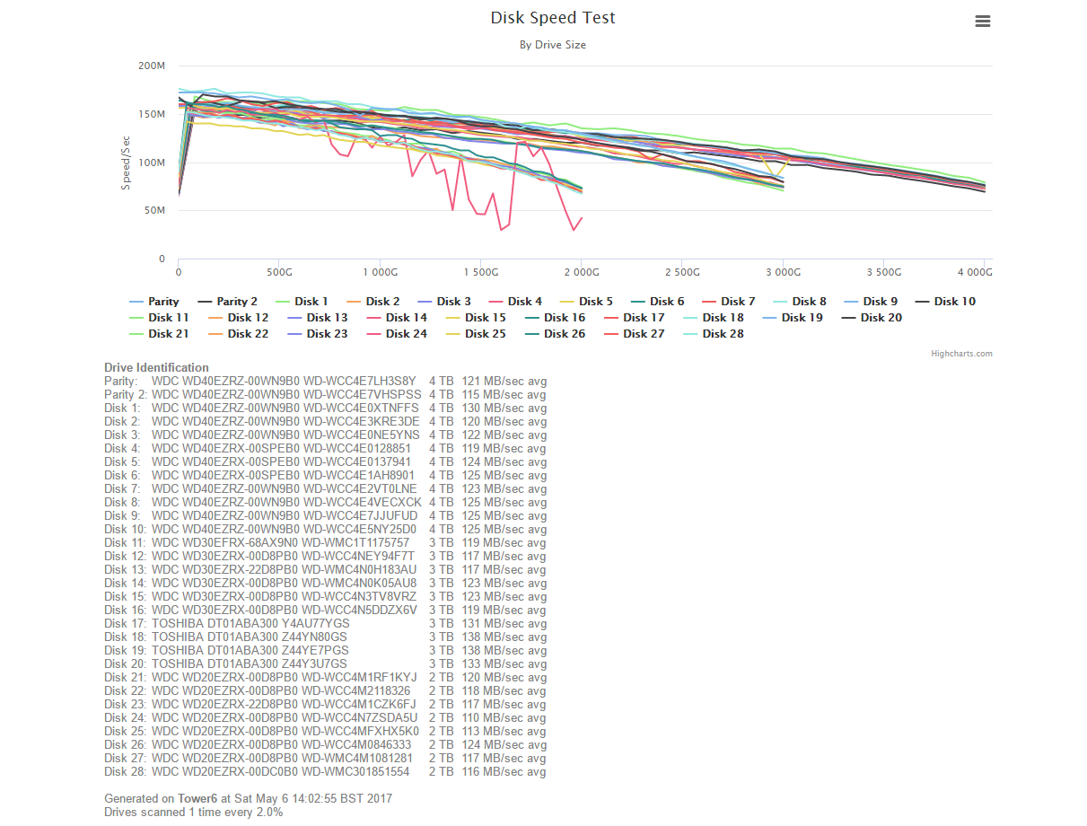

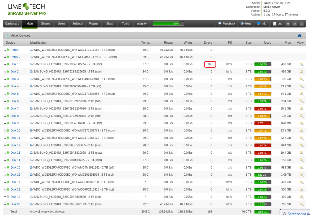

Another one :S
Noticed the parity check taking much longer than it should, speed dropping to 10MB/s several times:
