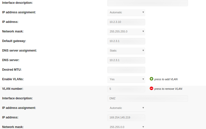

To clarify, you're saying to setup a static IP in the network settings of unraid itself?  or setup static IP in the network settings of the VM?
I'm currently having a similar issue where unraid will not grab an IP on the VLAN i had setup on my router ( Ubiquiti edgerouter connected to a smart switch) and my VM's also won't grab an IP either from the DHCP server.

I seem to be not having the same success as you.
58ef8c7bde262_Screenshotfrom2017-04-13103413.png.b627ddd008062daa4319e570cb76a4a3.png
I changed the VLAN to static but my vm still couldn't access anything on the network (even the gateway)
ip address assignment to static, not automatic if you want to change that.
I don't play with vlan's on unRaid so I can't help much  there unless you change the assignment to static (shows auto in the image). Array has to be topped to make the changes, but you probably know that.

When using VLANs you need to set up your switch to handle VLANs as well, is this case you need to enable vlan tagging on the switch port.
The address 169.254.xxx.xxx signifies the server times-out in contacting the DHCP server to obtain an address, likely because the DHCP server isn't reachable (see point above).

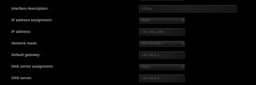

You seen to have a 10GBe NIC. Mind asking me what brand NIC/switch they are/connected to? I do have the same EdgeRouter (Lite) as you, though the exact model may differ.
I want to build something similar.
FWIW Here is what I use:
Mellanox connectx-2 MNPA19-XTR. I have one in my main server and one in the backup server. Originally I had one going directly to the other with DAC. But now, both go into a quanta LB4M.  I was going to build a switch with vyos but decided plug and play was nicer, in addition to the 48 gigabit ports on the switch.
