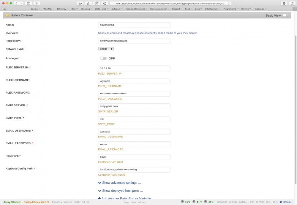

Can you post a redacted picture of what's in your docker template? Please make sure not to redact it too much (example: you use user for your email address instead of [email protected])
Sent from my iPhone using Tapatalk Pro
Can you change the following and re-test?
Email port from 465 to 587
Email username: add @gmail.com to it.
Didn't work-
