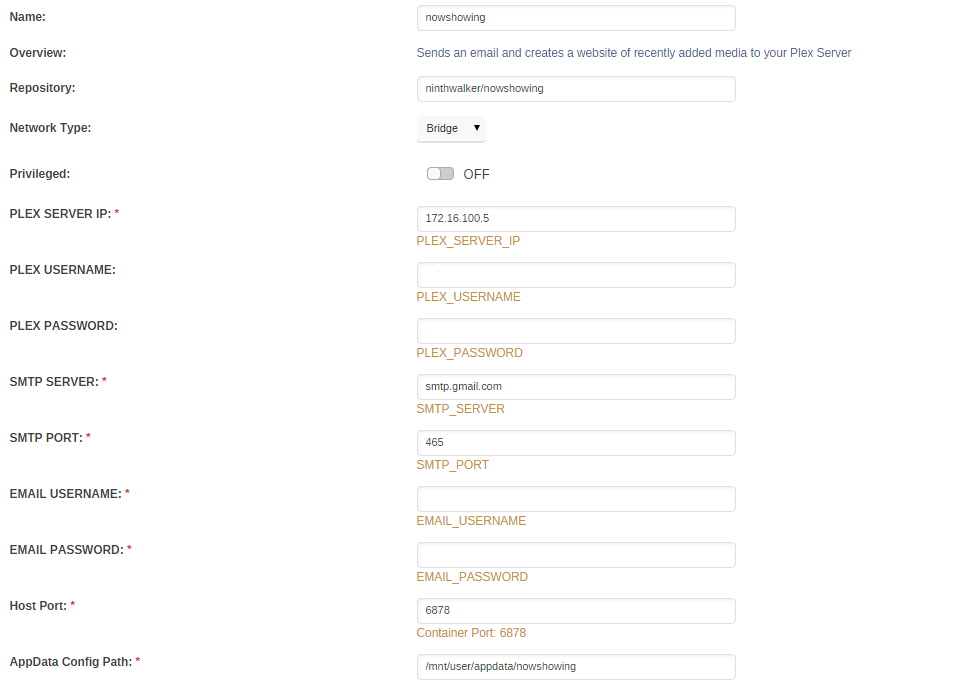

Can you post a picture of your docker template (make sure to omit anything you don't want shown but only change it slightly), your NowShowing folder, and your advanced config.ymal file please (again, making sure to change/omit anything that like passwords and what not)..
Ok!  I think I've attached everything.  In the docker template, I have set my user name and password for plex rather than the token.  Additionally, I do have a gmail account sending the reports.  That account is also my main account for sending me all such updates from various services, so the security settings are there to allow this type of activity.
Let me know if I missed something!
advanced.yaml
Couple things I'm noticing.
1) Your SMTP port is set to 465. It needs to be set to 587, and you might need to enable insecure applications to allow NowShowing to send on behalf of your gmail account.
2) You selected 'no' for plex emails without specifying any emails below. From the advanced_config.ymal.example:
plex:
# To be used in conjuntion with the recipients and recipients_email options below to customize who the emails go to.
# 'yes' will send to plex users emails. 'no' will NOT send to plex user emails and only send to emails and users in the recipients fields below.
  plex_user_emails: 'yes'
Please make those changes and retest. Let me know how it goes!
I had the same problem with mine. Don't know why Google specifies 465 for ssl connections.
Yeah, they require TLS now which they run on 587.
Sent from my iPhone using Tapatalk Pro
Thanks! Everything is working perfectly now!

I may be wrong but it looks like a problem with the smtp settings in your container template. You may want to post a copy of that as well with passwords and such redacted.
Name:
nowshowing
Overview:	Sends an email and creates a website of recently added media to your Plex Server
Repository:
ninthwalker/nowshowing
Network Type:
Privileged:	OFF
PLEX SERVER IP:
xxx.xxx.xxx.xxx
PLEX_SERVER_IP
PLEX USERNAME:
xxxxxxxxxxxxx
PLEX_USERNAME
PLEX PASSWORD:
xxxxxxxxxxxxx
PLEX_PASSWORD
SMTP SERVER:
relay.plus.net
SMTP_SERVER
SMTP PORT:
25
SMTP_PORT
EMAIL USERNAME:
xxxxxxxxxxx
EMAIL_USERNAME
EMAIL PASSWORD:
xxxxxxxxxxx
EMAIL_PASSWORD
Host Port:
6878
Container Port: 6878
AppData Config Path:
/mnt/cache/DockerAppData/nowshowing
Container Path: /config
 Show advanced settings ...
 Show deployed host ports ...
 Add another Path, Port or Variable
Template settings. SMTP settings were copied from my mail client which works.
Kevin.
From the github readme-
Supported Email Clients
  • Gmail (port 587)
  • Zoho (port 587)
  • Most Email providers with SSL SMTP support (Not all tested)
