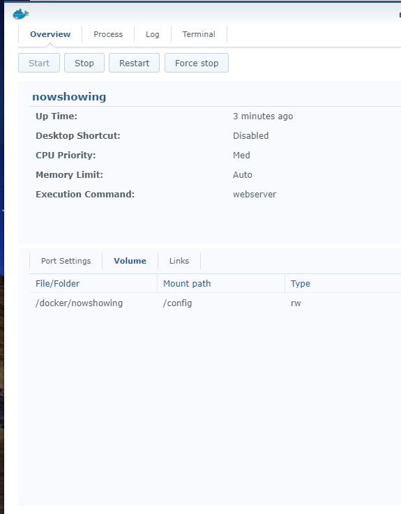

Hi Ninthwalker, i do not want to clog up your github with all my issues.
So far this is how i have my docker set up, everytime i run 'docker exec nowshowing webreport' i get 'configuration file not found,    Exiting...
image.png.6bcd788f1bd2ccdadccee2f196e1dc5c.pngimage.png.46fc8e098d544fb6a161e1912bf99c3a.pngimage.png.0aabd233721eae5063029b50f39cc5ca.png
The docker appears to work pretty good at picking up new movies and new seasons. But it seems to not work on new episodes. Is this something that will be coming in the future or is this something that is broken?

I'm not sure how much more I can help you. I have never set up a docker environment in Synology. I have experience with normal docker on Linux and unRAID. I know someone else has it working in Synology, so maybe he can help you more. Sorry.
(Although in your environment variables screenshot above, you don't have any of them defined, unless you deleted them all for the screenshot. Also, sometimes depending how the docker environment is setup they may need quotes around them and other times not.)
