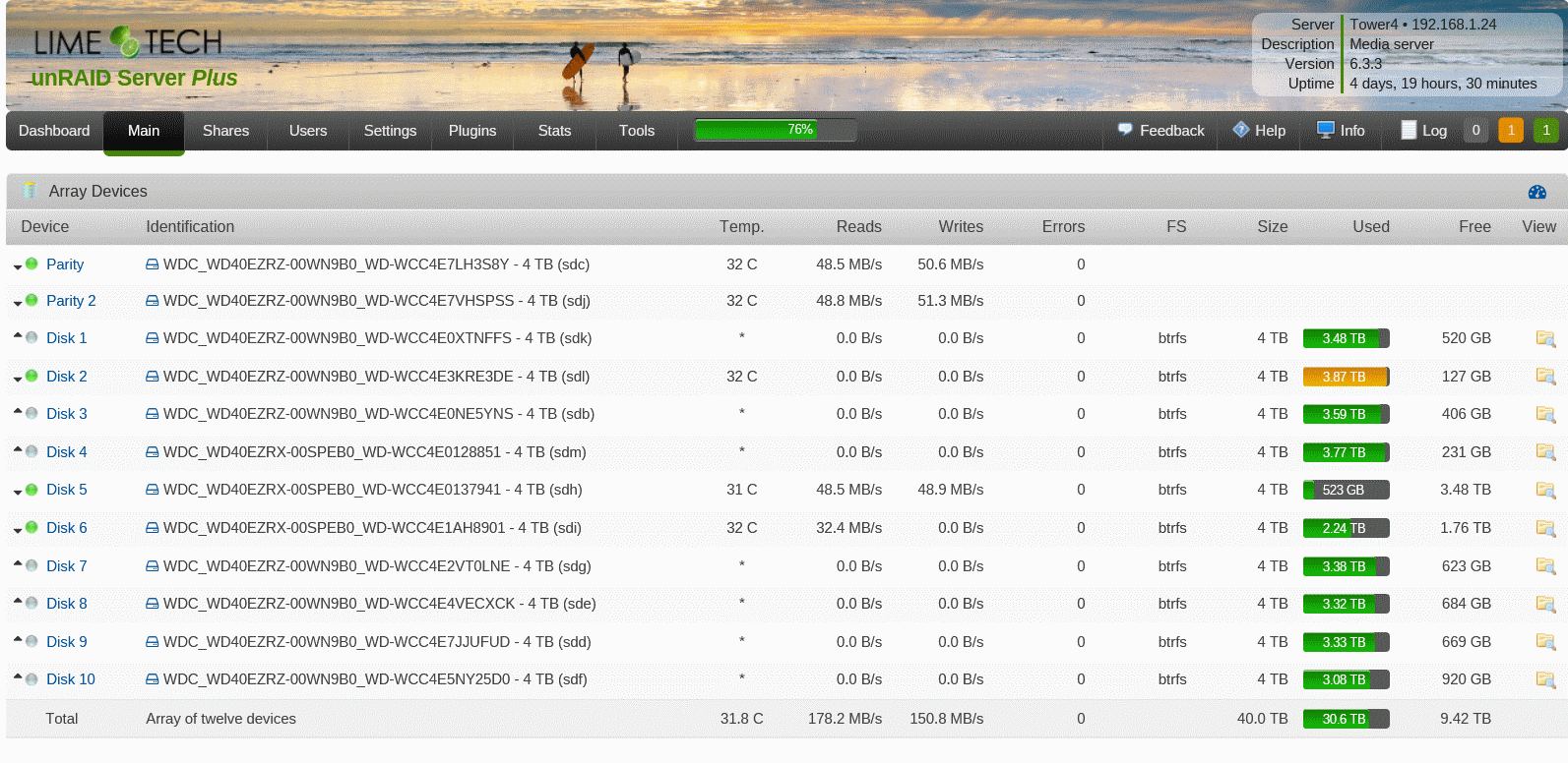

And you can say 100% that spinning up and down of single drives in an BTRFS formatted array will work? I like the filesystem.
Yes, I use btrfs in all my servers.
Example:

very nice! thx for info and the screen that says all ;)

Off topic: Jonnie - which plugin gives you write/read speeds like that?
Sent from my Nexus 5X using Tapatalk
There's a toggle button (looks like a little speedometer) just below the notifications visible on the screenshot, v6.3 only.
