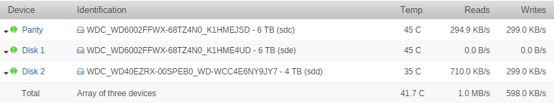

Is 45 degrees Celsius too hot for my disks?
Is 45 degrees Celsius too hot for my disks? When my case is closed, the disks are sitting at 45c.  If I open the case and put a floor fan on them, they drop to around 32c.

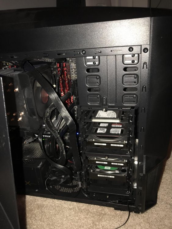

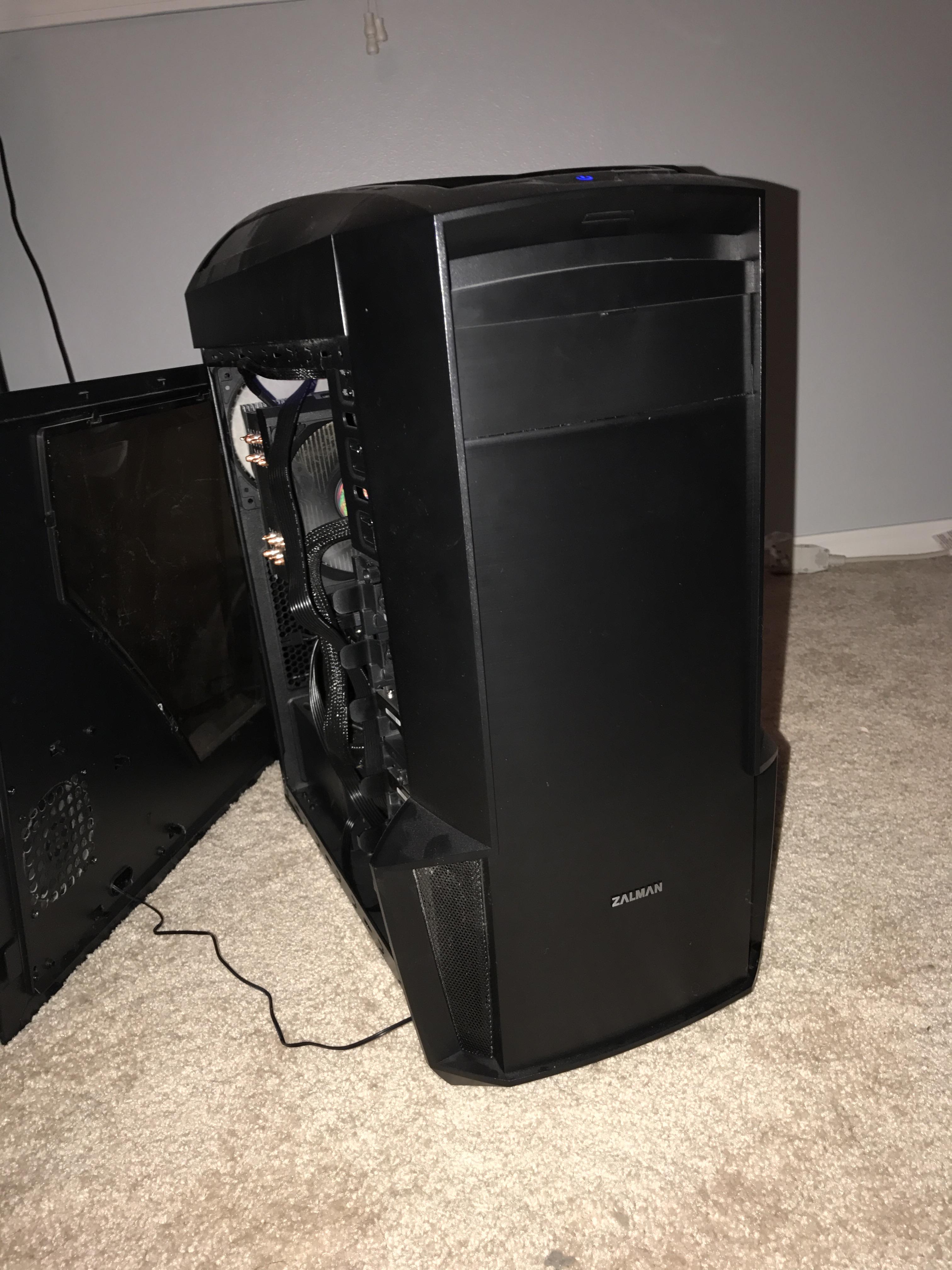

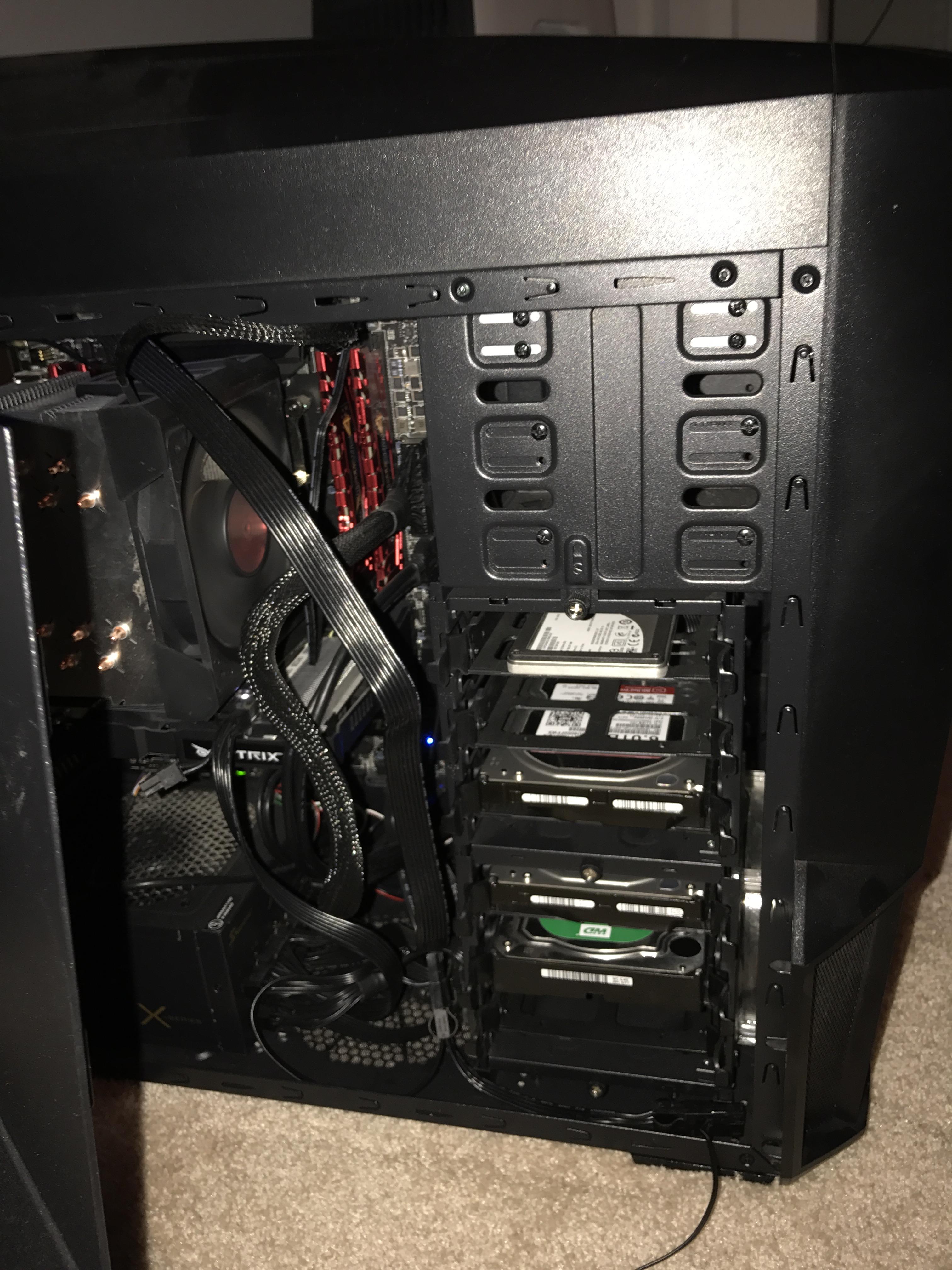

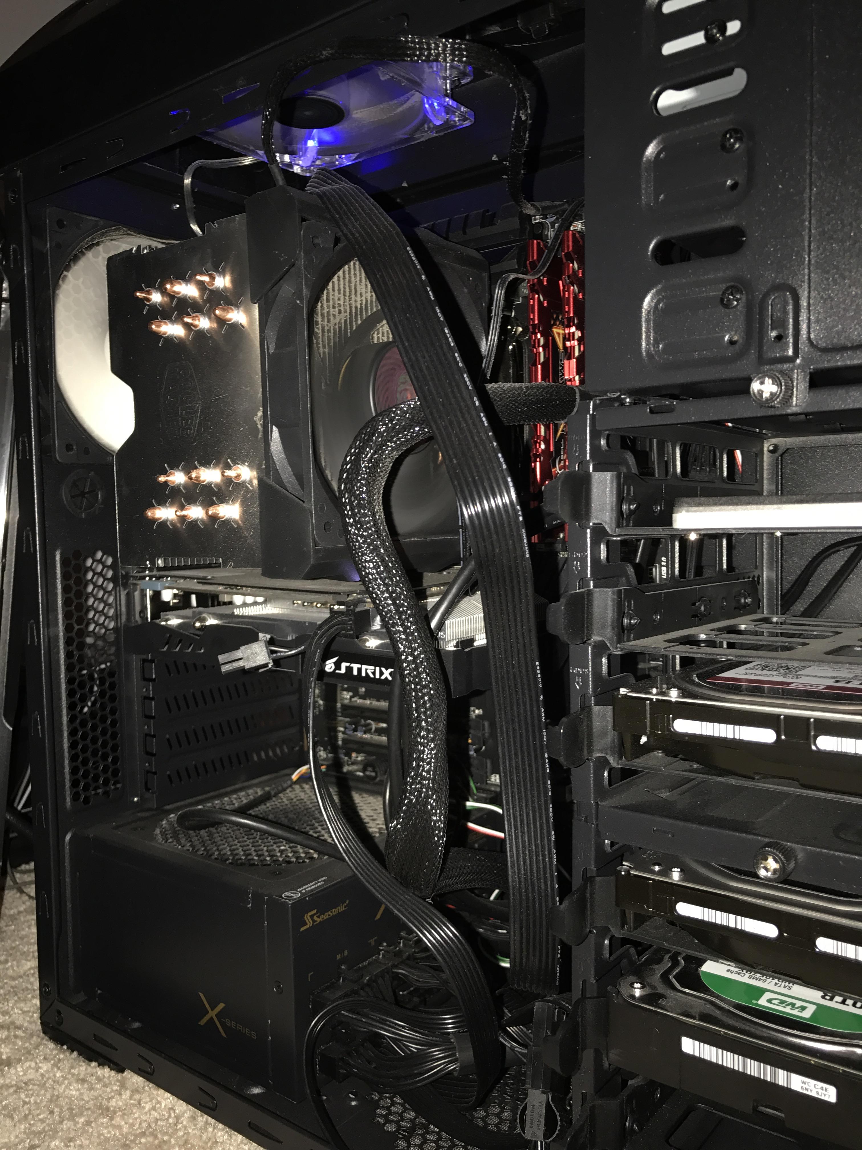

It's not immediately fatal, but it's probably a little uncomfortable long term. Are you sure your case fans are oriented correctly? Many cases are designed for only one drive, and the fans are set to circulate air across the motherboard and video card instead of forcing air across the drives. All case openings other than directly in front of a fan or the drives should be sealed shut, and all fans behind the drives should be pushing air out, so as to force all fresh incoming air to flow across the drives first. If you want help with your fan layout, post a picture of your case with the side off, showing a clear view of as many of the fans and drives as possible. Some cases need help with airflow, cardboard baffles to force the air where you need it may be helpful.
That case should have a couple of fans installed in the front to blow cool air onto those drives, plus you can probably install one on the inside of that side panel.
I'd recommend something like this, but choose the size right for your case.
https://www.amazon.com/Corsair-Air-AF140-Quiet-Single/dp/B007RESGGC/ref=pd_sim_147_1?_encoding=UTF8&pd_rd_i=B007RESGGC&pd_rd_r=T9J0P3VJPABPW5NW0E1A&pd_rd_w=X8zNi&pd_rd_wg=7I4Dx&psc=1&refRID=T9J0P3VJPABPW5NW0E1A
AND get a can of compressed air and blow the dust off your cpu cooler and psu.
Are the fans in the top and back both blowing out and the two side door fans beside the drives blowing in?
I'd take some clear packing tape and seal all the punched holes in the slot covers and the area above it, and any other vacant fan openings to keep air from leaking back into the case. Air will follow the path of least resistance, you need to force all the incoming air to flow over the drives.
Thanks @jonathanm @kizer @1812 @ashman70
I've added new fans, cleaned out the dust, and i'm running at an average of 36C now with the sides on the case.
That is a comfortable temp, good job.
