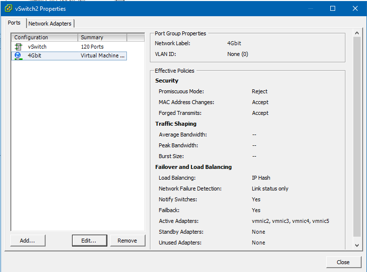

i have 4port Intel Gigabit Nic attached to ESXi, and all 4 ports are in one vSwitch - with this you can't get more than Gbit from one connection but up to 4 Gbit connections to your VMs attached to this vswitch. every VM have a virtual 10G adapter
to do so, you need to create new virtual switch on ESXi and add all nics to it, see picture.
to get this available to all other devices on LAN, you need to bound these all 4 ports on your physical switch too. i have HP 1810-24G v2 and it works just fine.

Basically what I'm trying to accomplish is bonding the two physical 10Gb NICs I have attached to the ESXi host running my UnRAID VM inside the VM itself.  Those NICs are bonded via LACP to my vDS in vCenter.  The issue is that when I add two vNICs so the UnRAID VM and try to bond them within the UnRAID WebUI, I lose connectivity until I remove the bonding configuration from the flash drive.

i'm not sure ESXi supports your 20Gb connection in such way you want.. when i made my config some years ago, i read that with ESXi you can't double speed but you can use it in parallel(not sure if something is changed to this on ESXi side)
