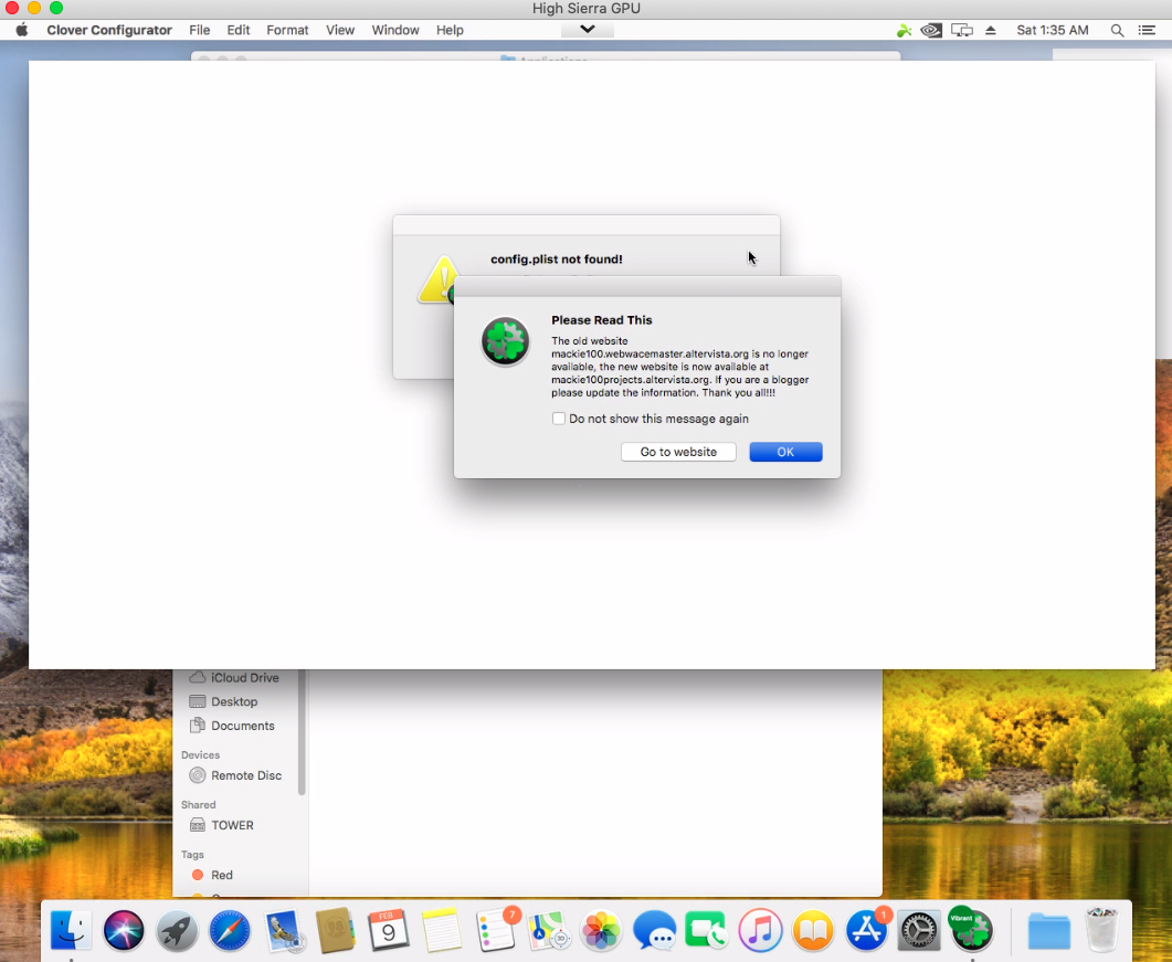

In this case, did he trash the newer version of Clover and install this later version and walk through the rest of the install followed in the video you posted?
When I try to open the Clover app after moving it to applications folder, it says that the 'old website' is not valid and wants to direct me to the clover site. What do I do in this case? And might there be another fix for this laggyness?
Thank you very much for your help!
[Attached is the link I am getting after clicking on the Clover after moving it in the applications folder. Also note, the screens are white and only appear after moving mouse over or am active in the window, makes it very hard to navigate in the window and hard to do anything.]
