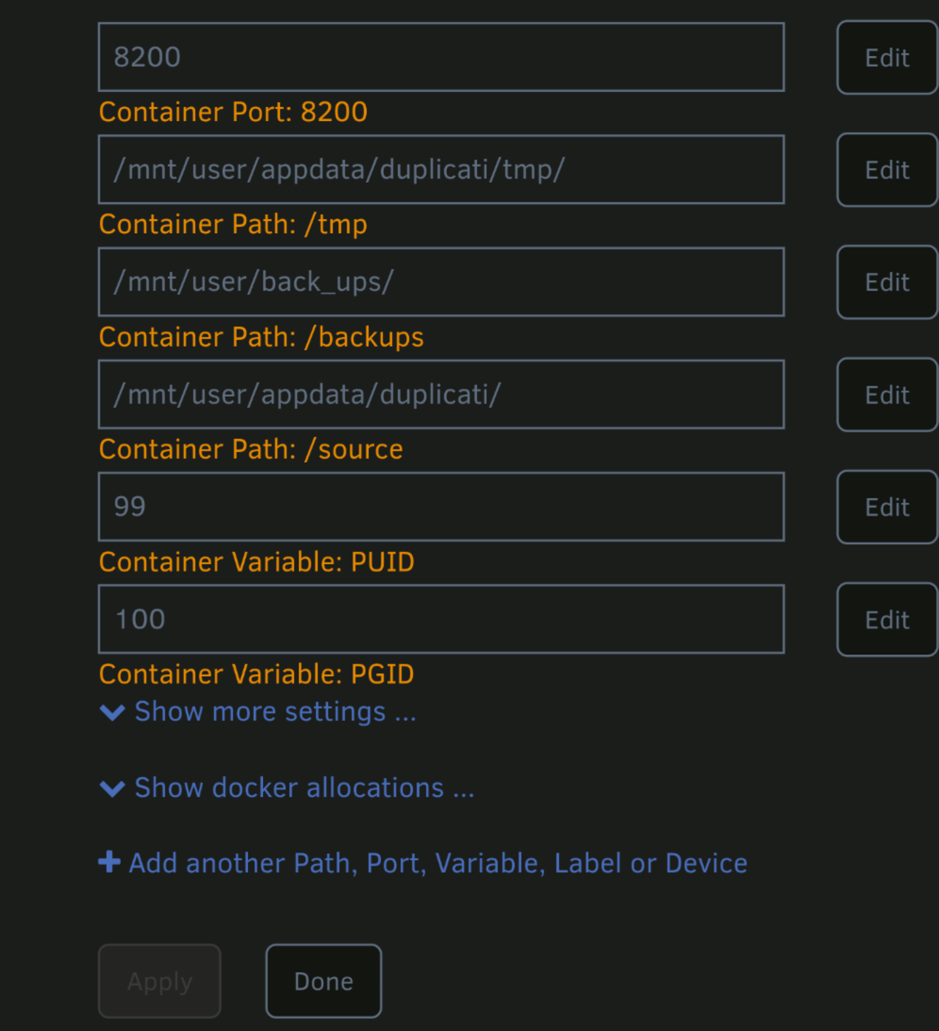

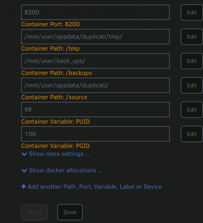

On 1/24/2020 at 6:05 PM, Fiservedpi said:
Could not find file "/tmp/dup-5e8a0a15-dc8a-xxxx-xxxx-6f563" (Could not find file "/tmp/dup-5e8a0axxx-xxxxx-6f563") (One or more errors occurred. (The remote server returned an error: (403) Forbidden.))) ---> System.AggregateException: Could not find file "/tmp/dup-xxxx-xxxx-474d-9557-xxxx563" (Could not find file "/tmp/dup-5e8axxxx-xxxx-b6fad0d6f563") (One or more errors occurred.
Trying to run my first backup but getting this error at the end. Can't complete A back up
How is your temp dir mapped?

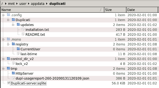

webgui for this docker just stopped working. any changes recently? anything I should be looking for to start?
Same here, webgui has been giving http error 400 for a while now, maybe a couple weeks. No errors in log, though it looks pretty empty.
Since my backups weren't working anyway, I deleted everything in appdata/duplicati, and forced an update, to no effect.
Below is from after deleting. Attached log, and the files that were created by it starting up. Log almost exactly identical to before deleting.

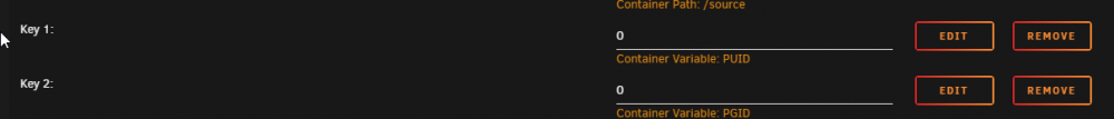

8 minutes ago, mwells said:
I'm having the same issue.  Is there a fix for this?
Change both PUID and PGID to 0 in the settings for the container.
This did the trick, thanks so much!

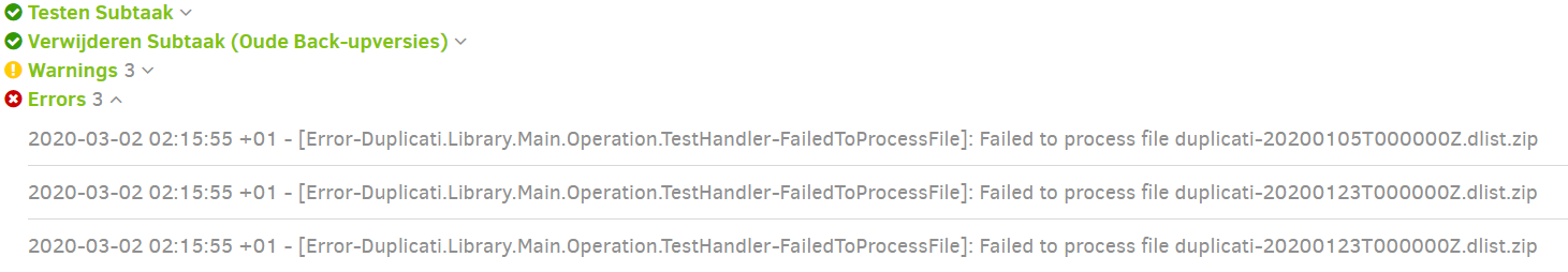

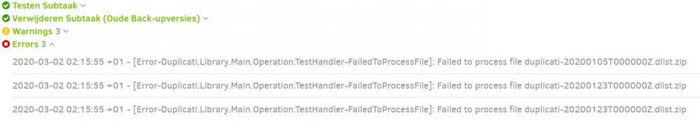

Hi Guys,
I have from the beginnen of installing Duplicati 2 or 3 errors after maken a backup to a local drive and to my Dropbox cloud. I already enabled no-local-blocks option under the main settings but that will not fix my errors. I also tried to remove duplicati end reinstall it but still again errors. I dont understand what the errors means.
Hopefully someone can help me with this.
