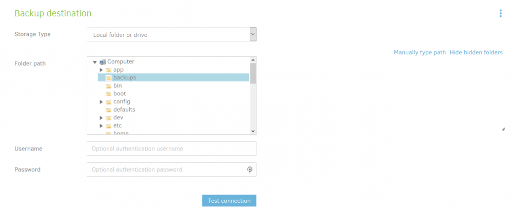

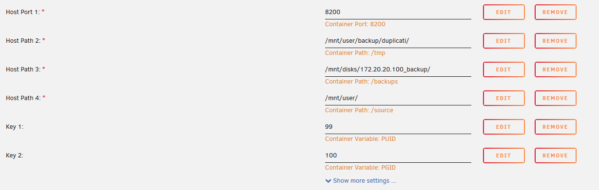

I get "duplicati Access to the path "/mnt/user" is denied." when I am trying to restore :(
What am I missing on permissions?
How is duplicati getting access to /mnt/user? Normally that wouldn't be mapped.
Thanks partner.  No it wasn't mapped.  I had to play with the path for source in settings and that fix it.  I switched to /mnt/ and it works now.   I never understand the file permission stuff.

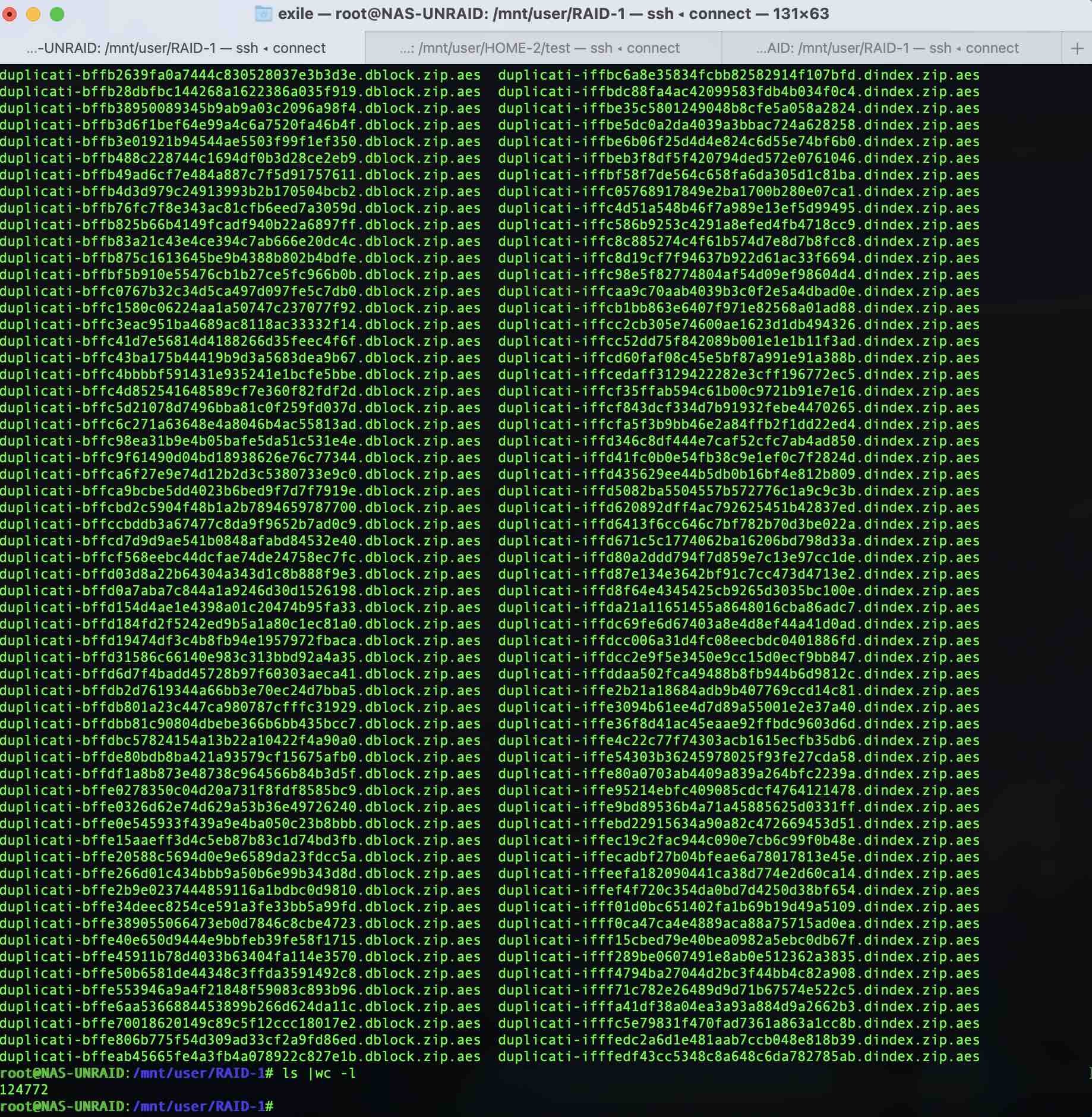

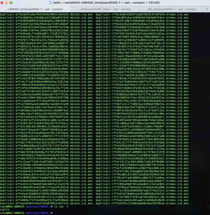

Why is duplicati creating and storing these files in the directory I am trying to backup?  I left it running for like 2 weeks while I was vacationing in Mexico and when I got back the drive was full.  WTF?
Those are the encrypted chunks that constitute your backup. Are you sure you setup the right destination for your backup?
Sent from my SM-N960W using Tapatalk
Yes I am sure, the destination was right, to cloud.  Perhaps it creates a local copy before it uploads it and the upload speed couldn't keep up with the local copy? I was backing up about 5TB and the drive is 8TB. It was full in 2 weeks while I was out traveling :(

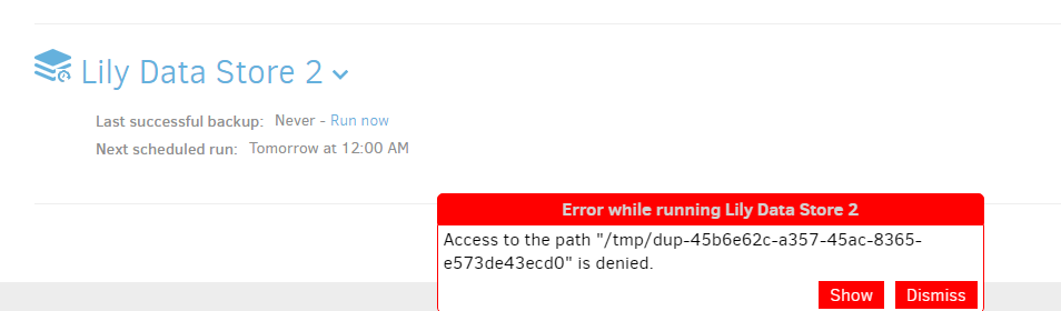

I am getting the following error over and over. I have tried restoring the container by re-downloading it but it does not seem to fix the issue.
I am not sure how long this has been going on for but it stops the container properly launching. Any ideas?
A serious error occurred in Duplicati: System.UnauthorizedAccessException: Access to the path "/tmp/HttpServer" is denied.
at System.IO.Directory.CreateDirectoriesInternal (System.String path) [0x0005e] in <254335e8c4aa42e3923a8ba0d5ce8650>:0
at System.IO.Directory.CreateDirectory (System.String path) [0x0008f] in <254335e8c4aa42e3923a8ba0d5ce8650>:0
at HttpServer.HttpServer.Init () [0x0010a] in <bed89f1655ee48029f6d6812f54c58ad>:0
at HttpServer.HttpServer.Start (System.Net.IPAddress address, System.Int32 port) [0x00026] in <bed89f1655ee48029f6d6812f54c58ad>:0
at Duplicati.Server.WebServer.Server..ctor (System.Collections.Generic.IDictionary`2[TKey,TValue] options) [0x00215] in <c5f097a49c0a4f1fb0f93cf3f5f218b1>:0
at Duplicati.Server.Program.StartWebServer (System.Collections.Generic.Dictionary`2[TKey,TValue] commandlineOptions) [0x00000] in <c5f097a49c0a4f1fb0f93cf3f5f218b1>:0
at Duplicati.Server.Program.RealMain (System.String[] _args) [0x00227] in <c5f097a49c0a4f1fb0f93cf3f5f218b1>:0

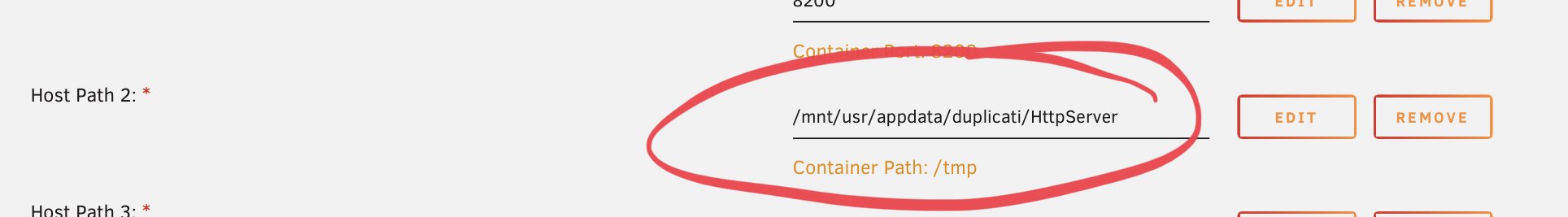

I have managed to fix this with the following that i found on the duplicati forum from 2018

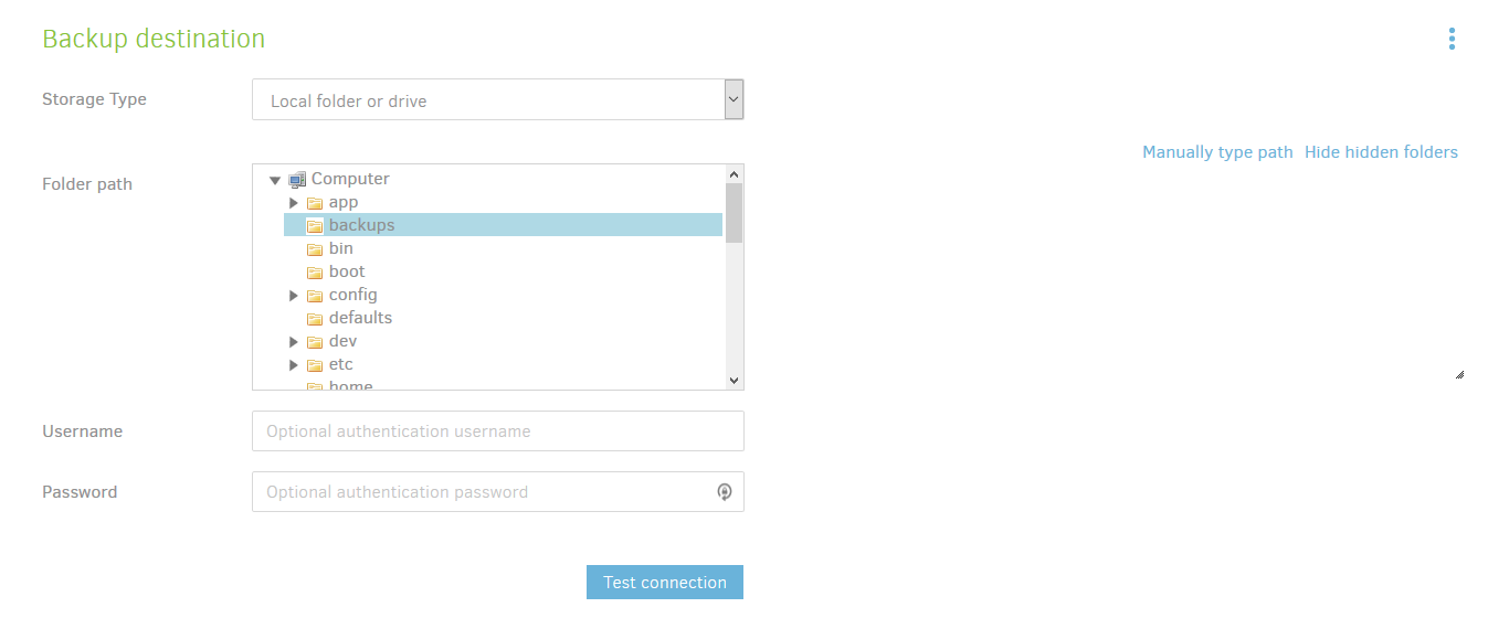

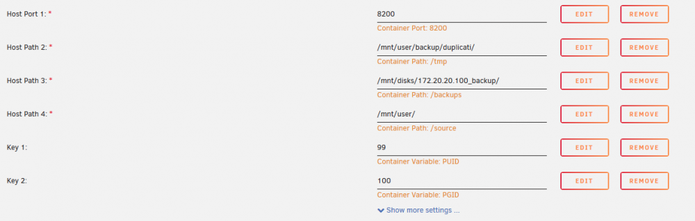

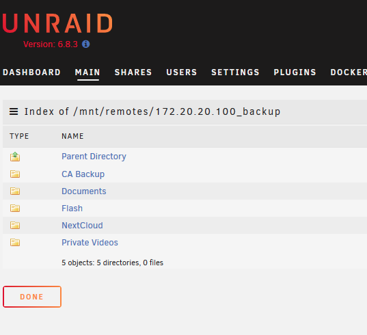

Has something changed in the last update? My local backups run to a Network NAS (it is very old granted) which can no longer be accessed in duplicati. unRAID can see the NAS and it is mounted and can be accessed:
It is configured and the docker has not been edited since i created it (a few years ago):
However the destination is not accessible any more in duplicati:
Any ideas guys?
EDIT - Figured it out. It seems the mounted share is now in /remotes and not /disks. I changed the docker setting and it's now working again.

This doesn't seem to work for me, I getting HTTP ERROR 400 while open the webui? Do I have to change anything with the default template?
after resolving the missing httpserver folder error, the latest update broke it again and i had to update my template to remove that fix, that gained me access to the GUI however I am now getting the following error.
