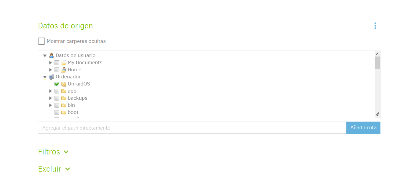

I get this error they I try to backup unraid OS USB
2021-02-15 19:12:31 +01 - [Warning-Duplicati.Library.Main.Operation.Backup.FileEnumerationProcess-FileAccessError]: Error reported while accessing file: /UnraidOS/
How Can I fix it?
How Can I fix it?
imagen.thumb.png.639dea80c31ed70b2c1cc67801055714.pngimagen.png.6dc40306586e8817cd02a4f51acc0ff5.png
Can someone help me with this please?

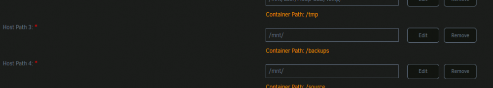

Hi every1, Duplicati have been workign like a charm for me till 20 of march.
now i get an Error  Disk full. Path /tmp/dup-b on all of my backups.
Dr. Google said i should clean up the tmp folder...but it is clean i have no files there. or am i in a wrong /tmp folder?
i checked in root /tmp
this settings i am using for backups
any ideas what i am missing?
SOLUTION:
found a solution myself. changed in the web ui in Settings/Advanced tempdir command to a different location. Seems to work for now.

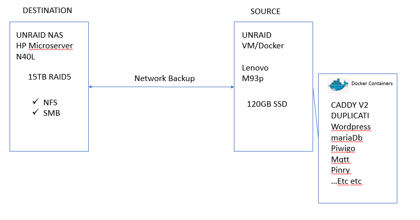

Hi there, I'm trying to backup my docker containers from one Unraid server to another. but i can't seem to configure this at all in duplicati. i guess i'm just trying to get a concrete answer. can Duplicati backup to a remote destination via SMB or NSF? I've got the UNRAID NAS mounted through unassigned drives & unassigned drives plus. but you cannot navigate to this location in duplicati.
please see my crude drawing and example.
I fixed it..
i was being too specific with my container locations. if i use /mnt/ i can navigate to /mnt/remotes/ etc... so i can choose this location.

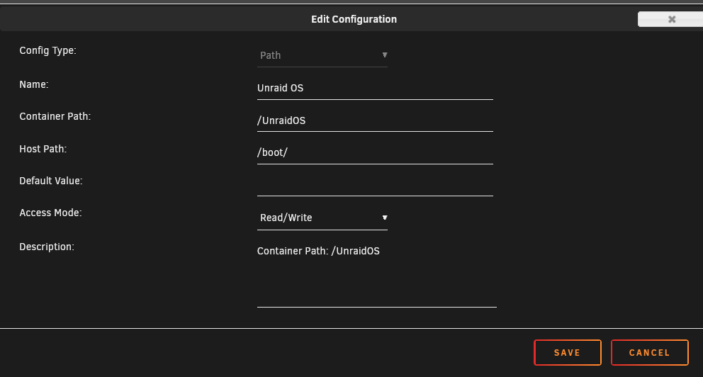

How Can I fix it?
Can someone help me with this? how can I backup UnraidOS USB (/boot)?
Set both "Container Variable: PUID" and "Container Variable: PGID" to 0
