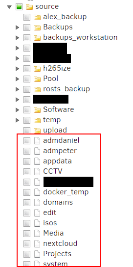

Hey there,
I've got a problem with my duplicati configuration.
Since I've changed my cache pool to ZFS duplicati can't backup the folders which are stored on chache. In the backup configuration window it looks like this:
The folders in the red box are not shown as folders and the backups can't run.
Any ideas?

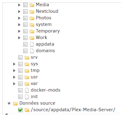

Hello,
I have a similar problem although I don't use ZFS. All my shares use XFS.
As far as I can tell I think that all the shares that use the old "cache only" can't see any subfolders.
For information I'm using the new 6.12 feature "exclusive shares" for my appdata share and domain for my VM.
My appdata is set as /mnt/user/appdata/
The others shares using the cache as primary storage and with the secondary's one as array can dispaly the subfolder.
As you can see I was once able to see these subfolder and my backup routine was running fine although I have set it long time ago (unraid 6.9)
Now my backup are broken as I have this error :
System.IO.IOException: Backup aborted since the source path /source/appdata/Plex-Media-Server/ does not exist. Please verify that the source path exists, or remove the source path from the backup configuration, or set the allow-missing-source option.
Any guess ?

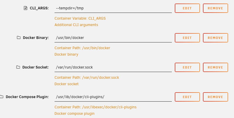

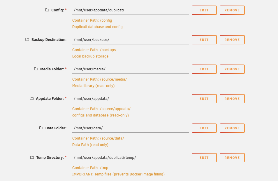

I have setup Duplicati in a test environment (simulated files on temporary cache drive fodler) as following and each time I try to run a backup I get the same error messages:
  "MessagesActualLength": 3,
  "WarningsActualLength": 0,
  "ErrorsActualLength": 2,
  "Messages": [
    "2024-06-14 22:13:16 +03 - [Information-Duplicati.Library.Main.Controller-StartingOperation]: The operation Backup has started",
    "2024-06-14 22:13:16 +03 - [Information-Duplicati.Library.Main.BasicResults-BackendEvent]: Backend event: List - Started:  ()",
    "2024-06-14 22:13:16 +03 - [Information-Duplicati.Library.Main.BasicResults-BackendEvent]: Backend event: List - Completed:  ()"
  "Warnings": [],
  "Errors": [
    "2024-06-14 22:13:16 +03 - [Error-Duplicati.Library.Main.Operation.BackupHandler-FatalError]: Fatal error\nFileNotFoundException: Could not find file \"\"",
    "2024-06-14 22:13:16 +03 - [Error-Duplicati.Library.Main.Controller-FailedOperation]: The operation Backup has failed with error: Could not find file \"\"\nFileNotFoundException: Could not find file \"\""
/usr/local/emhttp/plugins/dynamix.docker.manager/scripts/docker create --name='duplicati' --net='bridge' --cpuset-cpus='1,2,15,16' -e HOST_OS="Unraid" -e HOST_HOSTNAME="Tower" -e HOST_CONTAINERNAME="duplicati" -e 'CLI_ARGS'='' -e 'PUID'='99' -e 'PGID'='100' -e 'UMASK'='022' -l net.unraid.docker.managed=dockerman -l net.unraid.docker.webui='http://[IP]:[PORT:8200]' -l net.unraid.docker.icon='https://raw.githubusercontent.com/linuxserver/docker-templates/master/linuxserver.io/img/duplicati-logo.png' -p '8200:8200/tcp' -v '/mnt/cache/temp/duplicati_destination/':'/backups':'rw' -v '/mnt/cache/temp/Noga'\''s Documents/':'/source':'rw' -v '/mnt/cache/temp/duplicati_tmp':'/tmp':'rw' -v '/mnt/cache/unRAID_Apps/Docker/appdata/duplicati':'/config':'rw' 'linuxserver/duplicati'
I added the tmp path (although it ins' in the template) but fails with and without it.
When doing a cp from the docker console from /source to /backups it works - so no permissions problem.
What could be the problem?

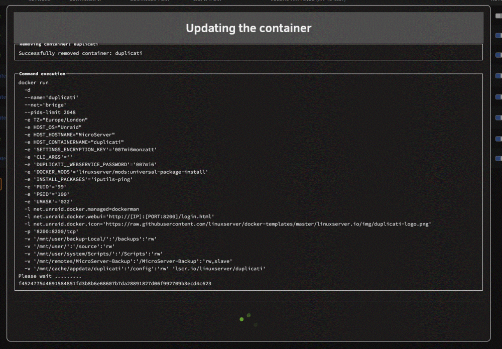

started duplicati today and now i need to enter a password to connect again. I never set a password or something. It worked for years without. Is ther posibillity to remove that without deleting an reinstaling everything?
THX
Same problem as above with request for Sign In
THX
Try "changeme"
Or add variable key DUPLICATI__WEBSERVICE_PASSWORD to template and try setting your wanted password there.
Edited by Niklas

Just installed duplicati and during the first backup, it filled up my array drive. TLDR, it appears to be writing data to the system share, even though nothing is mapped to that folder within the config. To clarify, the backup and source folders are not on the array; only the appdata/duplicati folder is. I'm guessing it's doing some type of a temp folder into system before copying the data over to the backup folder I've specified. anyone else seeing this, and what was the fix?
