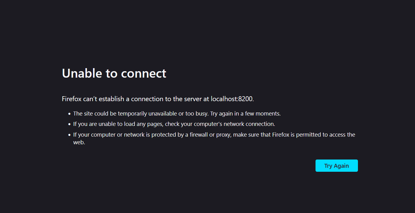

I tried the URLs in the log and they would not give access. This is what I got.

  • Same problem here. Temporary solution that I came up with is to edit the docker settings and change repository to an older version: "linuxserver/duplicati:v2.0.4.23-2.0.4.23_beta_2019-07-14-ls27"
  • Not sure if this is the issue you're having but it has to do with existing session data at least in the x64 version of Duplicati.   When in the web UI, for Chrome, right click "inspect" go t
replace localhost with the correct IP for Duplicati...
That works but it is telling me the token has expired? and will not let me in.
monarc, restarted the container and then used the new URL and it worked.
THANK YOU!

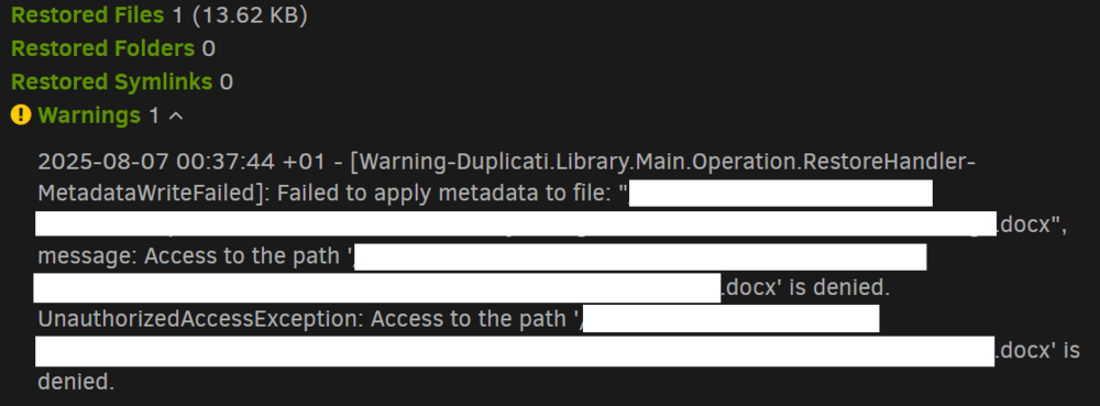

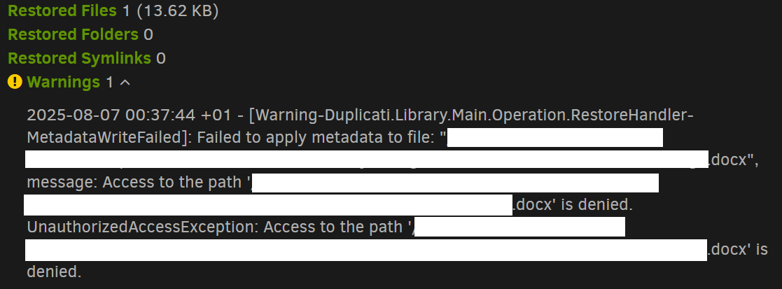

Hi Guys
I am new to Duplicati and have just set it up to create regular backups of my shares onto an 8Tb USB disk - I have backed all the shares up and it worked great - total space used for all my backups is about 2.6Tb.
I then opened a backed up Word file and changed the date in it, then re-ran the backup. I then tried to restore the original backed up file, so it would restore the file with the original date in the file. The restore worked and the file was restored in place of the amended file.
However I got an error...
Despite this error saying access is denied, the file has been restored to the original, so this is great. However I noticed that the restored file is timestamped with the time of the restore - which is obviously not correct.
So, in destination -> options I populated the user/password with my user who has read/write permissions and re-ran the restore and it said restored with no errors... so I assume the error message above is because the share is set to Private - but I am not sure how it restored the file if access was denied... and I really want to make sure that any files I restore are restored with the original timestamp as this change will upset other programs which access the data.
Can anyone advise?
But, on the face of it, much better than my old manual backups using Areca Backup on a USB drive from a VM - so thanks :)
Edit [SOLVED] - I deleted the file with the wrong timestamp from my share and restored the file again and this time it ran seamlessly and restored the correct time stamp... so, perhaps, if there is a file there already which is being overwritten it uses the restore timestamp rather than the original timestamp?!?! Either way, it seems perfect now.

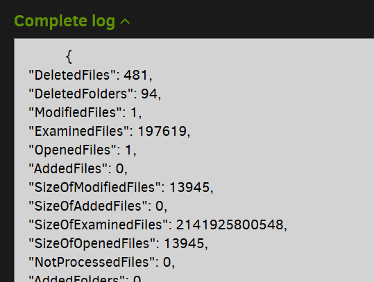

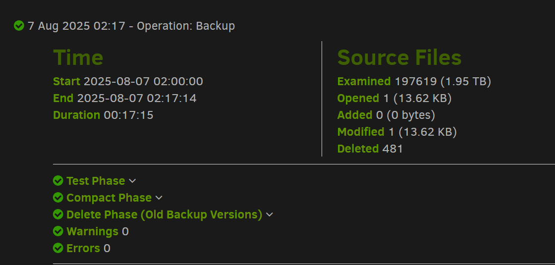

HELP - Files Deleted?!?!?!
Hi all,
As above I am very new to Duplicati, so am still learning my way round... but am very concerned because I just checked the logs on last nights automated backup and it says that it has deleted 481 files and 94 folders!!!
I haven't deleted any files so am very concerned what has been deleted, this is the log;
Can anyone advise if this is me mis-interpreting the log - or has Duplicati just deleted a whole lot of my files from my backup source?
Is there a way to see what has been "deleted"?
Since my initial test backup, I have ticked the "Exclude Hidden Files", "Exclude System Files" & "Exclude Temporary Files"... so I was wondering if it has deleted any of these files which were included on my initial backup?
Thanks in advance
Edited by SliMat

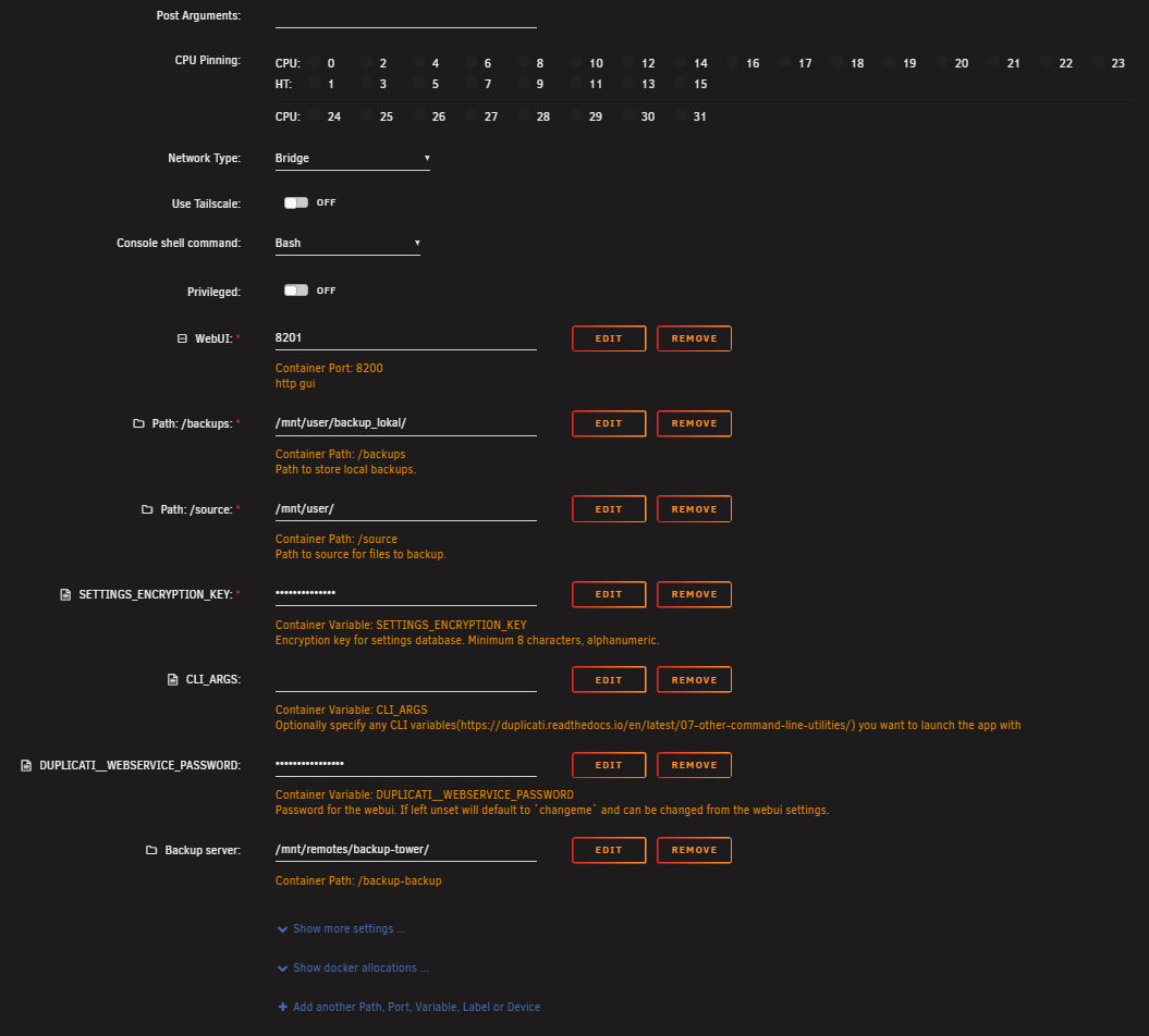

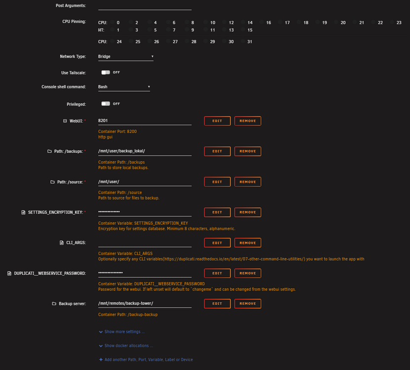

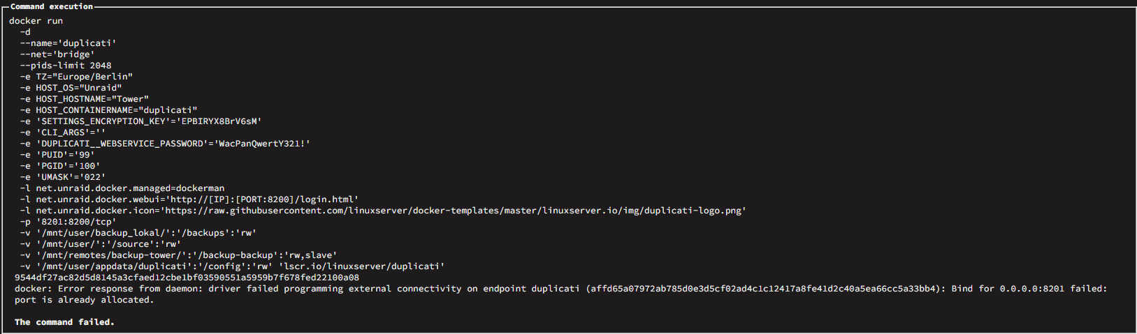

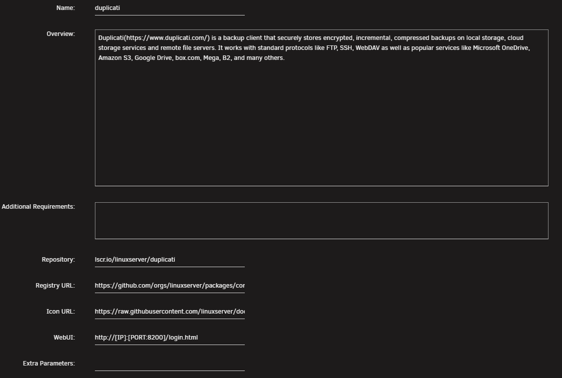

Hello,
I've installed Duplicati but I found a problem..
If im restarting Duplicati I cannot access it anymore. This is the error im getting.
It says that my port is already allocated. It's only Duplicati that uses it.
I have to change the port between 8200 and 8201 each and everytime i start it.
Does anyone have a clue why?
This is my template:
image.pngtower-diagnostics-20251013-1055.zip

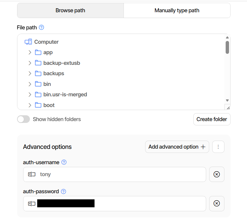

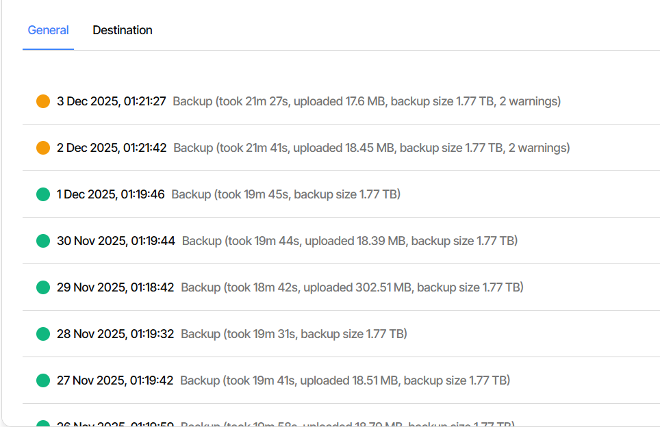

Hi Guys
Duplicati has been running fine for months, but a couple of days ago I updated from the UnRAID docker page and ever since then I get warnings...
When I check the logs it shows;
"2025-12-03 01:00:00 +00 - [Warning-Duplicati.Library.Main.Controller-UnsupportedOption]: The supplied option --auth-username is not supported and will be ignored"
I seem to remember when I set it up, it couldnt access my source share because of username / password required... so I set authorisation;
It looks like this feature has been depracted... can anyone advise how to fix this?
Thanks

OK, as there was no reply to my above query, i removed the username and password from the settings above and tonight got this error...
  • 2025-12-09 01:00:44 +00 - [Error-Duplicati.Library.Main.Controller-FailedOperation]: The operation Backup has failed RemoteListVerificationException: Found 68780 files that are missing from the remote storage, please run repair
Can anyone offer any advice why this has broken in the latest release??
Is there a way to roll back to the previous version of Dullicati to get things working again if this option has been removed in the latest version?
Thanks

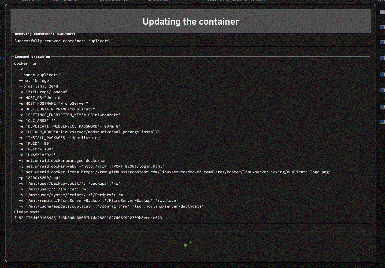

I now have Duplicati running nicely, with a script checking destination drive is alive...🙂
The problem I have now is when updating Duplicati from the Docker Tab, the container fails to restart hanging at this line.
I can not do anything other than close the UNRAID window, re-open UNRAID and select restart. I need to do this two times before Duplicati is running again. I do not need to do anything else just restart UNRAID two times
Can anyone tell me what is likely wrong?
Everything is normal to this point where it just says wait!
Thanks
