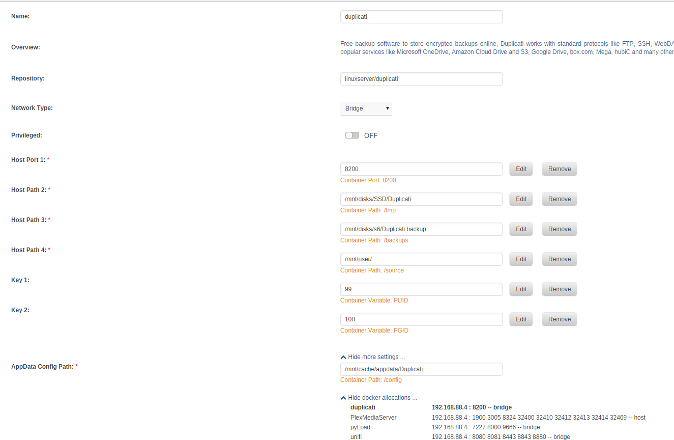

Here is the Docker settings for Duplicati.
Is it wrong to have /tmp mapped to an Unassigned Device?
And thank you all for your help!
