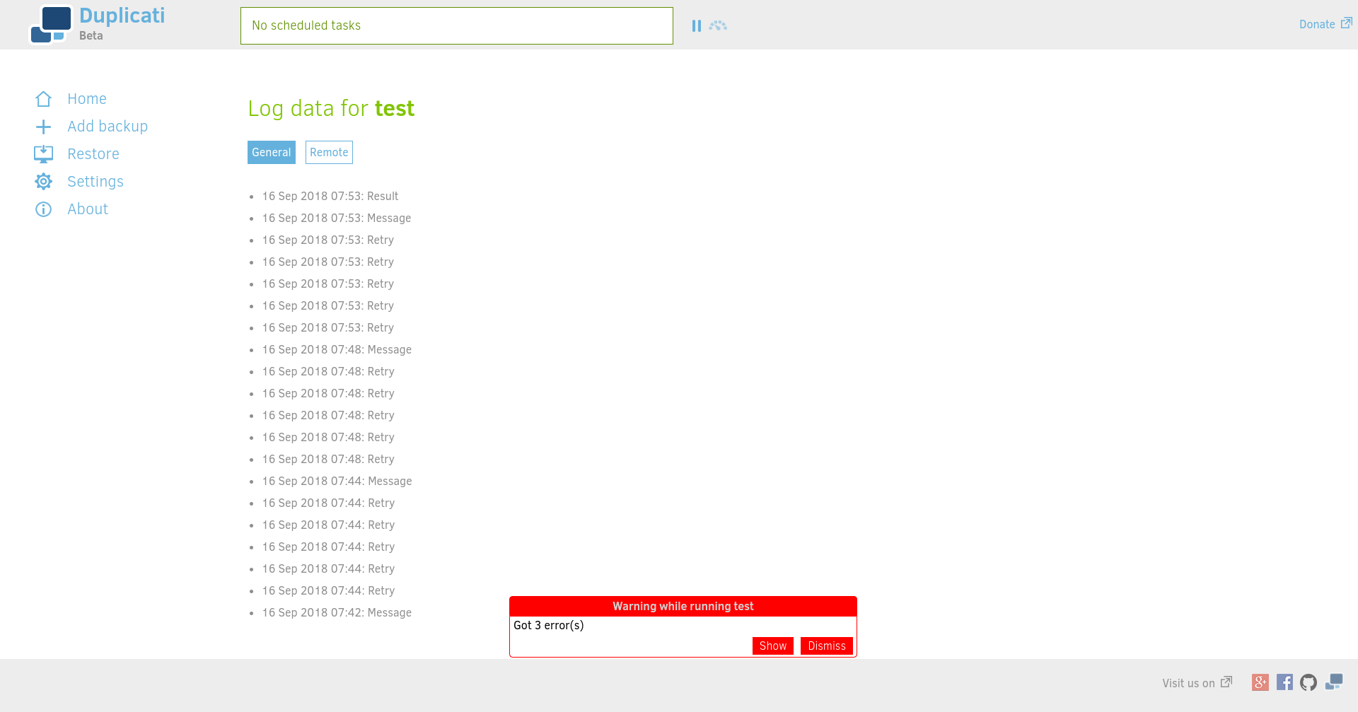

i have setup duplicti to upload to onedrive business
i upload a small 5mb test file and I can see the files go onto the onedrive server.
However, it waits at VERIFYING for ages and i get errors

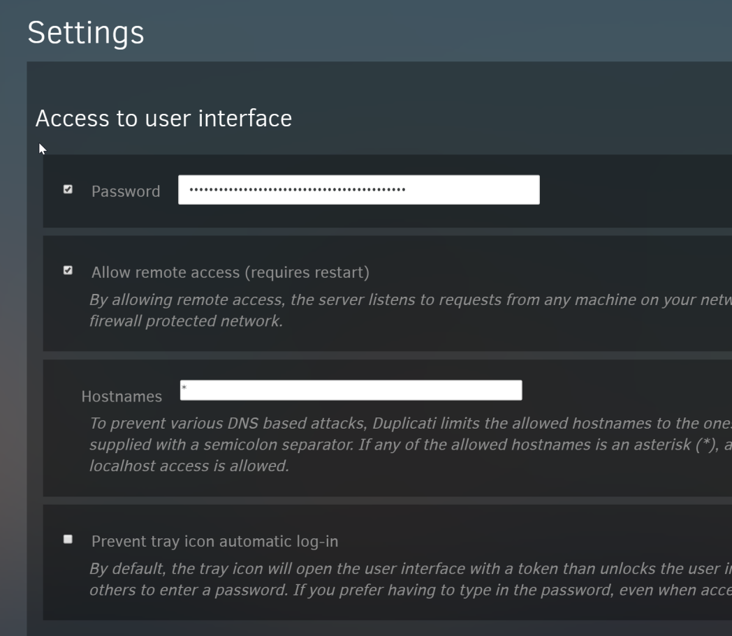

I need access to put an asterisk in the the Hostnames option to make my reverse proxy working again.
What I need looks like this:
But that is only possible if I can visit Duplicati via 127.0.0.1, how do I do that when it is inside this docker container?
This means that as of now I only see this:
To the devs:
You can fix the Reverse Proxy issue by editing the file /etc/services.d/duplicati/run to the following (i.e. adding --webservice-allowed-hostnames=*):
#!/usr/bin/with-contenv bash
cd /app/duplicati || exit
 exec \
    s6-setuidgid abc mono Duplicati.Server.exe \
    --webservice-interface=any --server-datafolder=/config --webservice-allowed-hostnames=*
See https://github.com/linuxserver/docker-duplicati/blob/master/root/etc/services.d/duplicati/run
For now I use a mounted run file with this change.
Edit: The best solution is to make it an environment variable in the docker container.
Edited by JohanSF

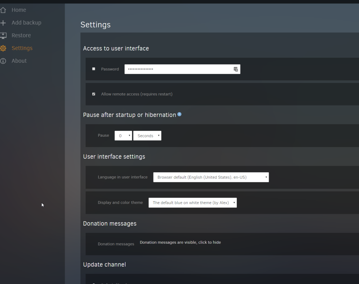

1
I have access and I can't change the Hostnames text box anyway. I put an FQDN in there and it doesn't save it.
