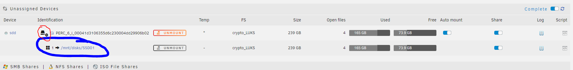

I'm trying to backup to a mounted unassigned device formatted with xfs. I can't seem to find the path to browse to the disk and if I manually enter the path I get an error:  /mnt/disk/ access is denied. Any idea what I'm doing wrong here?
Thanks in advance.
Edited by rpowers
Thanks in advance.
I believe /mnt/disks/nameofdrive
Sent from my Pixel 2 XL using Tapatalk
I manually enter the /mnt/disks/nameofdrive but the error returns Access to the path "/mnt/disks" is denied. I should also say that the first message is a create folder: The folder /mnt/disks/nameofdrive does not exist. Create it now?
Does it work with on the main screen? That's how I did it.
Click where red circle is. It will do a drop down. Then click where the blue is and it will pop up. Also where the blue is what the share name is.
Edited by scubieman
Yes, I can click on that and it will pop up and I can see the folders I have created but when I use that path in duplicati I get the error message.
Last thing before out of options. Can you use Krusader? If so can you navigate to that through there?
No, sorry. Thanks for the help, I'll keep trying.
I'm not sure why I overlooked something so obvious. I mapped the template properly and it's now working. Thanks for the help.
