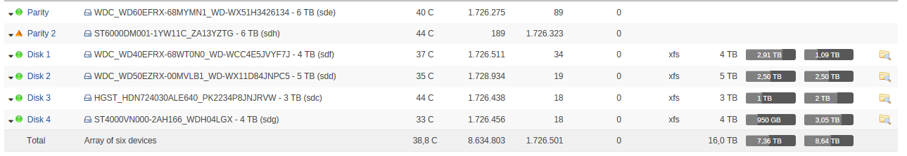

this are my drives now:
I just installed a second 6 TB parity drive. All fine.
At the next step i want to remove the 2 x 4 TB drives and put in another 6 TB drive. How can it be done? You can easily see that my used data is not so much at the moiment. I really don't want to leave this 2 drives into the system. I need them for another build.
